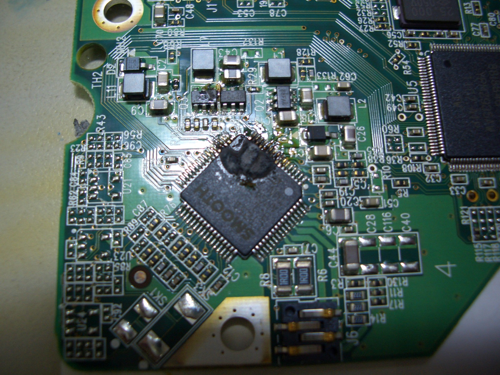

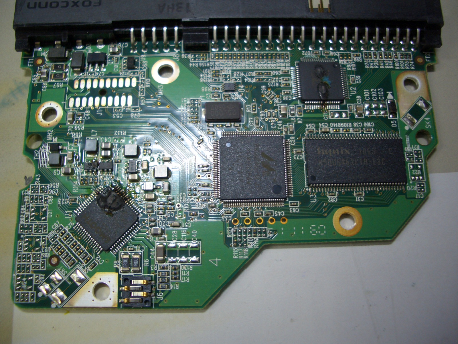

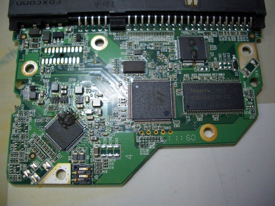

I got WD1600AAJB-00J3A0
DCM:HHNNNT2AGN
DCX:0002JE137
and PCB 3 important chip are burnt.

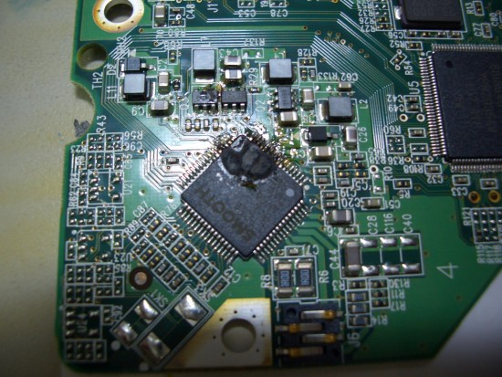

first burnt chip is U1 (i think it's motor controller chip)

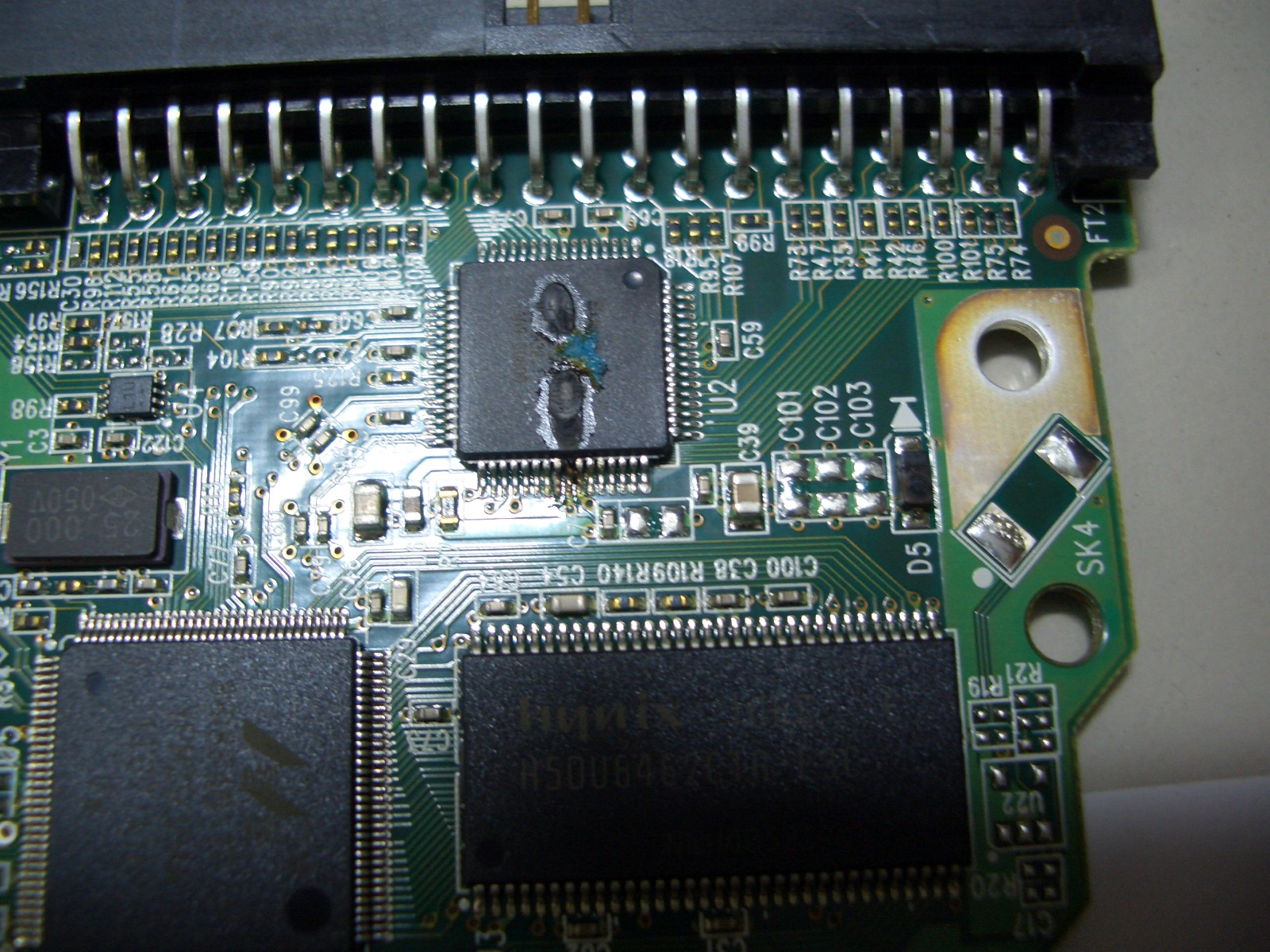

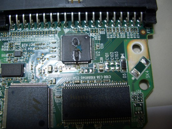

second burnt chip is U2(what function is this chip?. Is it important?)
and third burnt chip is D5(i think it's not important)
please see the pictures.
...Is it possible to recovery data without this burnt chip?
File comment: U2 and D5

File comment: smooth chip

That was a nasty burn...
This is no DIY, there is no ROM chip that you can swap...all the adaptive information is in the big chip marked M
You need to seek out a pro.

Unfortunately (for you) mr_spokk is correct
