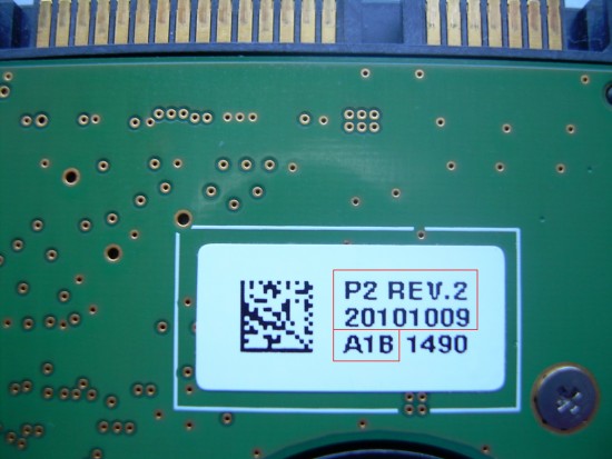

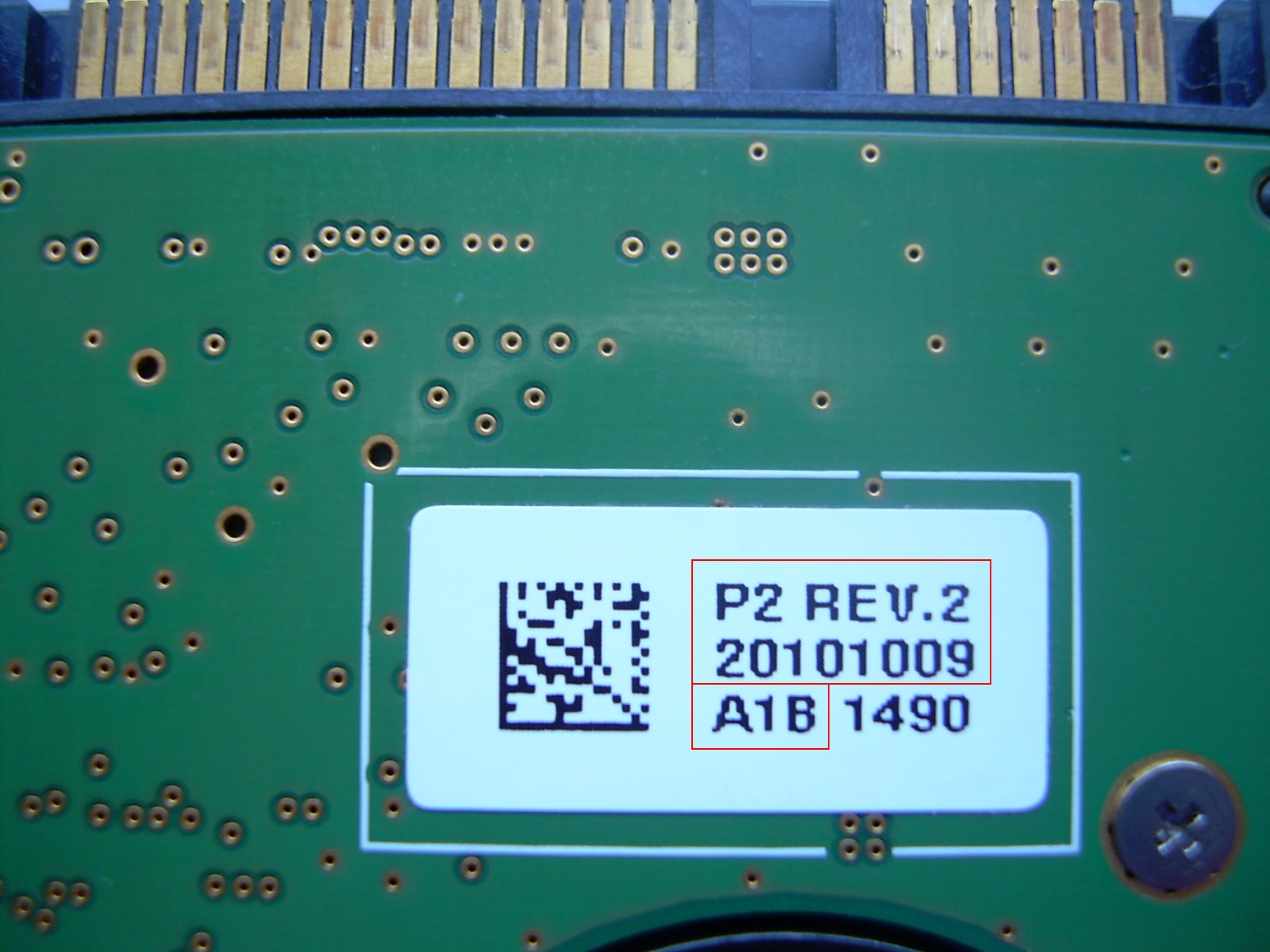

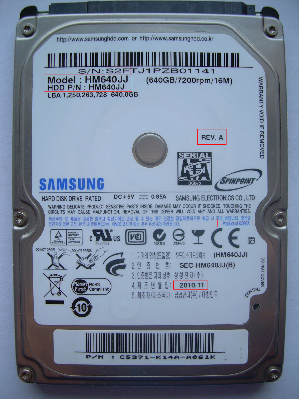

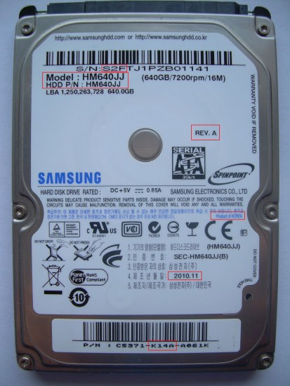

I'm looking for ROM for Samsung HM640JJ.
Details you need to know:
S/N starts with S2F......
Model: HM640JJ
HDD P/N: HM640JJ
Rev. A
Date of Man.: 2010.11
P/N: .....-K14A-.....
Info from bottom side (sticker on PCB):
P2 Rev. 2
20101009
A1B 1490
Please help as it seems the ROM is corrupt.
More questions? Email or PM me.

What makes you think ROM is corrupt?
Are there any errors reported in terminal?

I was told it's because of the ROM. I sent the disk with similar to data recovery company (originaly it wouldn't start at all). After investigation they said it's ROM (after copying ROM from donor to corrupted PCB it worked fine with the donor). However the donor's ROM differs from original so it still doesn't work. That's why I'm asking about ROM image.

Could possibly be similar issue to the 1Tb (HM100UI I believe) versions made about the same date, where the ROM itself appears to be poor quality and degrades.
We have figured a workaround for this particular issue, although it might not be applicable in your case but there's a fair chance.
Looking for a particular ROM version for these drives is like looking for a needle in a haystack in any case. Except in your case you don't know which haystack it might be in, and it might not necessarily be a needle you're looking for!
