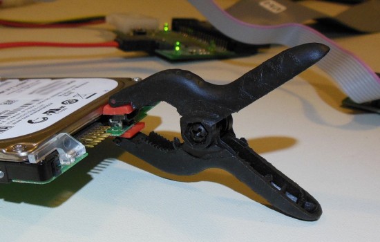

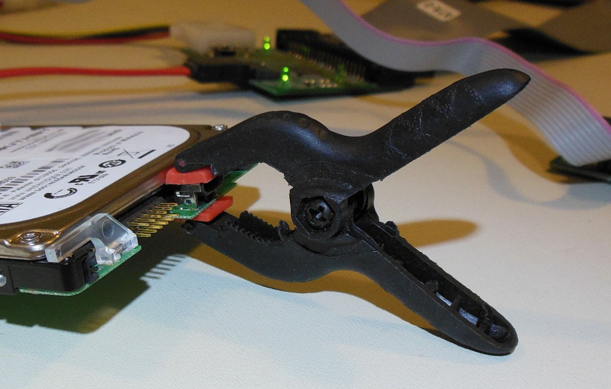

 Post subject: Re: WD 500 GB Ext - Spins but not recognised - not dropped
PostPosted: January 29th, 2013, 15:47
Posts: 1038
Location: South Africa
Sometimes the connectors of the USB port work loose over time. You can try putting pressure on the connector (as per picture) to try and rule this out. If it's not the connector then there's little else available relating to DIY unfortunately.
Data Recovery Cape Town
