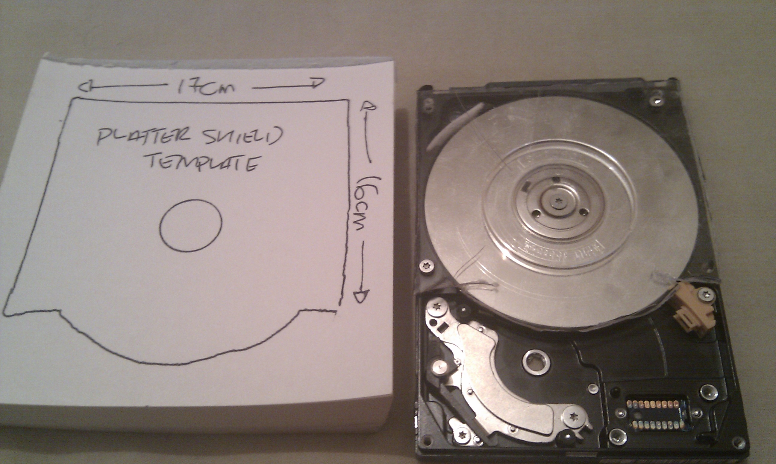

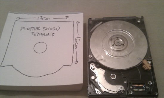

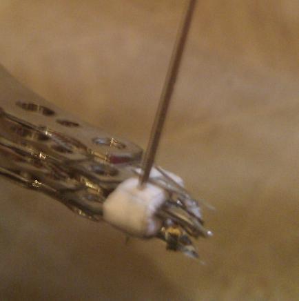

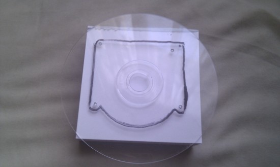

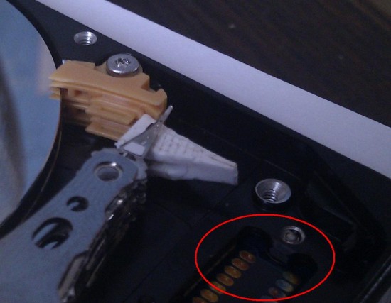

Hi, Well the data would be nice to have back :) The head swap was very quick, I learned from you tube :) Some pictures of my shield and my head. I'm not supporting my methods, just explaining how I decided to approach this problem. Until last week, I had never opened one before.
Best regards,
Megamox

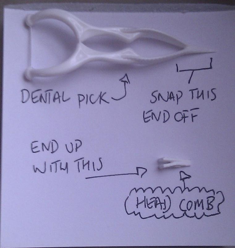

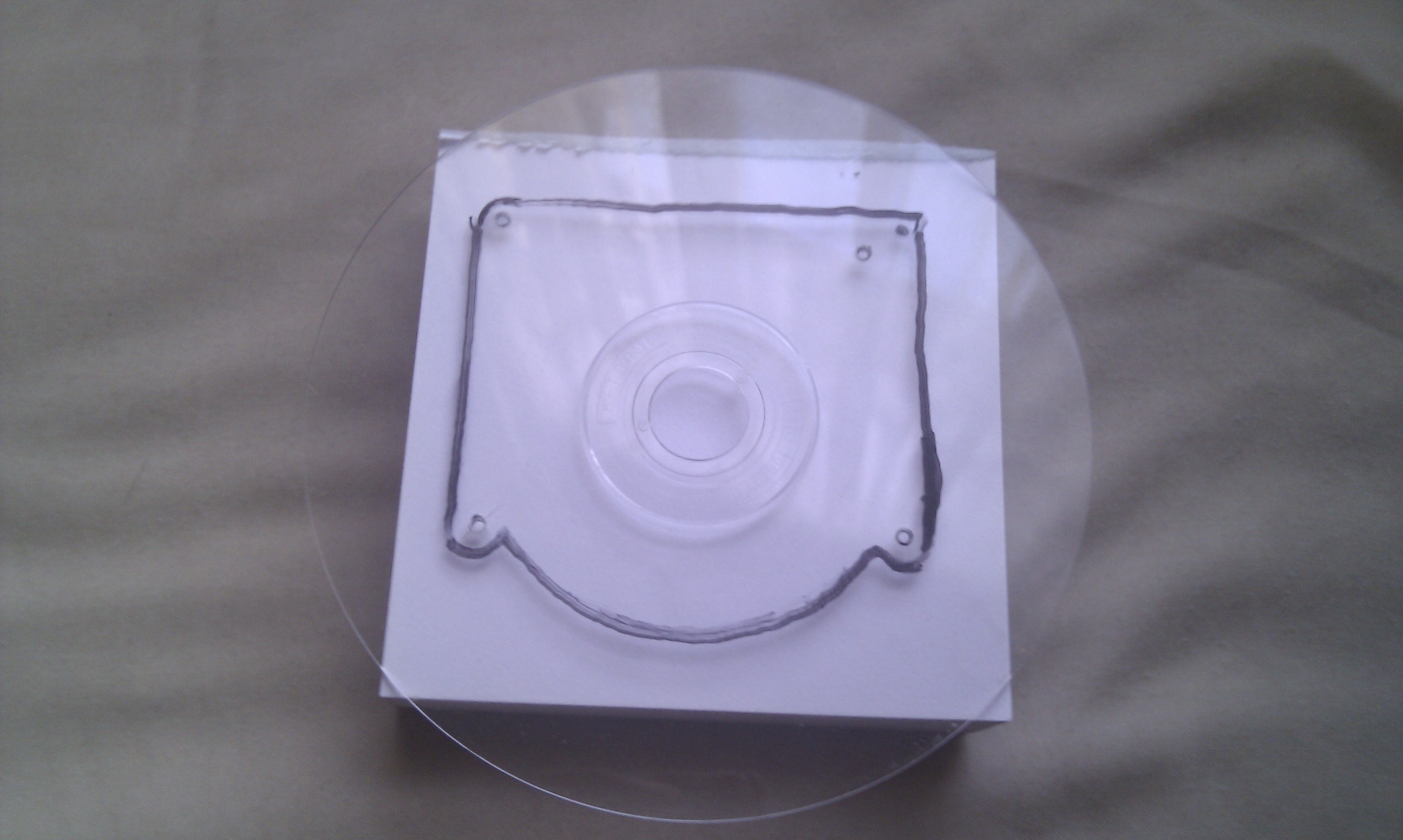

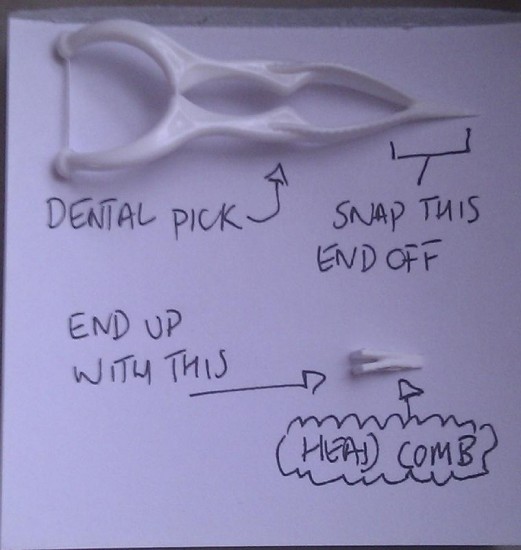

Not a great example of my DIY skill :) The platter is clean and untouched by the shield, resting about 1mm above it on piloted screws into the chasis. The marks are on the top of the shield during my careless manufacture. It's made from a plastic CD that usually comes when you buy spindles of blank discs. I also made some head combs from a dental pick :) I used to work for Dell, creativity was encouraged :)
Best regards,
Megamox

 Post subject: Re: HD drive not recognised but spins, firmware or PCB issue
PostPosted: February 5th, 2013, 0:56
Looks like half moon platter damage ring to me

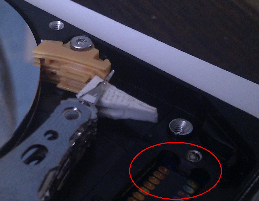

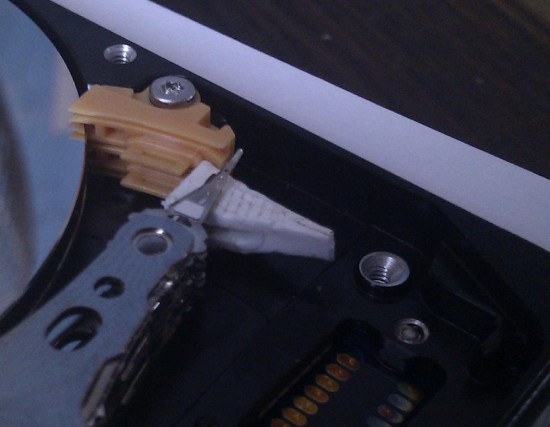

Location: Svenska

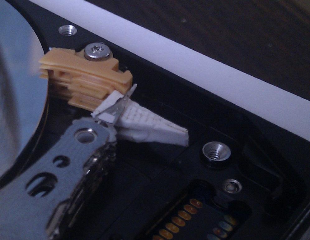

I see a lot of oxidation on pcb head contact, try to clean those with a pencil eraser.

Thanks everyone for your time and help :) I will try to give the contacts a clean and observe how the head behaves upon power up. When the drive has a donor PCB powering it, the arm does flutter back and forth from what I can hear, for this reason I assumed power and connection to the arm/heads through the PCB was adequate in general. I figured the last element to try would be to exchange the EEPROM.
Best regards,
Megamox
PostPosted: February 5th, 2013, 20:35
I think the heads are not compatible or platter damage.
PostPosted: February 6th, 2013, 4:05
Megamox wrote:
Thanks :) I forgot to mention, after the head replacement, the drive worked long enough for me to recover some important files. But has since disappeared.
Given this, I would go for platter damage, bad technique or contamination.
Chances are the heads were compatible.
PostPosted: February 6th, 2013, 4:19
Posts: 388
Location: Chicago, USA
I lean toward contamination, because the drive was exposed to non-cleanroom air.
