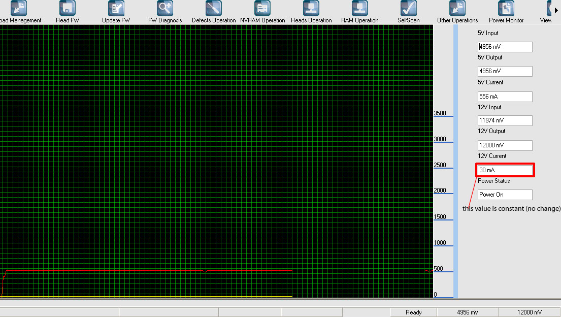

The drive had no power, dead PCB, swapped including the ROM (PS: NVRAM no more exist in these series), got power but NO SPIN, NOTHING...
Suspected CORRUPTION in ROM, MATCHED with SIMILAR config everything ... still no response...
So, what else the drive might have trouble at all in your mind?

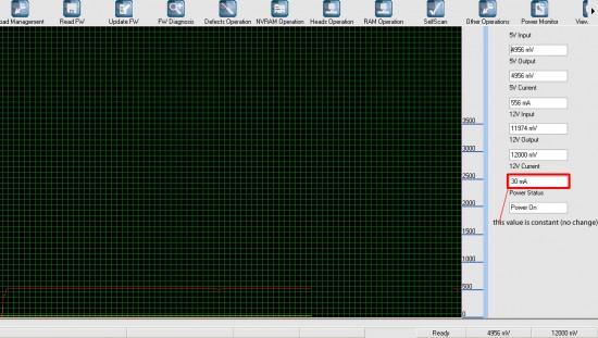

 Post subject: Re: Another CLA HDD (HDS721016CLA382)
PostPosted: February 6th, 2013, 11:50
Posts: 1061
Location: Bangladesh
Check out the POWER MONITOR if you have something to say...
1. This is the Image attached indicating POWER details WITH DONOR PCB & PATIENT ROM.
2. With DONOR PCB & ROM "POWER MONITOR" has same output.
With the donor PCB the drive comes to READY in few seconds.
With Patient PCB, STATUS is "NO HDD"
__________
THANK YOU
SHAHI
shahi.mahbub@gmail.com

I don't have oscilloscope for now. But for the case problem has been identified.
It's SA Failure. NO ACCESS to SA, not supported for CLA3 HDD till date.
The spin does WHEN THE PCB IS UPLIFTED WITH MOTOR CONNECTION ONLY.
PostPosted: February 7th, 2013, 7:58
