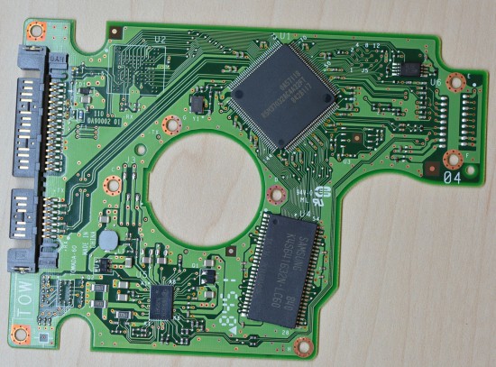

Hi guys do you know which is Nvram and rom here?

i think u6 .but if can get more resolution picture , that will help more

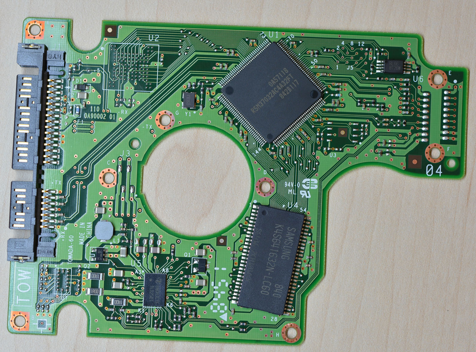

click twice on picture.

Spildit wrote:
U6 is the chip that needs to be swapped (8 leg chip) in case of pcb exchange. If you are replacing the pcb make sure that the one that you will use as replacement doesn't have any chip on the U3 position too.
Yes, that's right, and is also same ROM version.

Unfortunately the overvoltage demaged not only fuse and MCU, but also pre-amp,
head swap was mandatory but all data recovered
happy ending.
