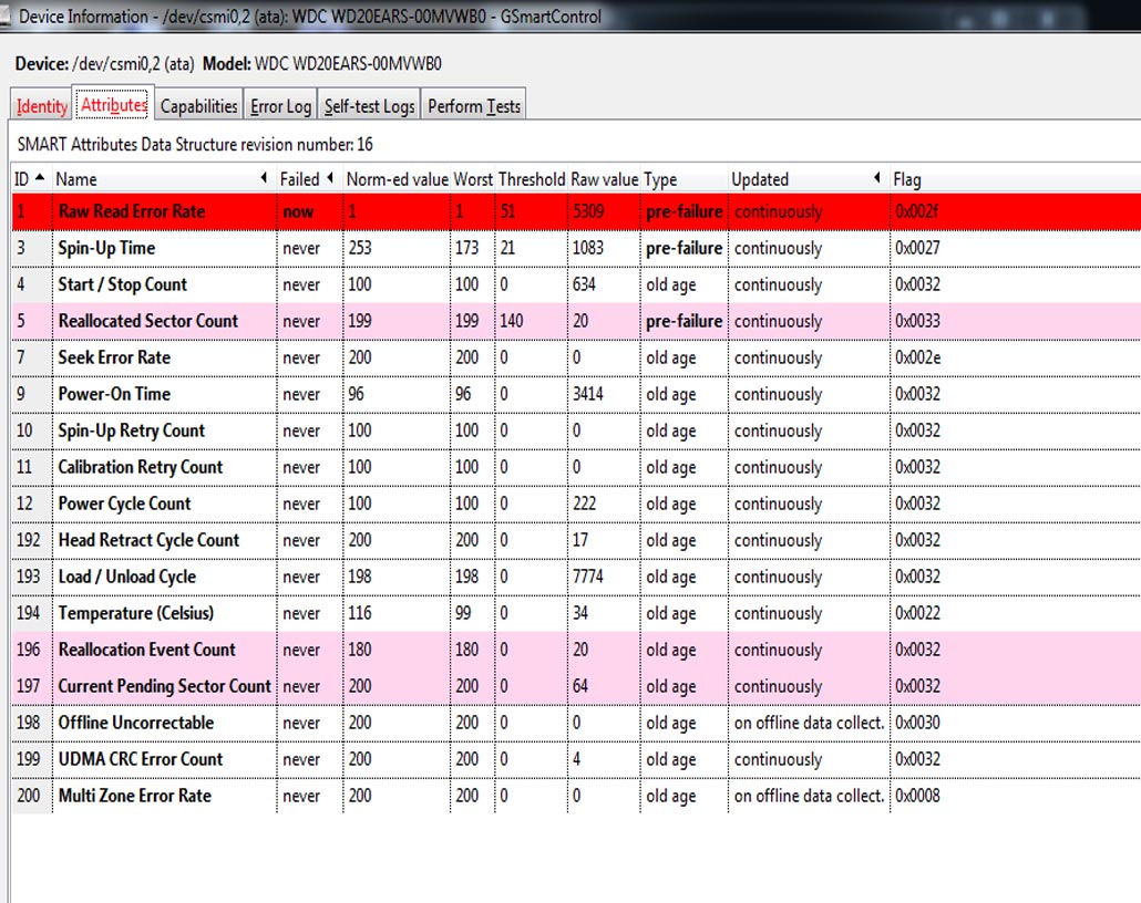

I have attached a screenshot (below) of the latest GSmart report noting that it is not the 0xC7 attribute, and what I said before could be confusing. If the rest of the info can help you (or anyone else with experience in the area) understand what might be the likely problem with the drive, I would appreciate any thoughts. In the last week or so the item on the the top row has gone from 3000+ to its current value of 5309 and the rallocated sectors has gone from 4 to 20. Not much else appears to have changed greatly.

Thanks for the Gsmart screenshot. The highlighted SMART attribute is completely different than the one with "CRC" in its name (which was the best guess that I could make, given your earlier comment), so obviously that part of my last reply was a waste.

Out of curiosity was there enough information in the GSmart report to give anyone with experience an insight as to what is going wrong? @Spildit you suggest that heads might need replacing, is that was you see from the info in the screenshot?

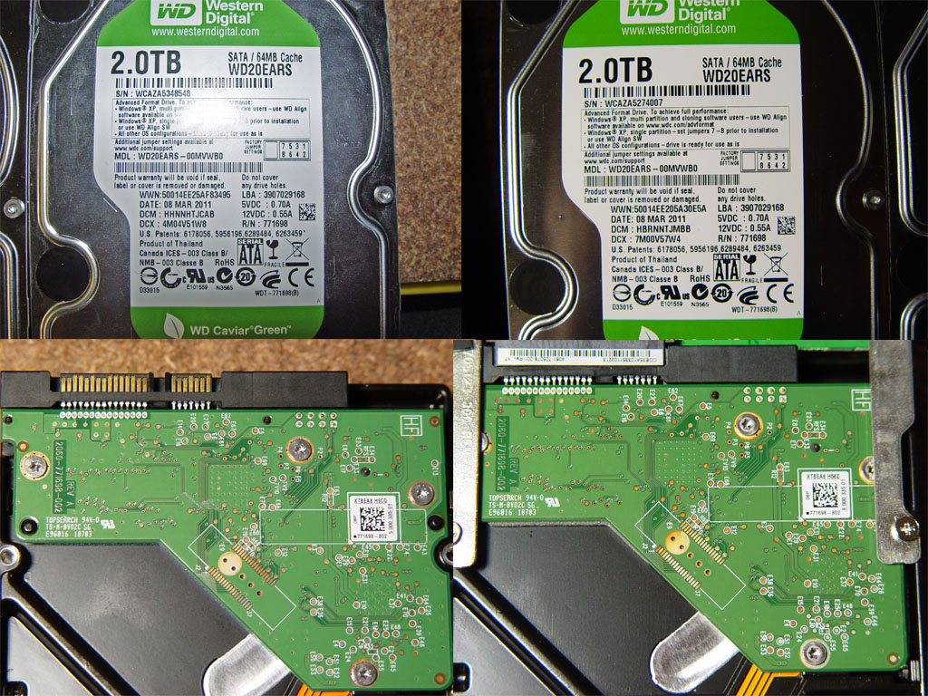

Can anyone tell me whether the PCB boards on the following drives are compatible?
I have been trying to recover data from the left hand drive which is failing inconsistently and noticed that there is a tremendous amount of heat coming from the PCB board of the left hand drive and there is the characteristic electrical aroma. (see pic below)
I have tried to find a DR company in Australia, but the costs I am been quoted are just prohibitive.
Both drives are identical models, manufactured on the same date from the same factory and have the same PCB board.
However the DCM numbers are different, being HHNNHTJCAB and HBRNNTJMBB, and I can't seem to find a definitive guide on what they mean.
The research I have done thus far seems to indicate that the firmware is on the disk, so I am making the asumption (perhaps inccorectly) that I may have a chance with this board swap.
Naturally I have backed up the good drive and would be prepared to lose it if I have a chance of recovering the failing one.
Any additional thoughts/comments appreciated.
