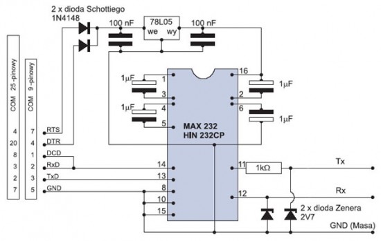

My ST2000DM001 (2To) in external USB Dongle works fine, till windows detects some errors (yellow triangle) and the HD seems disconnected,to use it i must disconnect and reconnect it, CrystalDisk Info tells me too about Some errors.
I buy and second HD to Backup my datas (2To of Music, photos and home movies).
At Home after preparing the new one, the First (ST2000DM001) dont work anymore and are not detected by windows, after power on, he just start spinning and after some seconds, he make some Clicks (11 Clicks) then stops.
Even if i plug it directly to my Sata plug (inside my PC).the same thing happens (11Clicks and stop).
After contacting Sea*ate, they tells me its a OEM product.
And after contacting Tanscend (USb Dongle Manufacturers), they tells that my warranty was lost after i've open the USB dongle.
Now i'm face to a wall.
Is there a way to diagnose what wrong with it (The Heads?, The PCB?, The Preamplifier?.....).
I even tried my old TTL interface but seems dont communicate with it (I just receive random characters in the terminal window).
Anyone have an idea?
Thanks.

Your drive probably got FW or heads problems, to test it is needed to comunicate with drive via TTL
Probably your comunicacions parameters are wrong. i have not info about comunications params here. probably any guru here can write it for you.

Baud rate 38.4k

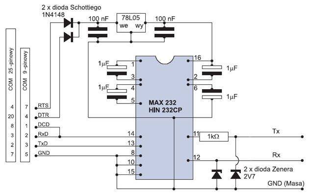

I have a diy RS232 TTL interface that work perfectly with my old 7200.11.
But not with this one.
Is there any schematics around for RS232 LVTTL (i think the problem is the kind of TTL).
The terminal parameters seems ok.
Another thing i noticed, The MCU are very very hot during power on.
Some suggestions?

For now, i'm searching how to communicate with the PCB via RS232.
I'm serching for schematics of LVTTL interface.
The I/O voltage is much lower (1.8V) on the latest models.
See this modification:
viewtopic.php?f=1&t=29286
http://img11.hostingpics.net/pics/228167mod18V.jpg

Thats what i'm looking for,
Thanks fzabkar
Thanks pikus_09.
Tomorrow i'll buy the missed components.
Thanks again
