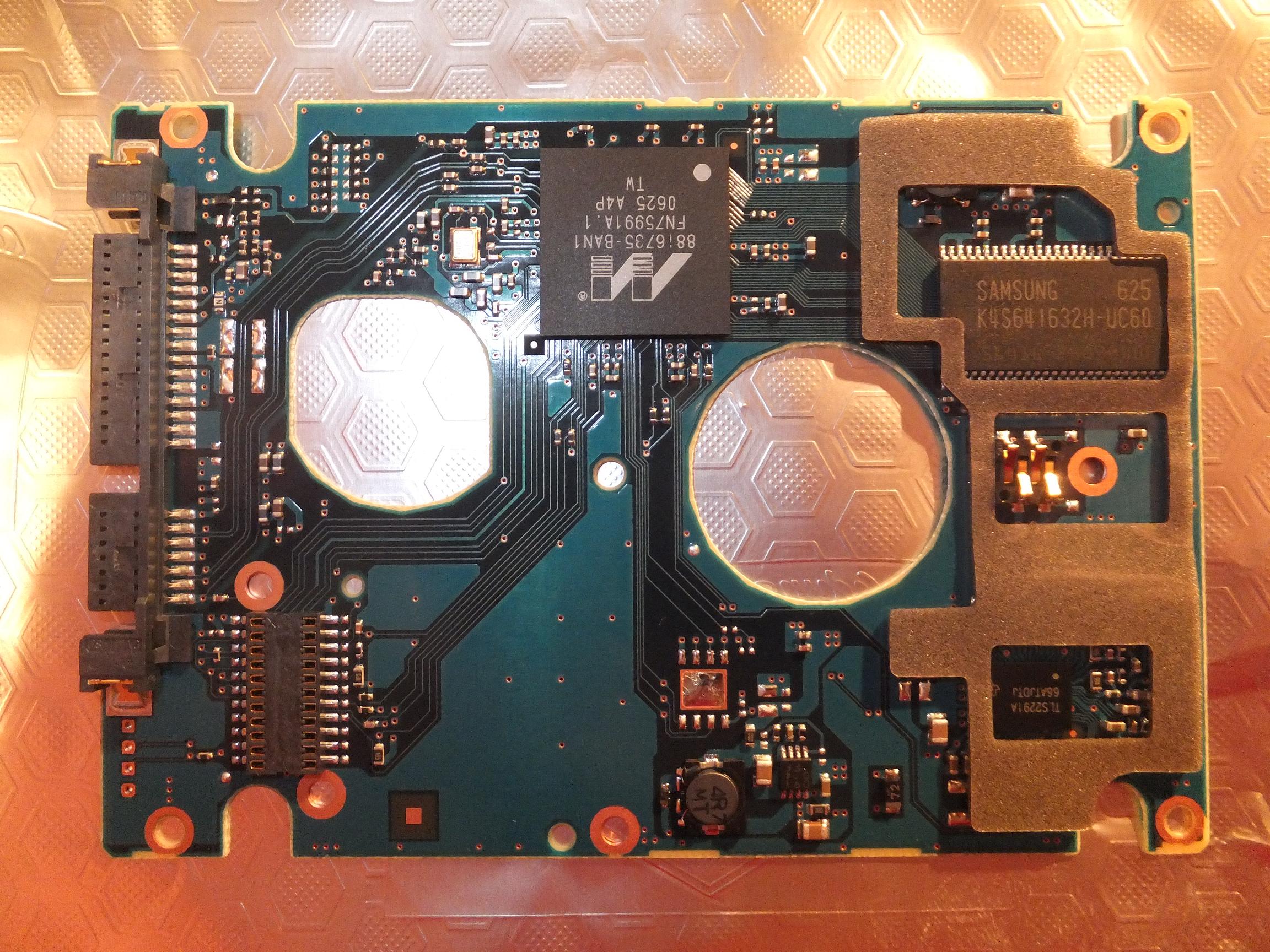

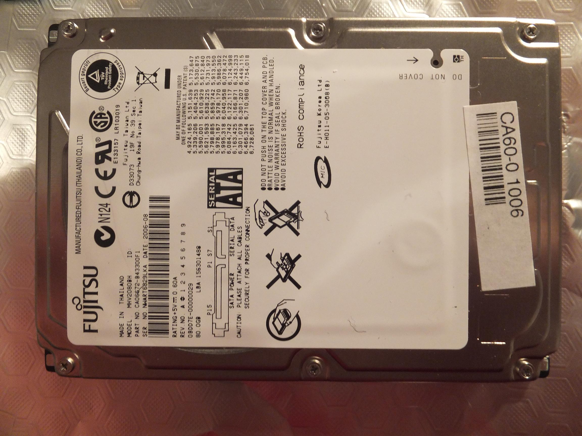

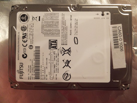

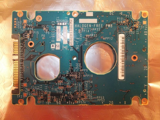

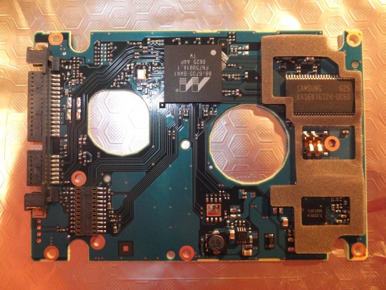

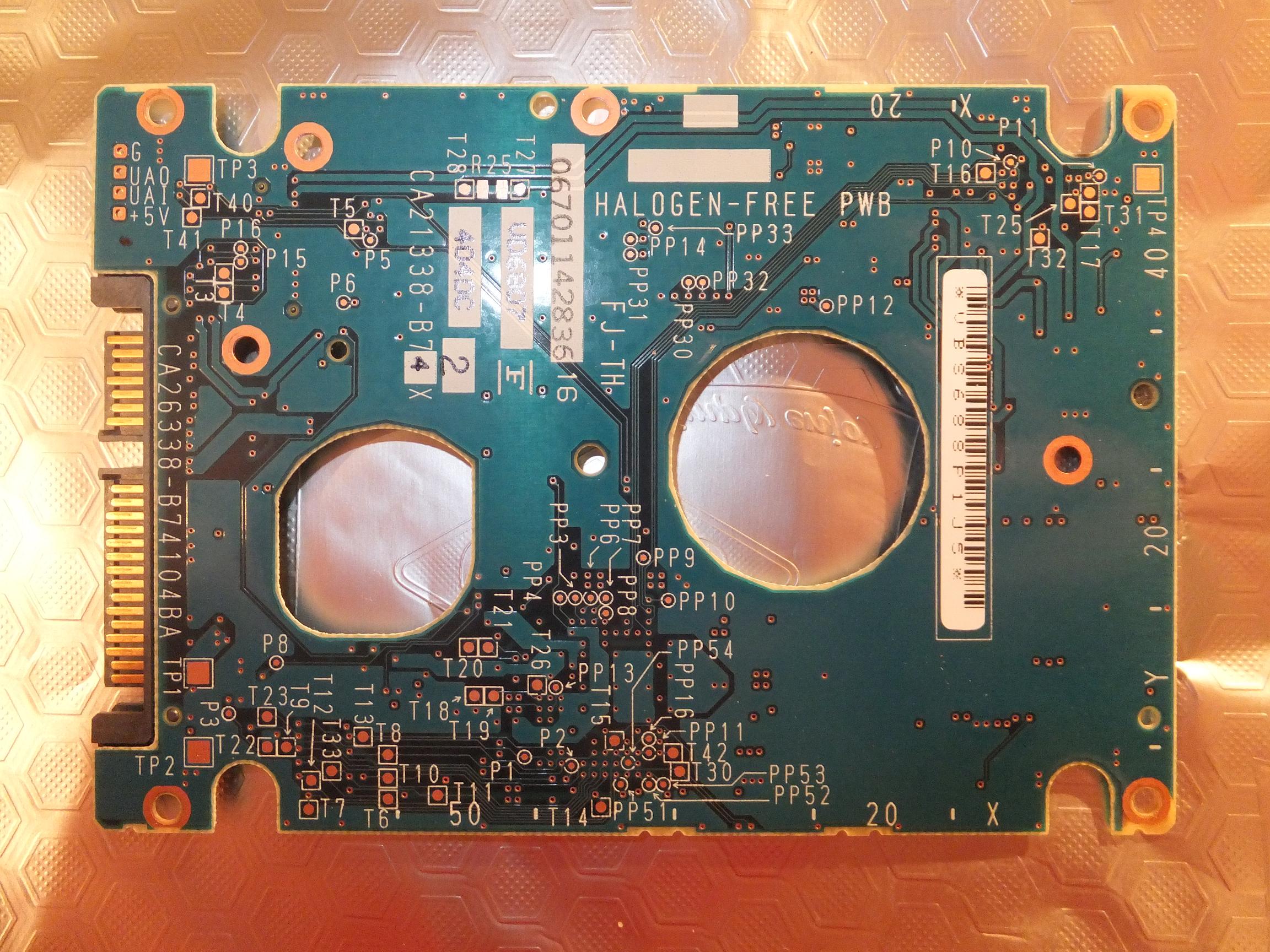

Attached find the photos of the drive pcb. It would be nice if you could tell me which the fuses are and how to check.
I would give it a try to "bridge" the fuses before binning the drive.
Thanks in advance!

 Post subject: Re: 80GB SATA Fujitsu MHV2080BH does not spin up
PostPosted: February 24th, 2013, 16:43
Top left (ish)....
little component with an "N" on it.

Thank you pcimage!
The fuse is conductive meaning not blown.

Try connecting it directly to the SATA power port of a PC, and test without connecting the drive
Check voltage at the fuse (5V) and on the two coils(inductor) .
Very limited DIY options ,though ,on this board.
You will have to find an identical pcb and replace the pcb to bring the drive up.
Then cone the drive (as the drive initially was failing and had bad sectors) and recover data from the clone.
Involves time and money, and chances of recovery( by DIY )is less

Found a Disk MHT2080BH ... Drives Product Manual, which supports sathyan's statement that only 5 V are needed for drive operation.
Voltages at both side of the fuse are 5 V. Voltage drop accross the fuse is definitely less than 0.1V. The drive does not spin at all. The 5 V could be found at several places on the board and also near the coils resp. the 8 pin voltage converter ICs (D91 02/04 ?)
But according the manual there should be Voltages 3.3V, 1.2V and -3.0V around. (I could imagine that UA0 and UA1 on the pcb should reflect two of them). I could not find any of those voltages on the board.
I guess that the voltage converter ICs need a clock that has to be generated by some other circuit - probably the motor controller IC. Thus I suspect that this BGA-IC is gone.
Unless there is not another simple protective element on the board that burnt and could easily be replaced I would agree with sathyan that getting a replacement pcb is the only suitable option for a DYI approach.

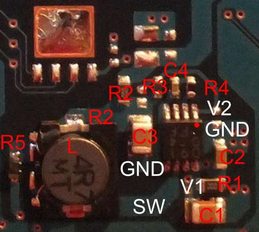

My assumptions were completely wrong. Thans to fazkbar's part list I found a hint:
The voltage regulator ICs seem to be "Synchronous Buck Converters" that have their own oscillator on board. Data sheet from ROHM BD9102FVM and BD9104FVM:
http://rohmfs.rohm.com/en/products/data ... 2fvm-e.pdf
The regulator block at the lower side is then for 3.3V. (See attached image)
I observed that output voltage is low as 0.5 V and the IC is getting extremely hot.
Output Voltage is fed to EN of the 1.2V regulator block at the upper side of the PCB. The voltage has to exceed 1.2 V to start the converter. So 3.3V is not operational hence 1.2V regulator does not start, which explains that both voltages are down.
I thought of a short circuit. The Resistance between top of R2 to Ground is only 4 Ohms.
Now some questions to the pros:
Is this indicating towards a short circuit?
If not would it make sense to replace the 3.3V regulator?
Would it be possible to feed 3.3 V from an extra power supply to the top of R2 and desoldering R2?
Thanks in advance

Meanwhile I could give answers to my questions:
Q: "Is this indicating towards a short circuit?"
A: Yes, it was the voltage regulator.
I desoldered it and the resistance between top of R2 to Ground is now 4.8k Ohms.
Q:"If not would it make sense to replace the 3.3V regulator?"
A: Yes, If I had one
Q: Would it be possible to feed 3.3 V from an extra power supply to the top of R2 and desoldering R2?
A: Desoldering of IC is sufficient. Feeding 3.3V from an ATX Power supply is possible
=> All voltages are available again
I remounted the PCB on the drive chassis and the drive began to spin.
With the external USB-Adapter the drive is now detected in Windows and all files could be copied.
Now the drive is ready for binning .... Or I try to get a voltage regulator.
Thanks to everybody for your hints! I am happy.
