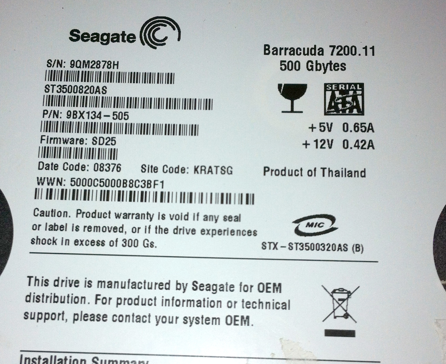

Hi all,
I have a Barracuda 7200.11 500 GB hard disk (ST3500820AS, fw SD25).
It was part of a Iomega USB enclosure. The HD was spinning up on
enclosure power on. I don't know yet if the HD is recognized by the BIOS
but we'll know it soon.
My only goal is to recover/backup data and not to fix the disk for future use.
I already fixed another 7200.12 Seagate disk but I want to be wary and patient.
I've got an USB to TTL device to send firmware commands.
I have a couple of questions (provided the BIOS sees the disk):
* how to know this HD is affected by the BSY bug?
* if the BSY repair procedure is efficient, what is the best procedure/tool to backup data? dcfldd/dd/ddrescue or mhdd/other tools?
* I guess I need to fix the bug then backup but before any attempt to update firmware?
* is there a list of SD25/Seagate firmware commands?
* is the a SD25 command giving the state of the drive?
Thanks a lot for your help.
First, you have to find an answer for your first question. Otherwise, we'll have to write several books on all possible problems with Seagate and all possible solutions with all possible tools.
Spildit gave you very good advice, because you can turn a little problem into disaster in one wrong move.
www.datarecoveryne.com
 Post subject: Re: Seagate Barracuda 7200.11 fix procedure
PostPosted: March 13th, 2013, 12:10
Posts: 2984
Download a copy of MHDD (you can Google for the link) and make bootable CD/USB/Floppy etc
Boot into MHDD and connect your HDD via direct SATA connection (may be worth connecting a known good drive to correctly identify the channel it occupies)
With it connected check its status register. If constantly on 'BSY' flag and no other register is lit, then probably it has common bug. If you can read ID good, but capacity is '0' then it possibly has translator error, though this is also symptom of physical error as this can sometimes be displayed from PCB only. also, check behaviour of the disk during powering.
I wont condone DIY repairs, nothing personal against you but the majority of DIYers generally do more harm than good. ultimately its your choice (or your friends). You can search for the solution, there are plenty of info on it here (assuming you do have one of the common fw errors) but do at your own risk. Generally the process is safe if you know what you are doing, so I highly advise you make some research before you attempt it.
Probably the best advice I can offer is to get MHDD, check the status of your HDD and report back here. Hopefully you can gt a more definitive answer to your problem.

I would suggest that you follow harddrivespecialist advise and download MHDD from here. Make your boot CD and then mount this drive on your MB. Boot from your boot CD and see what it says.
If this is really a 7200 bug fix for busy or 0 LBA you can do a search here on this forum. The terminal commands are well posted. You can even know how to make a terminal adaptor for this drive from the internet. You can google the Seagate LBA 0 or busy fix. There is some good step by step instructions on how to do this one.
I will only advise you that if this is really not this issue and you try this fix you can brick your drive. I would start off with MHDD and see what happens. Second I would search on Internet to find out how to build you a terminal adaptor. Thrid after you have your terminal adaptor you can get an output for a terminal log. If you can post this output here this one would really help.
Also if this one is a major problem after seeing terminal logs I would like to suggest that you do send this to a DR company to fix it. There is some good ones in France that can do this for you. If not I can recommand PCImage out of UK he is a very valued member here and will be able to give you a very good price on this one.
Please post your terminal logs after checking on MHDD and making your terminal adaptor. Thanks and good luck we will wait to hear back from you on this one.

do I need to send out specific firmware command or just connect to the device?
No, do not send any commands yet. Just connect the drive and power it up and report what is displayed.
And do I need to install the plastic/paper stuff in order to disconnect motor
connectors first? What terminal do you use? Hyperterminal is no more provided with W7, so Putty?
Don't isolate the motor, connect the drive as it is, start a terminal session , power up the drive , post what is displayed.
Putty will do fine.
