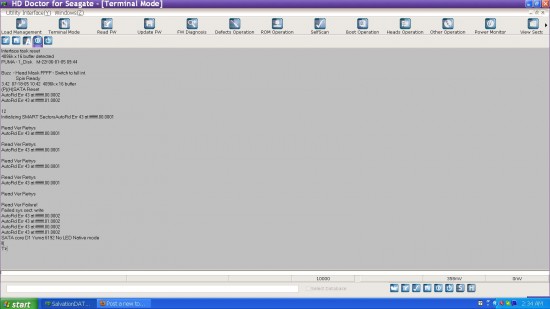

please
what to do in this situation,

I found this for disabling bad heads in terminal:
Disable heads commands for K4, K5 and K6: T>, enter YA0, click ‘Enter’ and disable the damaged heads;
Disable heads commands for K7: T>, enter Y20, click ‘Enter’ and disable the damaged heads.
Font:
http://www.datarecoverytools.co.uk/2012 ... -commands/
I never tried those commands, be carefull it may be danger
