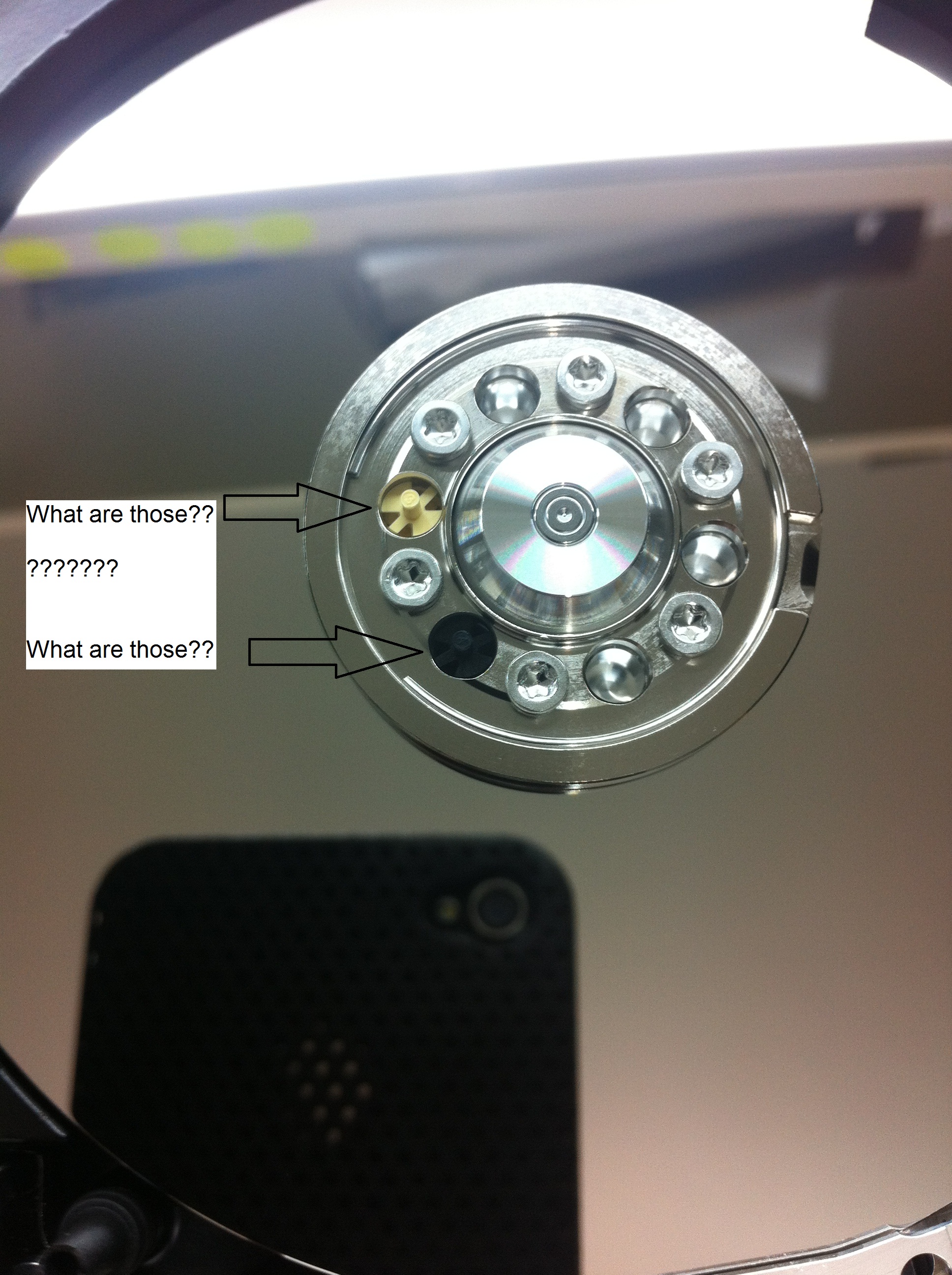

Hi All,
I got "a fail to recover" drive from a competitor lab (the client gave us the drive and not the other lab - in other words: this is not an outsourced drive).
I opened the lid of the drive and saw the following:
1) Only 1 platter with clean surface.
2) Two weird plastic bolts in the gaps between the bolts which tied the motor ring to the platter -> see the attached picture.
The drive model is:
WD1600AAJS-00PSA0
I never saw such bolts before inside a drive. Does anyone know what those 2 plastic bolts which were found inside are??

But the most weird is what those 2 plastic bolts are?!
PLEASE SEE THE ATTACHED PICTURE :)

you will notice that they are not actually in the bolt holes..... they are there to perfect any imbalance in the platter rotation. Like balancing a wheel..... different colours are different densities (weights) and are placed around the centre hub to iron out any excessive vibration.
COOOL
Where can I buy some of those??
What its professional name?

You will find them very often in F4 samsung, when you use a donor for heads you can take the little rubbers,
but what for :) did you build a balancer for hard drive platter :shock:

Those can be found inside of some drives.
It's not a thing that a DR guy would put there, it's a thing that is already there :)
Are you sure about that?! :?: :?:
I never ever saw somthing about that and I opened at least few hundreds of drives already..

Spildit wrote:
I did not build it. It come like that from other recovery lab.
Do you think that they put it on purpose before thay faild or even worse -> after they faild?!
Those plastic bolts are not seems femiliar from samsung heads or any other drive part no matter what vendor it is.
Any guess where do they arrived?

They are pretty common if you open up enough drives.
