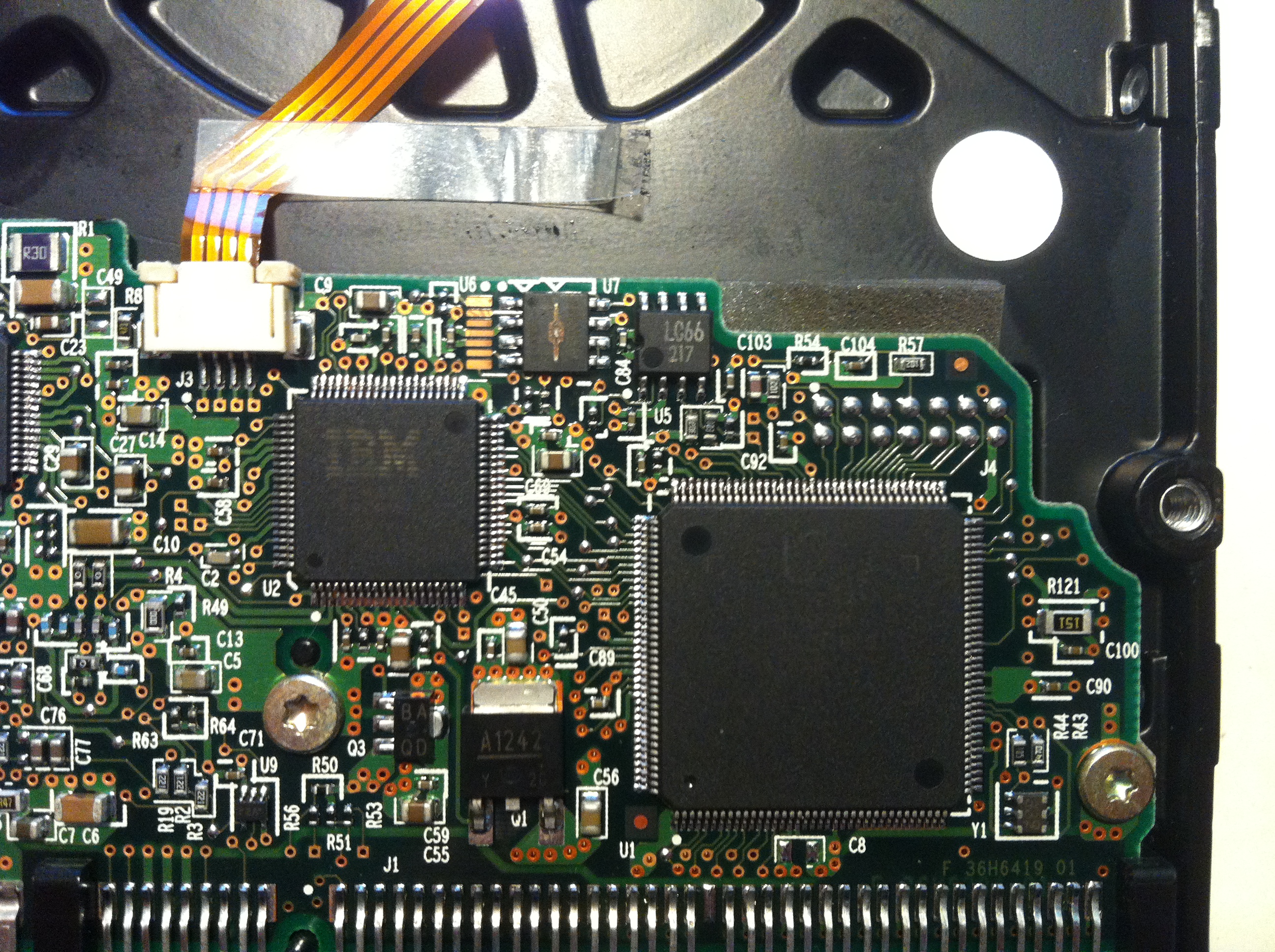

Hello everyone
first of all, i'm sorry if my sentences will be confusing or not well written but my english is a little rusty so...
My story:
three days ago, suddenly, my IBM DeskStar 120GXP 7200 40Gb Cache 2Mb 3.5" P-ATA UDMA100 ATA5 IC35L040AVVN07-0 has stopped working. the bios of two different motherboards can't no longer recognize it, and the disk doesn't spin at all...
i've some old photos on it and it would be great to recover them, so i've started searching for a solution, in a limbo between big money-no stress-option of data rapair centers and small money-big stress-option of PCB swap...800-1000€ vs 20€...i've started thinking for the pcb swap (c'mon don't say that memories are priceless and i'm a heartless-nerdly-scrooge, i'm only a student!)...after "some little" researches i've spotted the right pcb, MLC, P/N, first two lines of the white label, all corresponding...but now...i find out that isn't enough...i'll probably (almost for sure, but i don't want to think to that now) need to swap the NVRAM chip....well. i think i can find where the chip is on the board, but the work....mmm...i've got good manual skills ( :oops: ) and i've already done some soldering works but this pcb is too small!
so here comes the questions:
do I really need to swap the nvram?
what could happen to the drive if i first try the swap off the entire pcb?
do i risk to compromise forever the data?
i'm going to lose both the pcbs?
are there any chances to get my data back?
thanks in advance

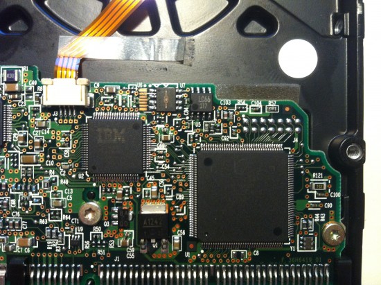

 Post subject: Re: IBM DeskStar 120GXP Fail - PCB swap
PostPosted: February 21st, 2013, 11:01
Joined: February 20th, 2013, 21:13
Posts: 10
Location: Italia
i've been searching for TVS diodes on this pcb but the only diodes i've found are on the other side of the board.
named d1 and d2, one of them is slightly different, like "shiny"...
anyway, this is the front of the pcb.
https://www.dropbox.com/s/iuniin22kki2fx6/IMG_0668.JPG
https://www.dropbox.com/s/tg0rjy42rzzckqb/IMG_0669.JPG
the nvram is the LC66 chip?
File comment: IC35L040AVVN07-0

LC66 217 On your picture it's the NVRAM.
well,
thanks Splidit, i've searched on the net and i've find out that the nvram usually is an 8 leg component with a code wich starts with "25...".
the low profile chip next to the LC66 has a 25xxxxxx number on it...
i'm a little confused
PostPosted: February 26th, 2013, 8:09
Posts: 2984
gifo wrote:
well,
25xxx is programmable EEPROM. This is not NVRAM. The info from Splidit is right

Little Update:
i've found a compatible pcb and i've swapped the NVRAM chip, the disk is alive!
i've recovered the files i needed, a few gbs with an external ide to usb cable, powering the hdd with a standard atx psu (the external little thing they gave me with the cable wasn't stable enough).
so, i can tell that in this case, searching for a donor pcb, with the same:
-p/n number, on the disk label
-MLC Number, on the disk label
-first two line of the pcb number, on the pcb label, above the ide connector
-same assembly place (made in china in my case)
-max 30 days between the production date
in my particular case
-the motor controller was different,
-the main controller has the same first line number 47P2010 but the second numerical line was different for the last third digit (original was: 1J06T02MLQ donor was: 1J06T02QLQ)
-the other big component, i think is the memory, but i'm not sure, is different:
    DONOR:__________ORIGINAL:
    IBM______________IBM
    TAIWAN__________TAIWAN
    SPRCBM BB_______SPRCBM BB
    50G7143__________50G7143
    1F10076TQT_______1J14002TQT
WELL,
i don't really know if i was lucky (for the first time ever) but i can say that, IN MY CASE, the pcb swap, with nvram swap, has worked.
thanks everyone for the help and the suggestions
bye
giorgio
