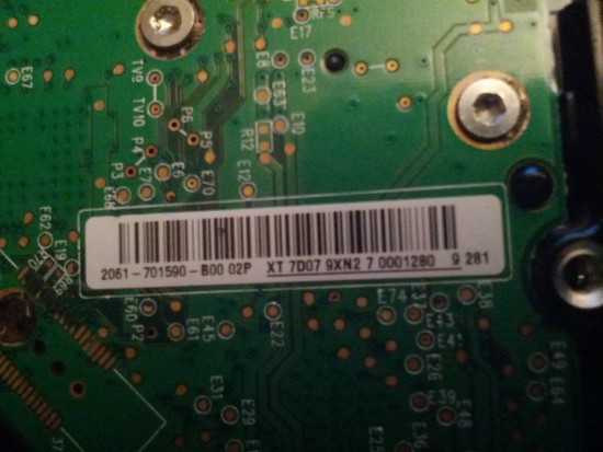

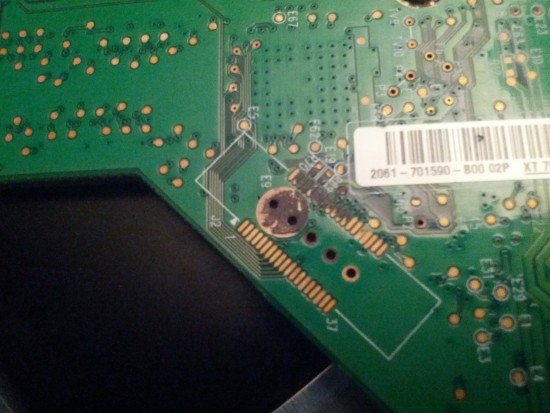

Alright, I'm new here and after browsing and browsing I've decided to just join.
I've got a WD WD10EACS that has a burnt out section on the PCB, as it received a surge while running. Thankfully, the drive spins up and doesn't make any clicking noises indicating bad heads or anything. What I'd like to know is, can I swap in another PCB to revitalize this drive? I'm not worried about the data on it, as it was given to me in a tower with a bad motherboard/processor/psu because of said surge. Can I swap PCBs and format, or is this drive pretty much just dead?

That's what I kinda figured, I just wasn't sure. The burnt part is right next to the lower-left side of the PCB part number sticker/barcode, if that helps. I can upload pictures. PCB swapping won't help me? I'm not interested in the data on it, it was given to me by a friend.

Here's the damage, if it helps.
 Post subject: Re: WD10EACS Recovery?
PostPosted: March 8th, 2013, 3:22
Doesn't look burnt to me, just normal corrosion.
I think your problem is elsewhere, given that the drive spins and "sounds normal"
Either way, if data is not required then just toss the drive.

Ok, that's what I figured.
I thought it was burnt there because this was also in a RAID configuration with an identical drive, neither was recognized, and they both were damaged in the same spot, in the same way. Just strange to me.
