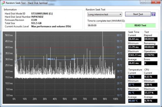

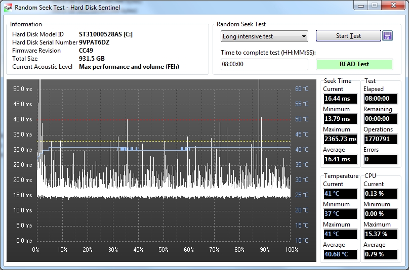

Hello everyone! I've been having 1-3 second freezes while playing games, or listening to music, so I decided to start look into it. I ran a seek test on my drive, and it came back with an average of 16.41, but with maximum of 2365.73. So theres definately something wrong, but from this point I'm not really sure what. SMART is saying the drive is fine. Ive tried a new sata cable in a new port. I do not have another drive or computer that I can swap with to test. RAM and CPU tests come back fine, so I'm assuming its between the HDD\controller. Anyone have any insight for me?

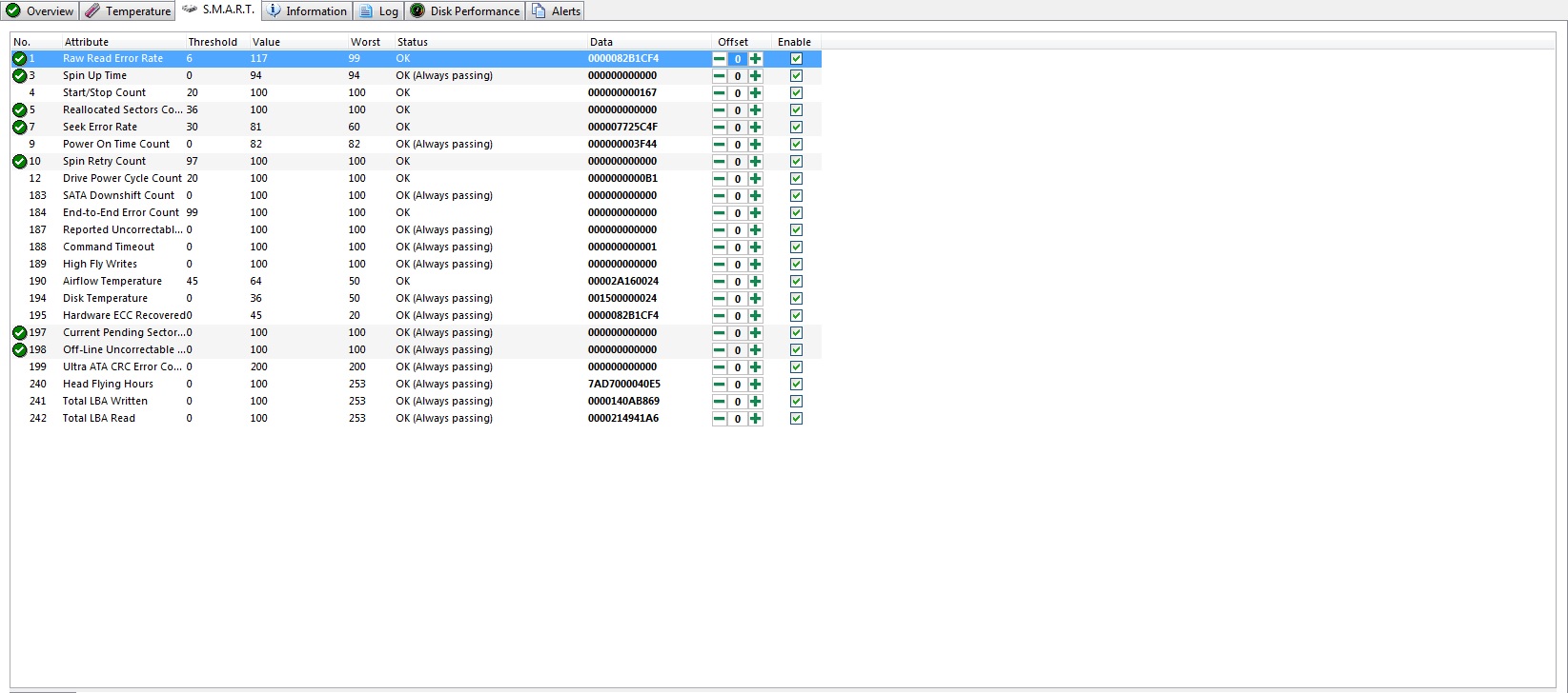

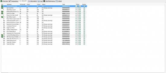

Another approach would be to start by looking at the full SMART data reported by HDD Sentinel, which you are already using. What is the full SMART data which it is showing? That's probably easier for you :) Can you attach that full SMART data in a screenshot?

I do have a backup, so thats no problem. Heres the SMART data.

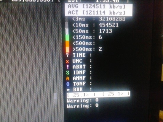

So its scanning right now, and under where it posts all the delays and such, its saying Warning: 234071385. What the heck is that?

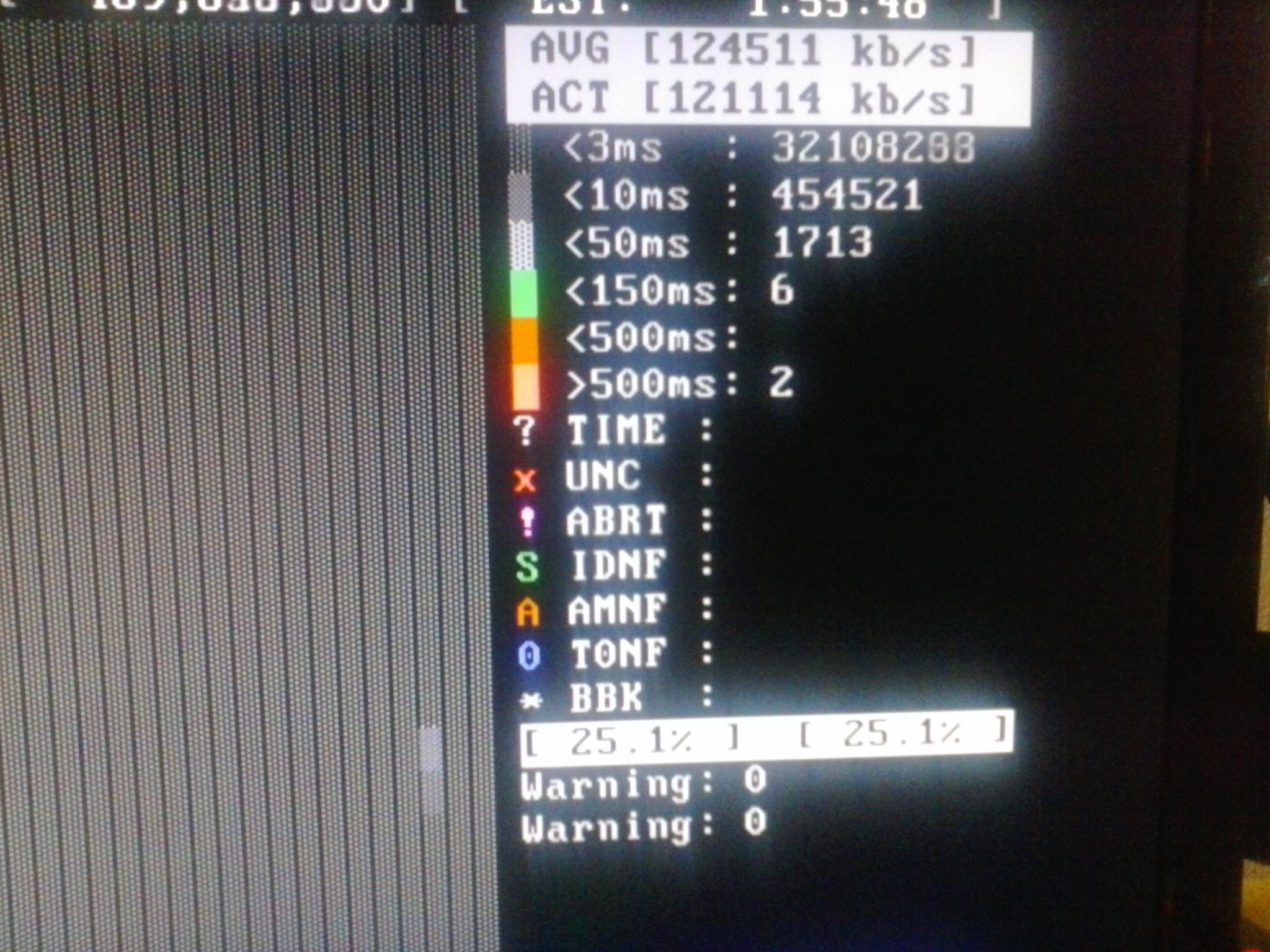

Alright, I ran scan on loop last night, heres the photo.
I appreciate that you're trying to provide info, but I didn't say to run it in a loop, for good reason :( Unfortunately from that screenshot, we can only see the most recent 25.1% of the result from MHDD.
Kyle6924 wrote:
heres the photo.
That shows that within the first 25.1% of the disk, there were 6 blocks (each of 255 sectors) with 50-149mS verify times, and 2 blocks with over 500mS verify times - which is obviously bad. Although I can think of one highly unlikely electronics issue which could cause this, it is much more likely that your drive is struggling to read a few sectors. I've seen this behaviour on those disks before - most sectors are normal & quick to read; a few are slower to read; and a very few are very slow (due to internal retries). And before you ask, no, this isn't necessarily visible in the SMART data, it all depends how far the drive's behaviour has degraded - been there, done that, got the T-shirt. :(
If you want more confirmation that it's a drive problem, then you need to check whether the slow areas are the same each time, for multiple single passes (if it's the same areas which are slow on multiple single passes, then it's the drive which is the cause). MHDD does have a way of making a log file during a scan, but I've only used that once, and you need to have MHDD on a writable medium with lots of space. Personally I wouldn't try. Instead I know HD Tach has a test of read throughput (i.e. sequential, not random, reads - sequential is what you need to use). If HDD Sentinel also has a sequential read test, then great, you can use that. In each case, you need to get a graph of the read throughput, print or save that graph from one full read of the disk - then do the same thing again, and compare the graphs. Do the dips in throughput line up on both graphs?
