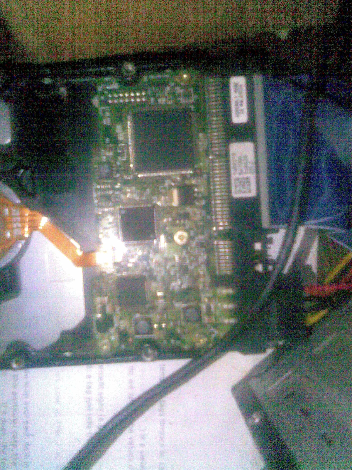

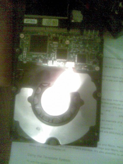

you are correct. It is almost identical to the first pcb in that foto. I am upping a picture of the hdd right now. The quality is not great my phone only has a 2mp camera. If you need it clearer let me know and i will do my best. thanks.

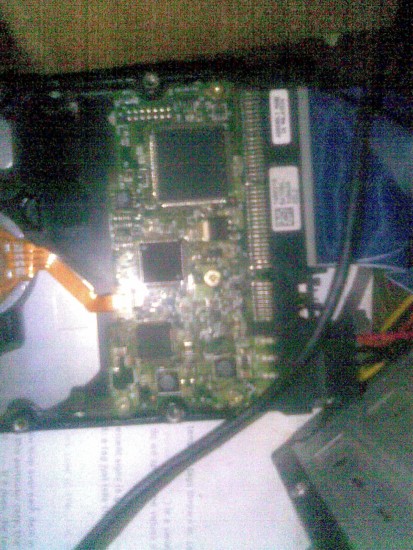

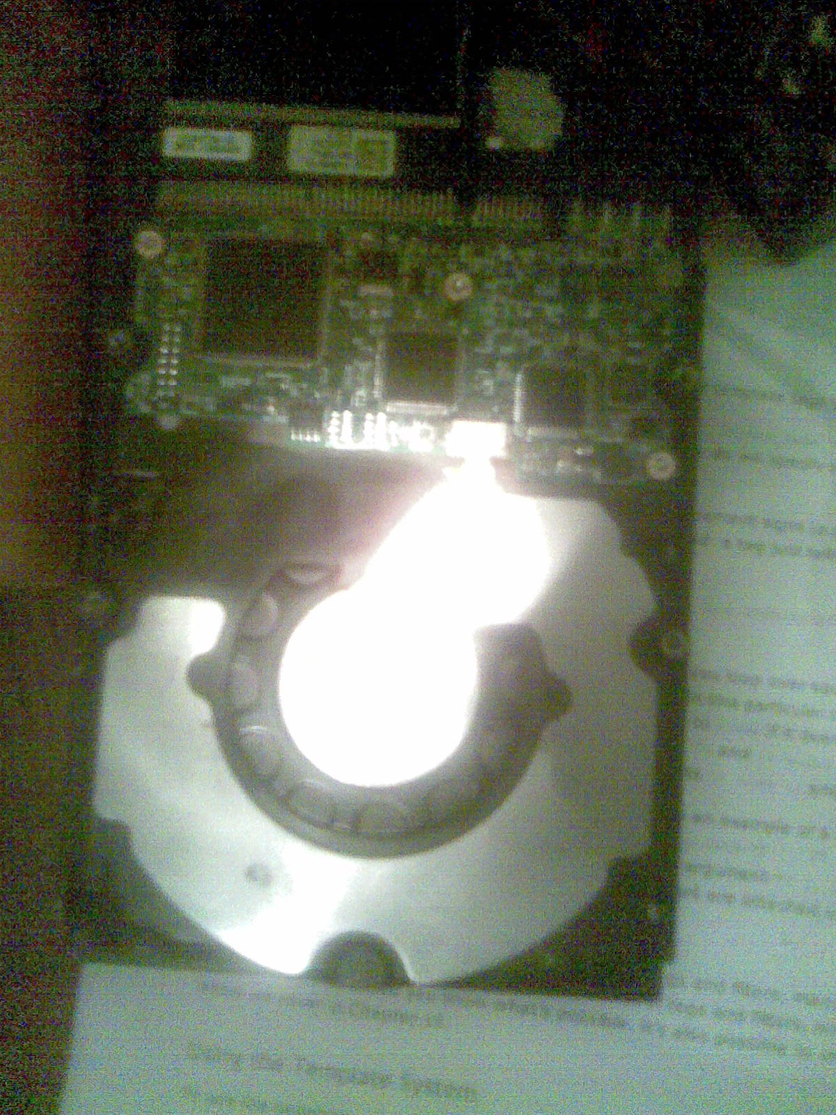

another one with slightly better light.

Sorry, I can't make out anything in your photos. In any case I can't see any "voltage protector" on my PCB. If you wish to try a new PCB, then be aware that you will need to transfer the NVRAM chip. That's U5 (S93C76) in my photo.
