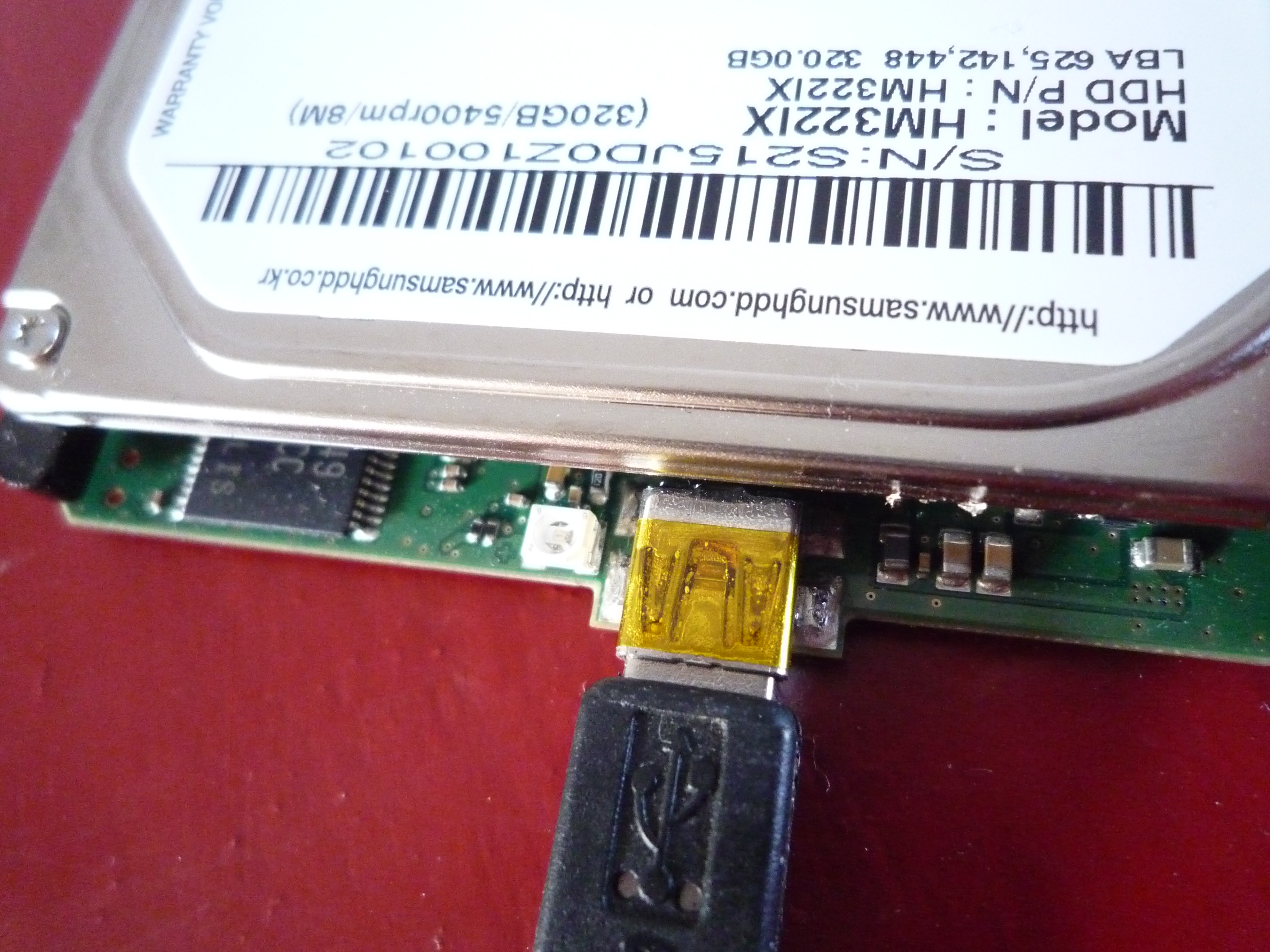

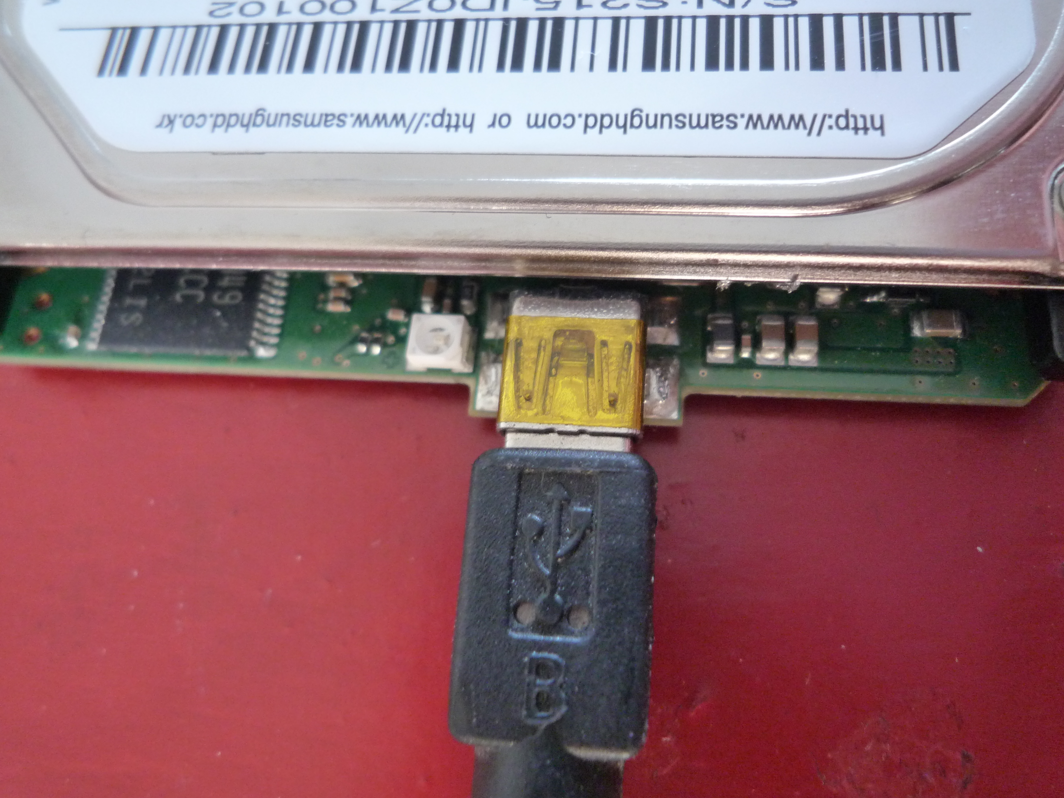

I have an external harddisk, it's a freecom xxs 320GB with a samsung disk in it. Probably the USB connector is failed but it's soldert at the PCB! Is there a check for it?
I did some tests with different USB cables and operating systems (Windowx xp, ubuntu 12.10 and mac) and nothing works.
I hope you have some tips,
Thanks Christian

In the past there where troubles with the disk, only if you turn him on a side he makes the connection
This can indicate a loose(dry)solder of the USB connector,
which can be Corrected by reflow /resolder of the connector .
But you will need some basic tools as well as some soldering experience.
Take help from someone who is confident to take up the job.
You can also magnify the area around the connector to check and post a pic.
But remember, this will be a easy job for a pro ,without any risk for your data, and also not costing you much.
So if data is important, take pro help, because DIY attempts can make matters worse and compromising your data.

Back home i connect the external disk to be sure that my description about the problem was right. I made a mistake to said that the disk is spinning up beceause it's not.
So the problem report is now:
- My brother reports that he have had some problems with the disk, he only makes contact when you hold the disk on a side
- After a while, the disk didn't do anything so my brother asked me to fixed (thanks brother :)
- The disk is not spinning up, and did nothing...
- I tried with different USB cables, different computers/ laptops and different operating systems
- The USB connector is soldered on the PCB board (later i post a picture beceause the battery is empty)
Christian

Looks like you have a faulty PCB, did you try new PCB ? I`m not sure if those models are using only one firmware version so straight PCB swap should work.

Post a pic of your PCB (component side) and check if the connections from the USB connector are proper.(Before thinking of converting USB to SATA)

Here are 2 pictures
