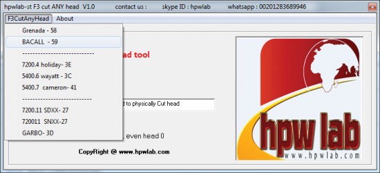

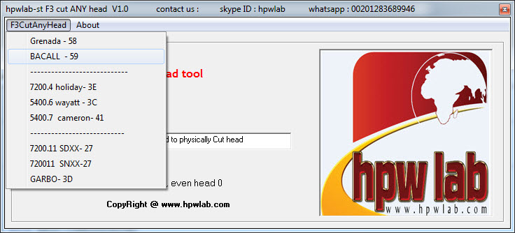

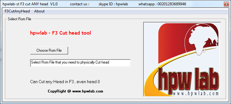

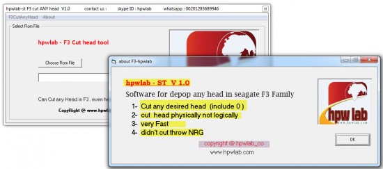

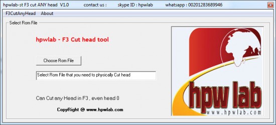

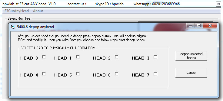

hello all
after Detailed study in Seagate Structure
now we are able to depop any head in F3 Seagate
and we built tool that support cut any desired head physically
even head 0

this tools is for Repair issue ,
but also you can use for head map arrangement , and this function is good for recovery
some F3 use physical map , not logical map ,by mapping bad head you can recover data from good heads , this is need imager to image data
but again tool is for repair , not for recovery
http://www.hpwlab.com
