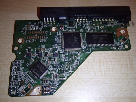

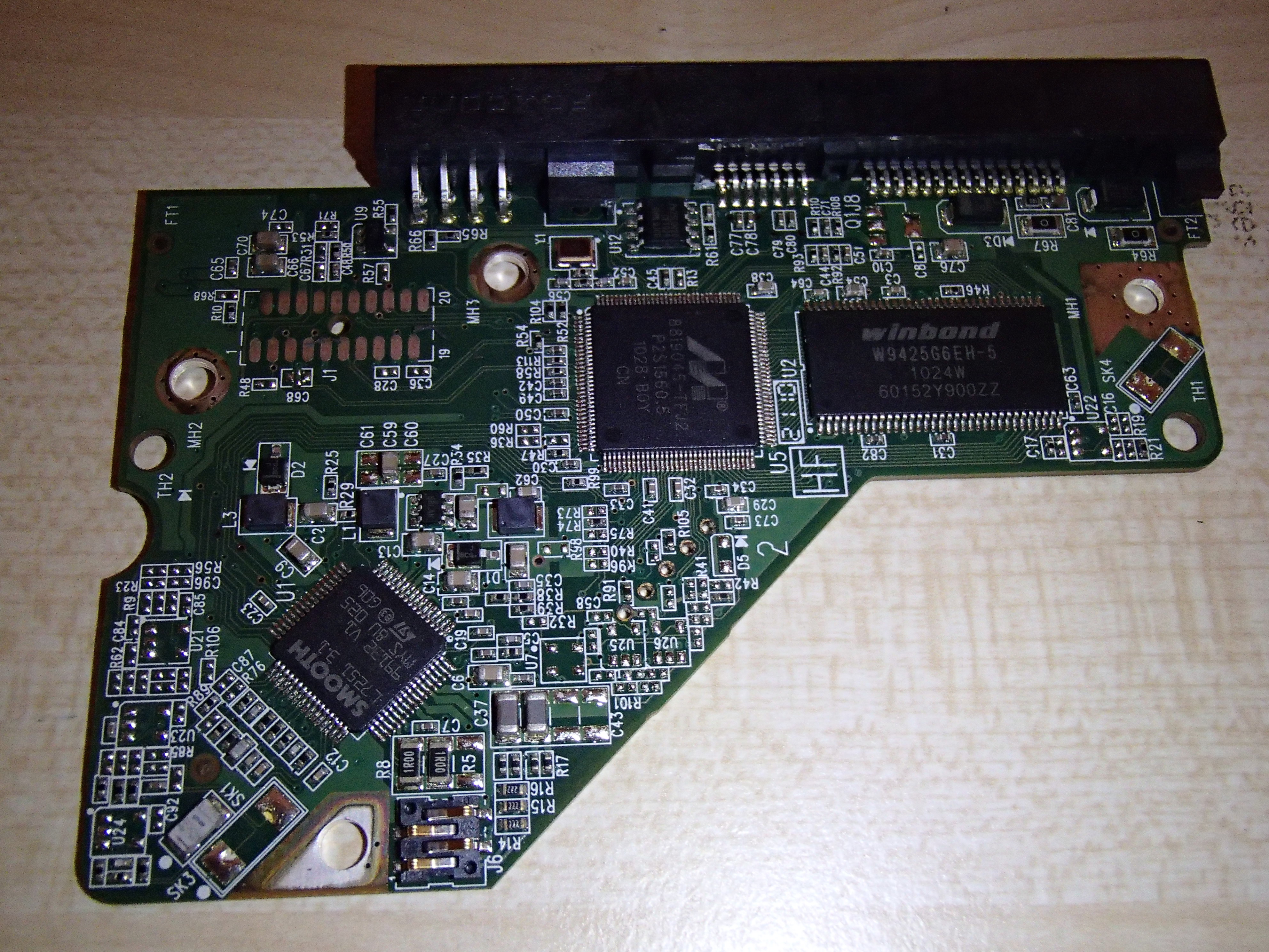

I need advice for WD5000AADS-00S9B0
I try hot swap from donor to patient drive with DFL-WDII. It look everything fine, but I found, that when I turn off everyting and turn ON, that PCB is no longer detected by tool.
Any advice to realive PCB.
thank you for any suggestion
jure
[img]
[/img]
[img]
[/img]

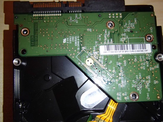

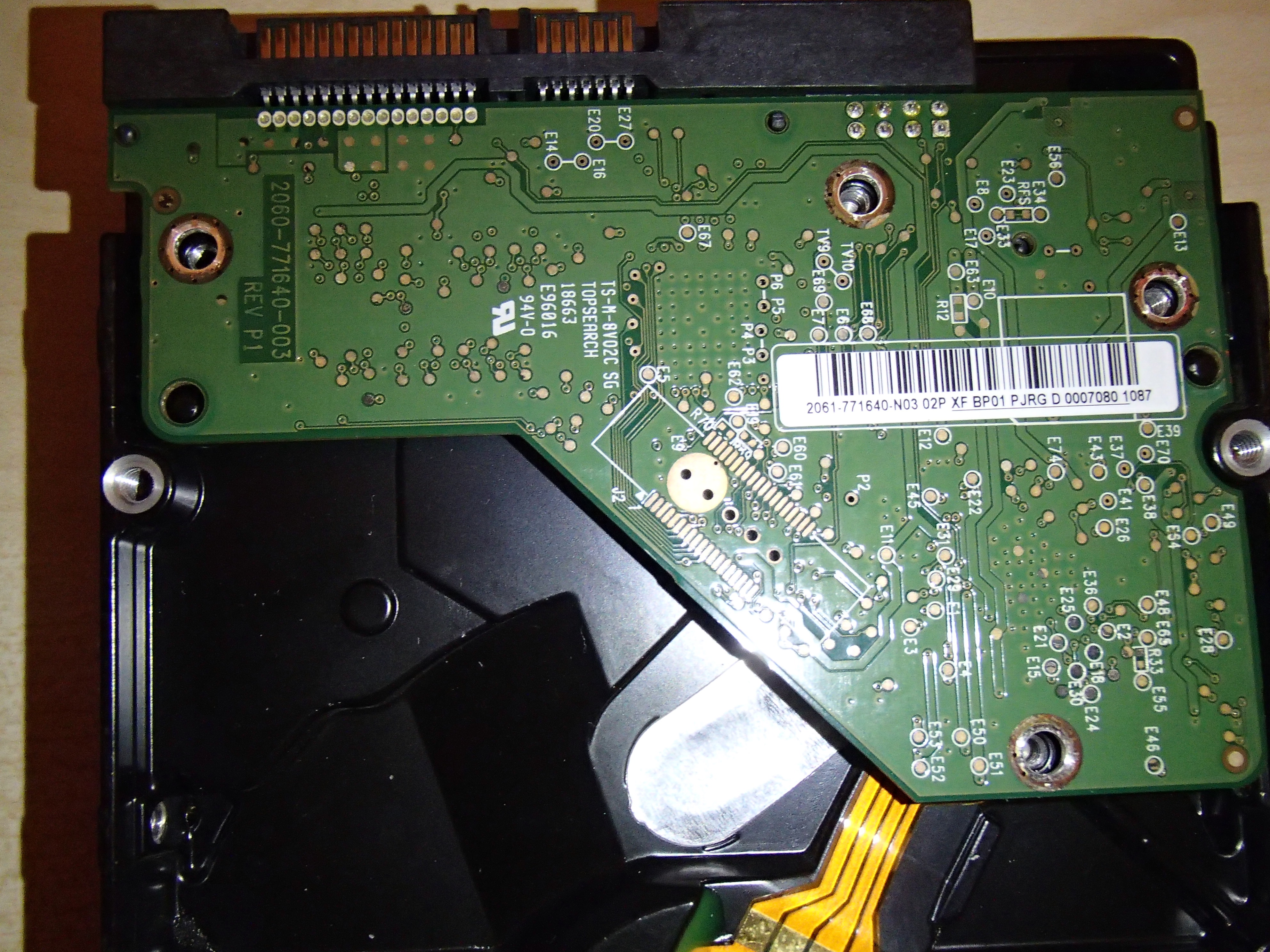

Thank you Spildit,
I receive drive from someone, and he need data from that drive.
History of patient drive is:
That person move PCB from WD5000 to WD20, because, he thing, that he will fix problem with 2TB drive
When he return PCB from WD20 back to WD5000, WD5000 doesen't work anymore. He realize, that he make a mistake.
Then he send drive to me. I connect drive to DFL, and see, that drive doesen't spin at all.
So I swap PCB from donor to patient and try with DFL. Drive spin up with donors PCB.
After that I return PCB to donor drive and test it, if it works and everything was OK.
Then I process with hot swap.
Now I waiting for new donor drive.
Any suggestion or question
Below are specification of donor and patient drive
MDL: WD5000AADS-00S9B0
WWN: 50014EE10322E514
DATE: 26 FEB 2013
DCM: HHRNHV2CE
DCX: 2008SAT91
R/D: 771640
PCB: 2060-771640-003 REV P1
ORIGINAL
WWN: 50014EE204CDBB0E
DATE: 23 JUL 2010
DCM: HANNHT2AGB
DCX: 0003S8T94
R/D: 771640
THAILAND
 Post subject: Re: WD5000AADS-00S9B0 not detected
PostPosted: March 19th, 2013, 10:07
Posts: 396
Location: slovenija
Hello
I connect both PCB's(donor and patient) to DFL and SD tool in safe mode. DFL is able to read patient's ROM, SD reports error when I try to read ROM.
Donor's ROM is not detected with any of tool.

Hello HDDGay,
customer swap PCB from working WD5000AADS to faulty WD20EARS. After he swap back, WD5000AADS become also faulty.
My work was only with two mentioned donor and patient drives.
I asking, if is possible, that in my case ROM on my donor's drive bocome corruped, and if I unsolder rom and flash it, could this solve my donor drive to become alive.
BR Jure

Posts: 396
Location: slovenija
Dear Nortwind,
I will try to short everything, and if you have any advice, please
1. I turn on donor drive connected to device
2. put donor drive to standby
3. swap donors PCB to patient drive
4. spin up patient drive with donors PCB
5. write mod 11
6 turn off everything
When I try to repeat all steps, donors drive was no longer deteced. Something is wrong with PCB
So I asking, if is any way to try to repair this donor PCB
I hope, that is now more clear everything :)
BR
Jure
