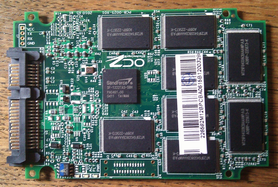

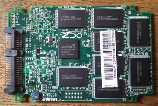

I've got a similar OCZ 120GB Vertex 2. When in DDI it is stuck in Busy, & can't ID the drive.
The controller chip is as follows:
Sandforce
SF-1222TA3-SBH
PAC461.00
0411 Taiwan
As such encryption will be on by default so removing the NAND chips is not much use. Does anyone have any suggestions? I'm currently testing the components on the PCB to see if there are any obvious failures.
The quality of the image attached is not great, if need I can take more focussed picture.
All the best,
John

If you would like to verify the onboard supply voltages, then could we see a detailed view of the underside?
Did you measure anything at the Vcc terminal of the Tx/Rx header?
Do any of the three LEDs light up (ACT, FLT, PWR)?

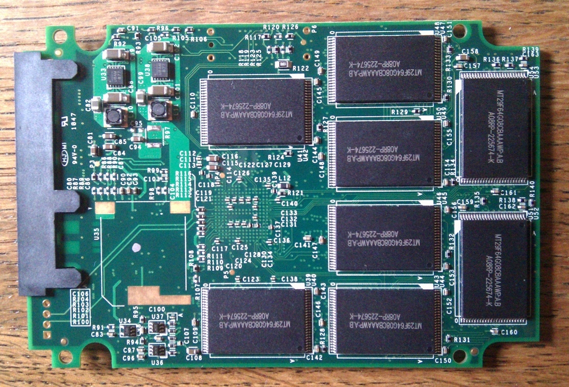

Attached is jpg of the underside:
I haven't had chance to check the electronic components as a couple of emergency jobs have come in this morning. Once I have I will post the results.

ISTM that the supplies are probably OK.

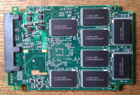

The Vcore and Vio (+3.3V) test points would be the two coils, L10 and L11, in the top left corner. Measure the load side, ie the plated through-holes at C82 and C99.
I can't see the markings on U33 and U38, but they would be the PWM regulators.

I have the exact same drive and voltage at L11 / C99 is 0.9V, the voltage on L10 / C82 is 2.8V.
I have a short on D2, but it's not the diode itself, if I remove the diode, the short is still there and the diode itself works fine.
Does anyone have a schematics?
Any idea on how I could recover this?
