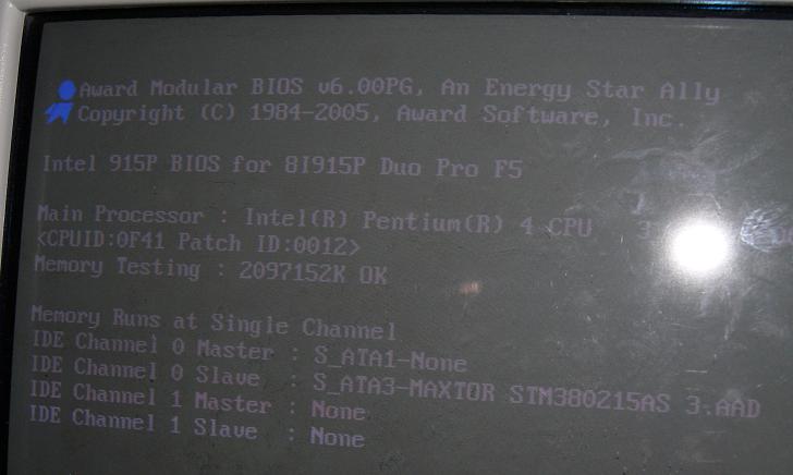

Continue testing About BIOS:
If power up SSD and when them short pins 2-3, Green diode is ligthing and Red diode is ligthing
too. and no BIOS info

 Post subject: Re: OCZ Vertex 2 240GB SSD for recovery
PostPosted: April 18th, 2013, 15:26
Posts: 815
Location: World

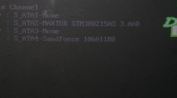

BUT, (and here is the GOOD NEWS!) when i short pins 2-3 and them power up SSD the green diode is ligthing but Red diode not ligthing
them if i not short SSD only green diode continues ligthing. and YES, there is BIOS info.!!!!!
is recognized by BIOS As SandForce!!!!
PostPosted: April 18th, 2013, 15:31
Posts: 815
Location: World
Do you think i can upgrade FW in this situation?
Thaks.
PostPosted: April 18th, 2013, 17:25
Posts: 14945
AISI, shorting the EEPROM after the controller has powered up is inconclusive, and perhaps pointless. I could be wrong, but AIUI, the controller looks for the EEPROM and then downloads the EEPROM's code into the controllers's internal SDRAM. The controller than transfers control to the SDRAM code. After this happens, the EEPROM is no longer accessed by the controller, so shorting its pins would have no effect.
Instead you need to short the pins before powering up, as you have already discovered. Power-up is the time when the controller is looking for the EEPROM. When the controller doesn't find the EEPROM, it reverts to kernel mode, in which case it would be running on its own internal bootstrap code.
Your test proves that the controller is not being reset by the POWR607 supervisor IC, so the 2.8V supply voltage may not be a problem now, although it may have been a problem in the past.
