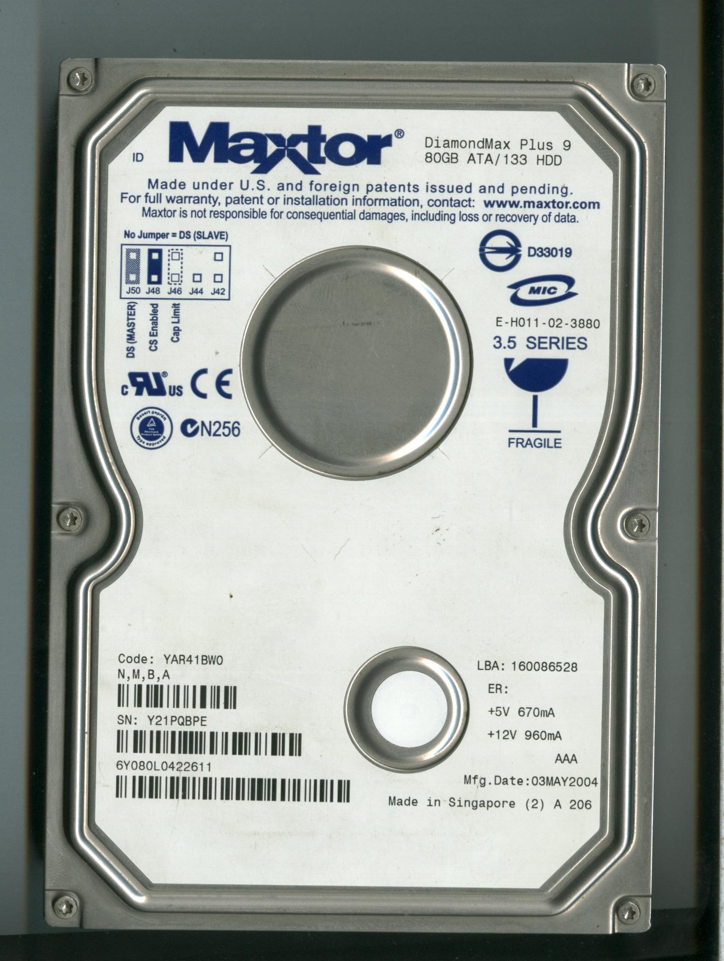

i have maxtor ide hard disk . one of the chip on its pcb burnt. and i replaced the logic board with another one . the snap of harddisk is attached. the replacement board was from same harddisk. though the bigger chip is made by different manafacturers. its own board had agere chip and the new one is ardent ..

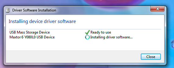

i tried it through usb to ide converter and here is the screen shot attached and windows 7 would give error in installing the driver .

now if i hunt for new logic board what should i consider to be matched looking at the images below. and what else can i do ?

File comment: windows 7 detects it if connected through usb to ide converter and fails in installing drivers
File comment: the picture of the hard disk .

Can you recognise your PCB in the following photos?
Maxtor DiamondMaxPlus9 160GB HDD hires PCB photos:
http://malthus.zapto.org/viewtopic.php?f=112&t=117
Maxtor DiamondMaxPlus9 200GB HDD hires PCB photos:
http://malthus.zapto.org/viewtopic.php?f=112&t=102
Can you recall which chip was damaged?
 Post subject: Re: Maxtor IDE 80 GB ic on pcb burnt, replaced board ,
PostPosted: April 22nd, 2013, 2:44
Should be fairly easy on this model.
Although sometimes they have am extra ROM at U401, which you want have as you don't have the original PCB.
