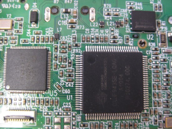

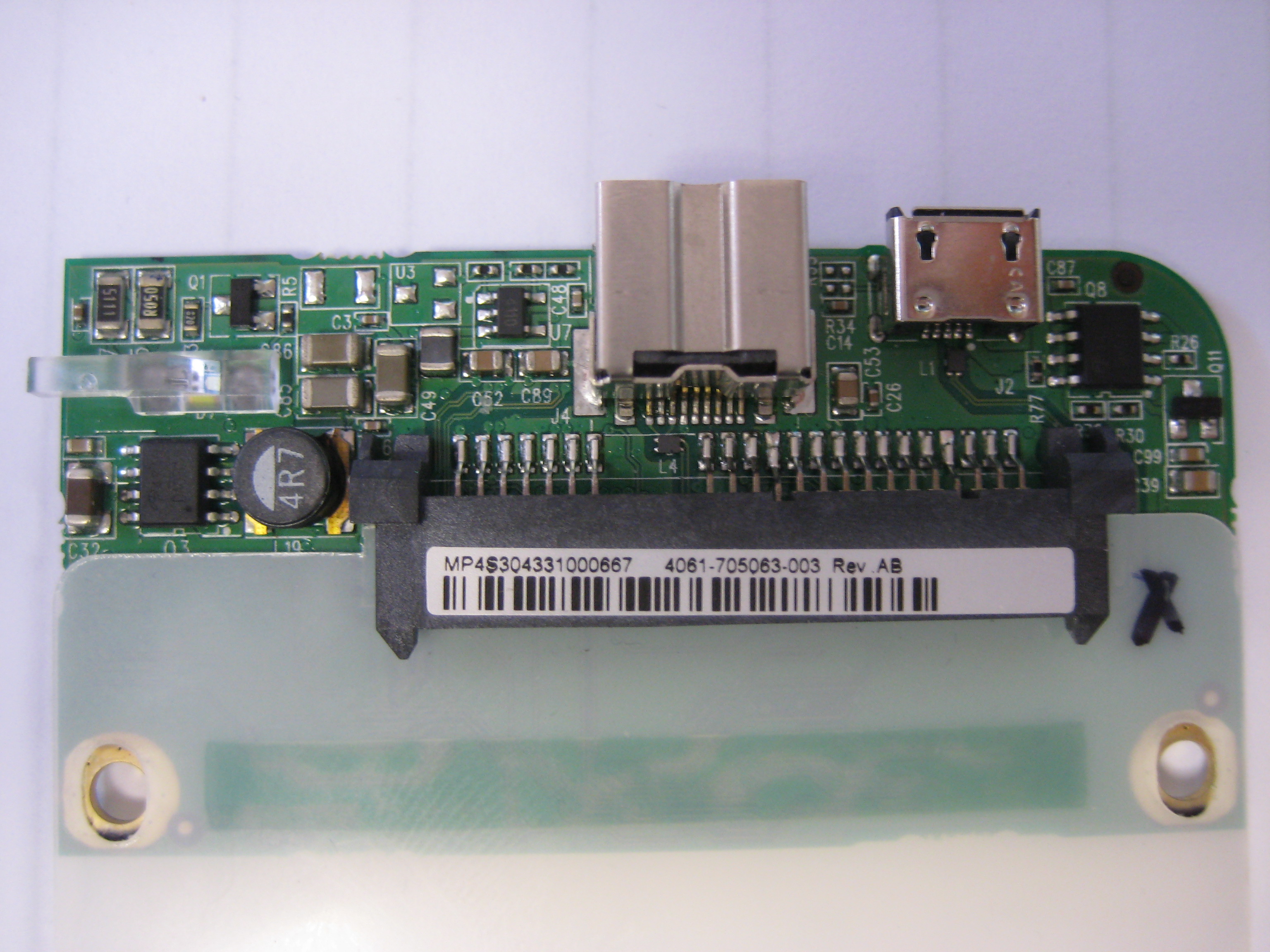

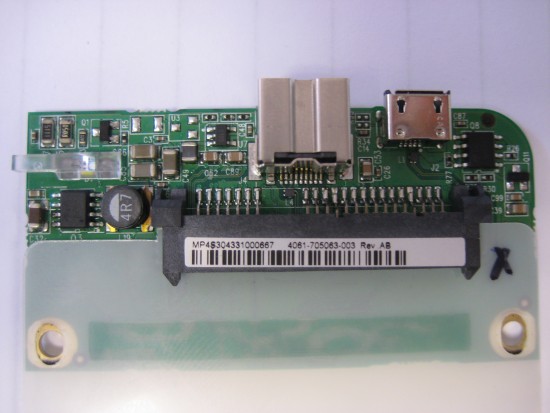

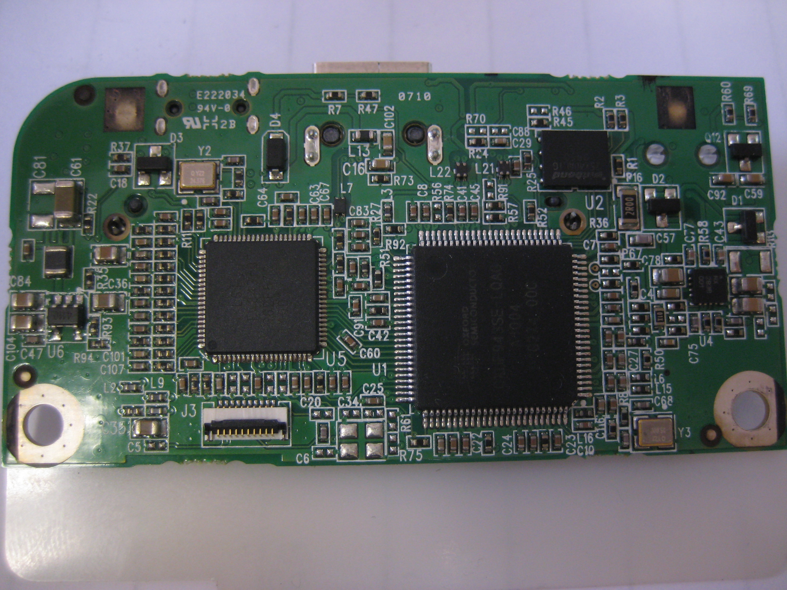

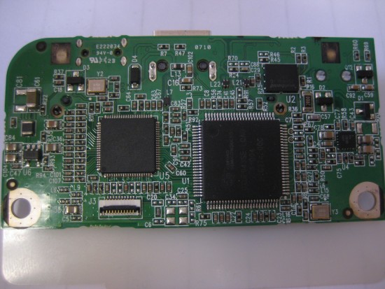

Thank you for your attention. In this case we can see no visible damage to the drive. Yes, we tried using the USB port and device was not recognized at all.
Pictures of the damaged board attached. The other (donor) board looks physically identical except for the controller part number and revision code.

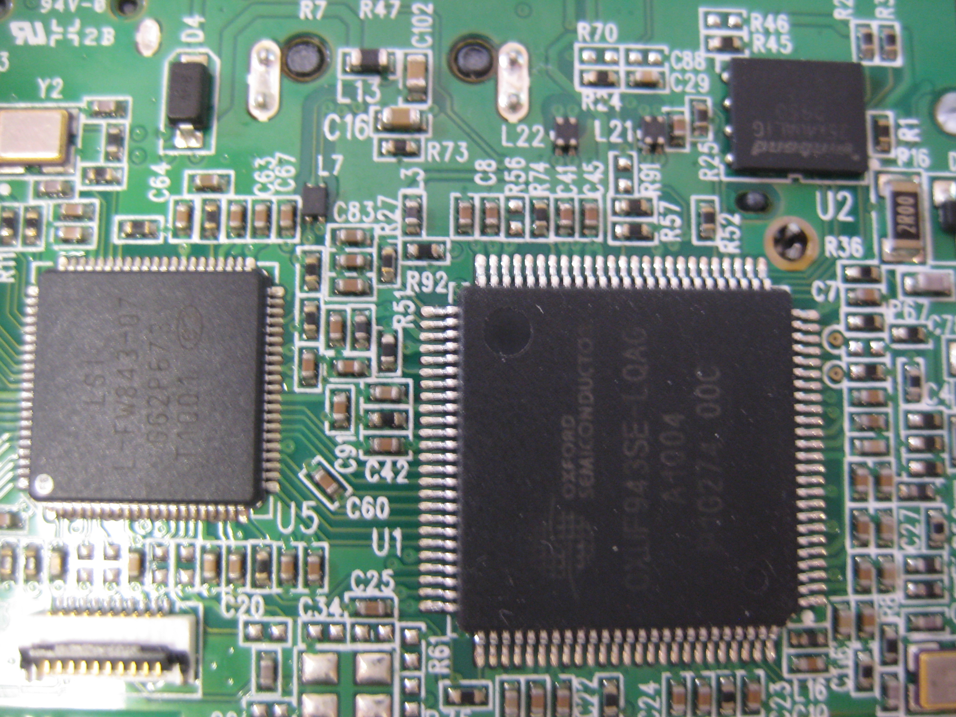

fzabkar, thank you for your comments but I don't see a TI chip. I attach a close up of the main chip markings: the OXUF943SE-LQAC controller apparently combines FW, USB, SATA and encryption. http://www.plxtech.com/products/consumer/oxuf943se But then I don't see why they needed the LSI FW843 chip, which is also apparently a FW800 controller?

I wasn't able to read all the chip markings, but AFAICT there is a 5V switchmode regulator consisting of Q3 (AO4840), a 4R7 coil (L19), and U4 (NX2838DS). I'm guessing that this regulator is only needed when the drive is powered from the Firewire port, otherwise the power is provided via USB.
Q8 (AO4425) is a MOSFET. I suspect that it switches +5V power to the drive's SATA power connector under control of the Oxford bridge.
U7 and U6 apear to be 3.3V regulators, possibly switchmode, although I can't positively identify their associated coils. They look like NX4110 parts.

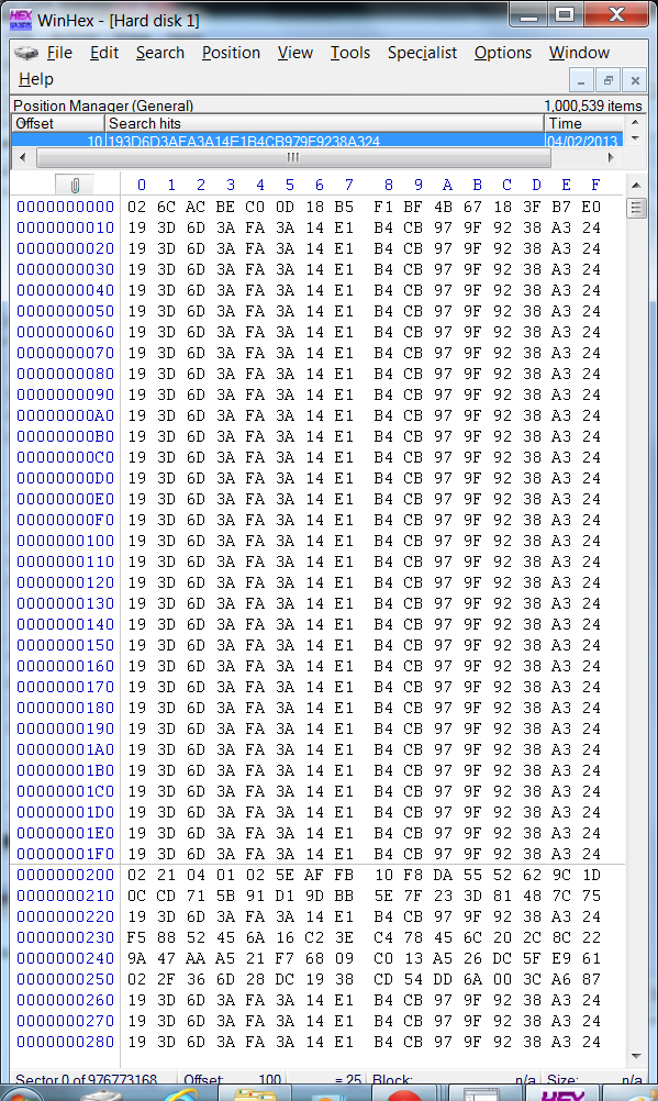

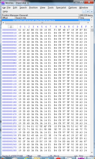

I just took another look at the data area of this drive and noticed something very strange. This drive does not have a user password, so maybe it would be different if a password were in use.
Some sectors (which i assume are sectors that have never been written to) are all zero. Others (especially the header sectors) contain exactly the same pattern of 16 bytes repeated over and over (it occurs over a million times in just the first 400,000 sectors). It appears that zero bytes, regardless of which sector they occur in, have been replaced by this same 16 byte sequence!
My understanding was that hardware disk encryption should vary the encryption key for each sector but this does not seem to. Instead the same encryption appplies to every sector. Perhaps it is not really encrypted but simply a quick substitute cipher?
Of course anything more complicated than a simple XOR would still be hard to figure out without knowing the exact algorithm used.

AIUI, 128-bit AES encryption applies the same encryption key to each group of 16 bytes (= 128 bits) throughout the entire user area.
When the drive is manufactured, it is first zero-filled. It is then placed inside the enclosure and partitioned and formatted via USB.
No
These drives use AES256 or AES128(less common) encryption in ECB mode. AES ECB is the basic implementation of AES encryption algorithm where data is divided on 16-byte pieces and encrypted with the same key w/o any further modification.
That's why you see this pattern. It's "decrypted", zero-filled unoccupied drive space.

I'm sure, you already done that, but, did you checked this burnt board for blown fuses, zero ohm resistors, torn inductor coils?
Does ICs on the board powered with correct voltage, and ground pins still connected to the ground? Is they abnormally hot, while board is powered?
On a first foto i can see some DC/DC converter IC with it's coil and diode on the other side. If it so, is it working correct?
Maybe, it will be more easy to repair this burnt board (if it possible), instead of trying decrypt the data with the good one?

Could it be that the FW843 chip was the only culprit and that the Oxford bridge is hanging while looking for it?
If you examine the firewire pinout, a connector reversal would apply power to the FW843 signal pins.
