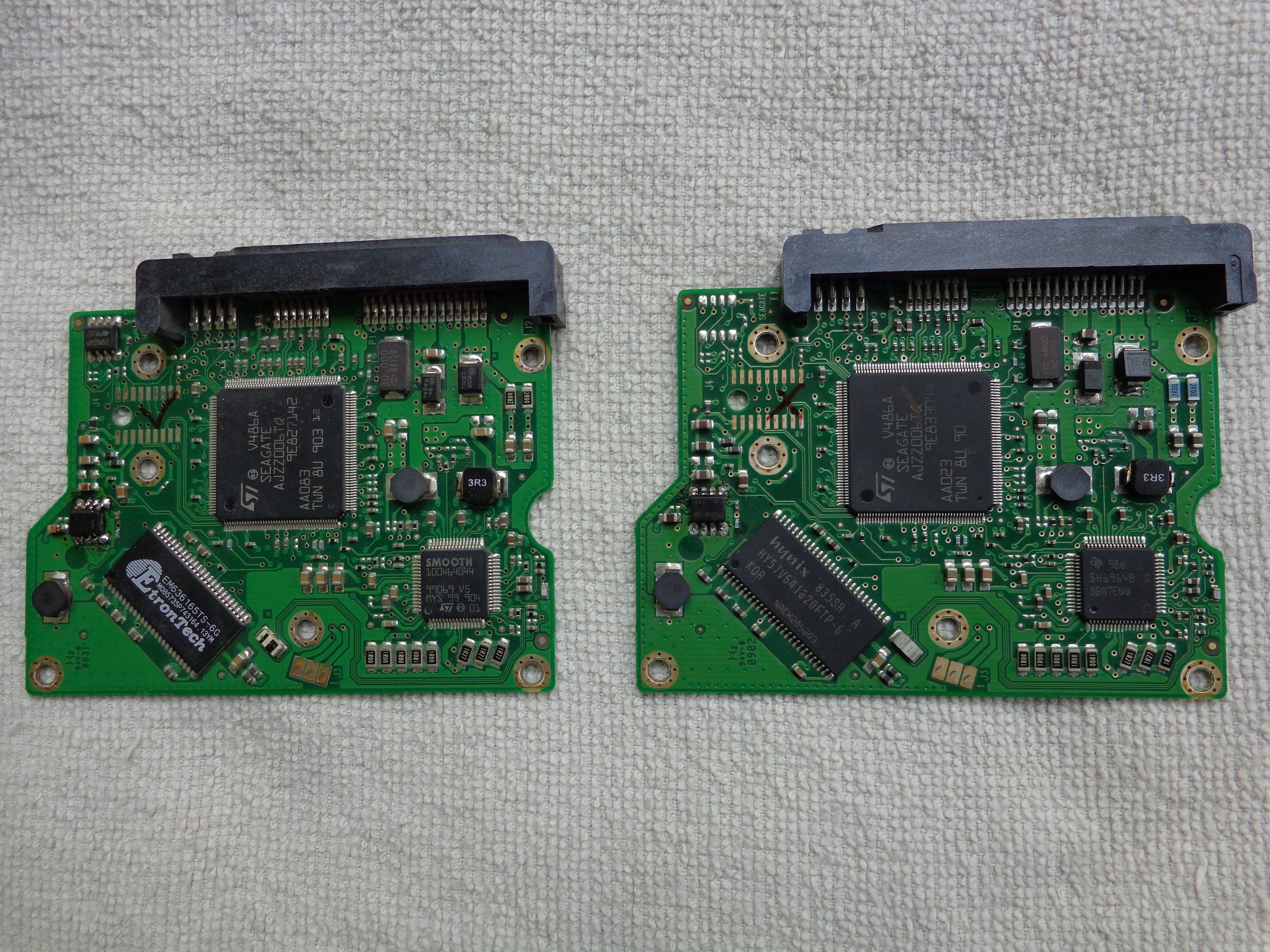

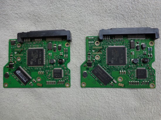

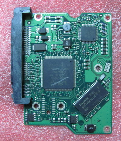

Hi Everyone
Model : ST3160215AS
P/N : 9CY112-313
FIRMWARE : 4.AAB
received the customer from not working (dead condition)
unscrew the pcb but not find out the ROM IC
same mode, p/n, & firmware is my hand - that's available in ROM IN.
 Post subject: Re: WHARE IS ROM IC?
PostPosted: March 30th, 2013, 17:27
Posts: 17311
Spildit wrote:
ROM is the marked chip on attached picture.
I don't think so. That looks like the PWM controller for the negative preamp supply. The adjacent coil is the clue that it is part of a switchmode supply.
What are the markings on the IC?
See my HDD IC database:
http://community.wdc.com/t5/Desktop-Por ... d-p/523950
I suspect that the MCU has embedded ROM, and that the vacant location at the top left of the PCB is reserved for an external flash memory.

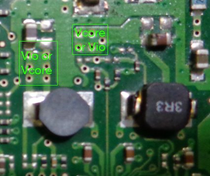

If you would like to measure some voltages, I believe these are the Vcore and Vio test points.

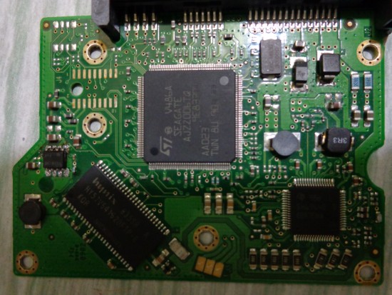

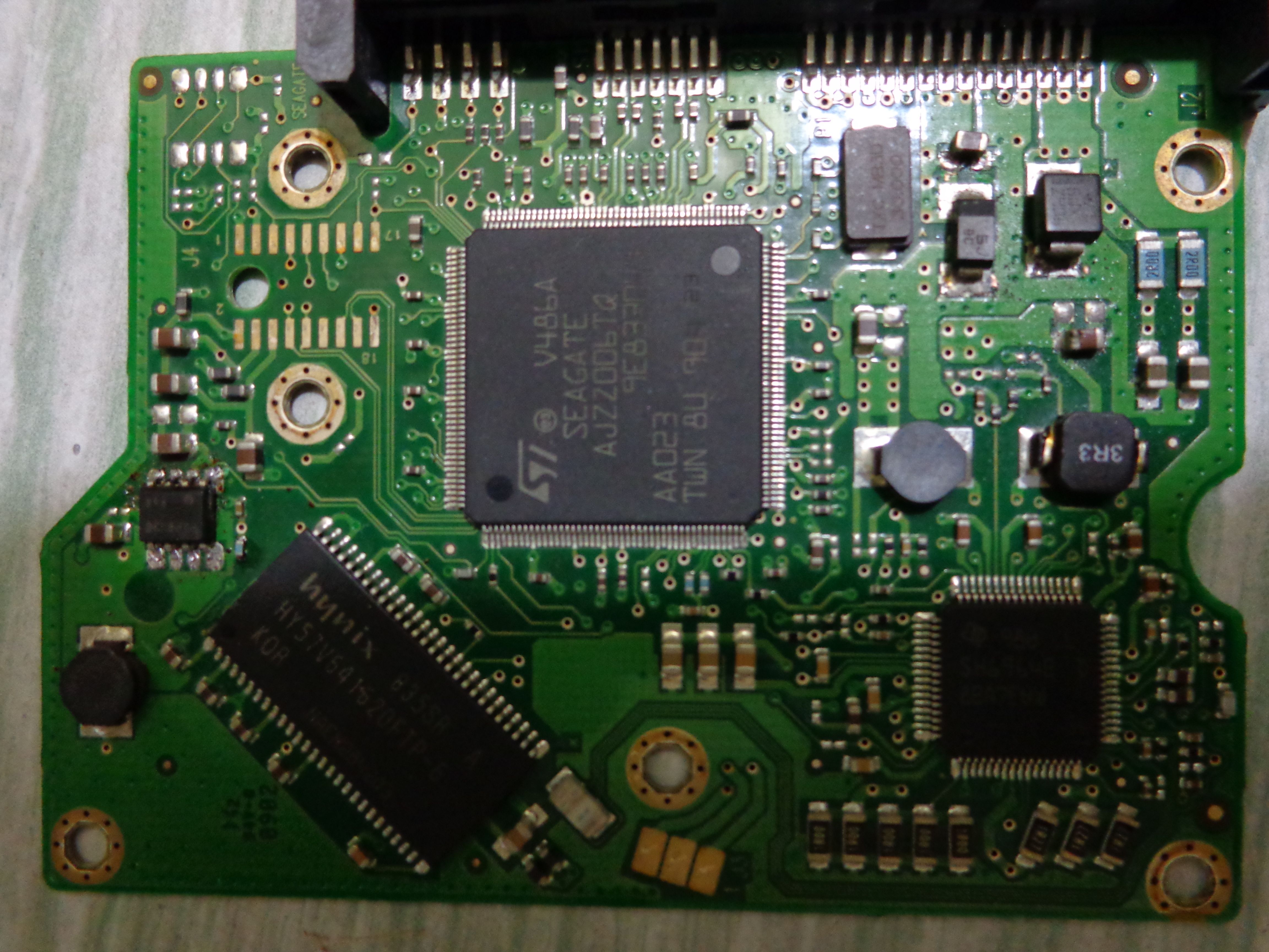

PostPosted: March 30th, 2013, 22:58
Joined: October 12th, 2012, 11:26
Posts: 24
Actually, the IC could be a FETKY (MOSFET plus Schottky diode). The PWM control would then come from the motor controller.
Thank for all replays,
i bought it customer from dead condition & i connect system immediate shutdown.
so remove it 2 TVS diodes.
After remove diodes connect system - SYSTEM ON
but not response in pcb & media.
so immediate got DONOR PCB (same model, p/n, firmware & pcb no), but i can't find out ROM IC.
fzabkar, what is that problem in defective PCB
Thank you for advance...

Spildit wrote:
shahij wrote:
I guess Original ROM is missing. You should ask if he took the drive to someone else before u.
I agree !

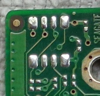

ROM IC should be here :
(Unless PCB have MASKED ROM on MCU).
I think that someone might have taken the ROM IC.
The ROM's support components (pullup resistors, supply bypass capacitor) are not populated. Therefore, AISI, the board has no ROM.

The following board looks similar but has an LSI MCU. It comes in "with ROM" and "without ROM" versions.
http://www.drivestar.biz/seagate-100470387-p-193.html
http://www.drivestar.biz/images/pcb_st/100470387.jpg
Seagate Barracuda 7200.10 SATA
Number of Board: 100470387
Number of Main Chip: 100404226
Number of Motor Chip: SH6964B D
With ROM Chip / Without ROM Chip
