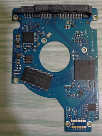

hi everyone,
Model : ST9500325AS
F/W :0002BSM1
CAPACITY : 500 GB
pcb doesn't response, dead condition.
circuit brake or locked?
please help me.
Thank you advance
Aravind

Spildit wrote:
Ok, if you plug the drive to the power (PSU) does the PSU shuts the entire system down ?
If you place paper/plastic card insulating the contacts to the Head Assembly, (but leave the spindle ones) does the drive spins ?
Do you have tll adaptor ? Can you post a terminal log with PCB on and power up the drive ?
Does it spins ? Does it clicks ?
Thank you Spildit,
if the power supply connect the media no response, system power on
not responding in pcb with power
i check it terminal mode, the error saya "
ΓΏ
Notet Boot ROM 4.2
Copyright Seagate 2008
Serial FLASH boot code checksum failure!
Boot Cmds:
DS
AP <addr>
WT <data>
RD
GO
TE
BR <divisor>
BT
RET
