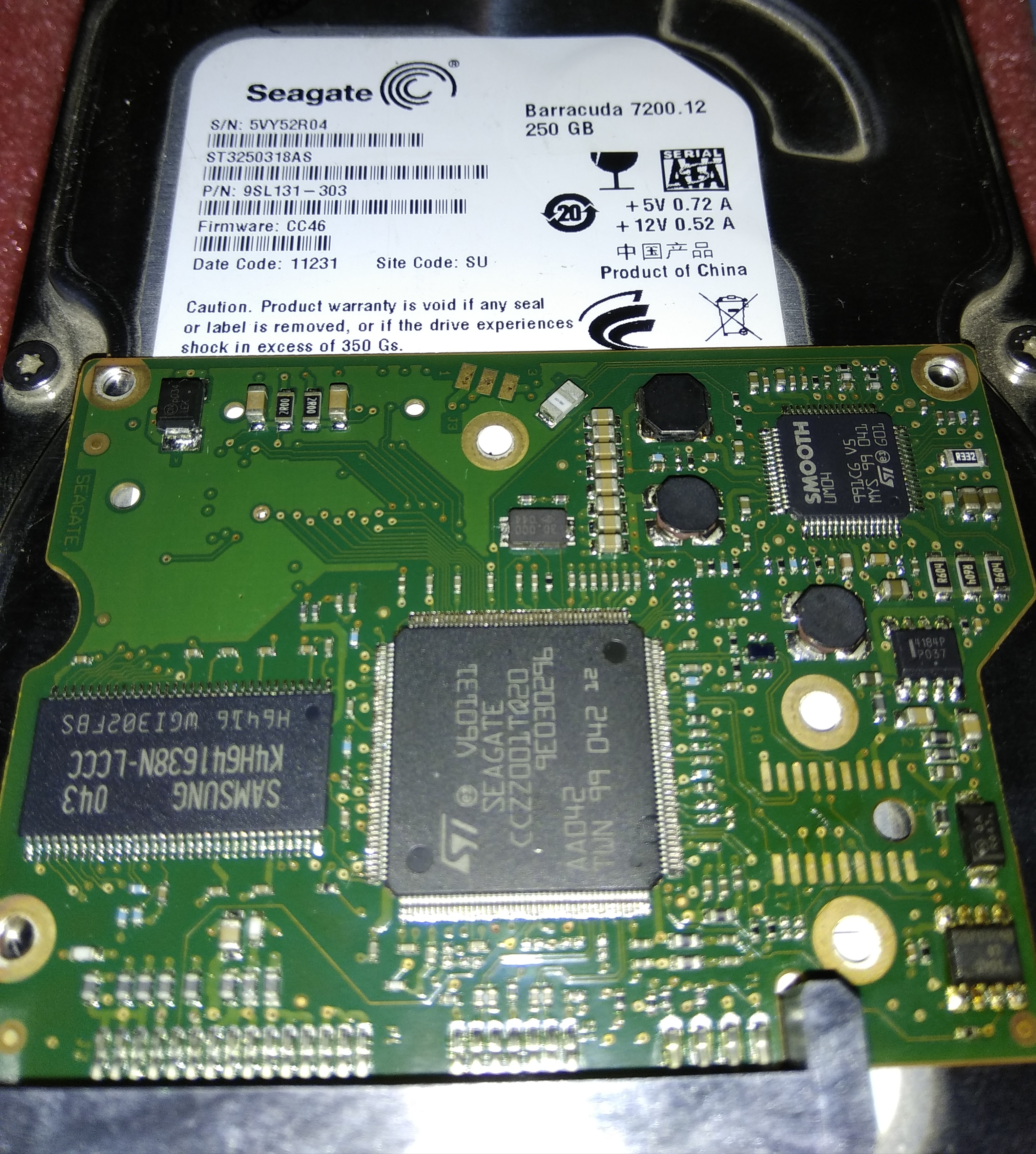

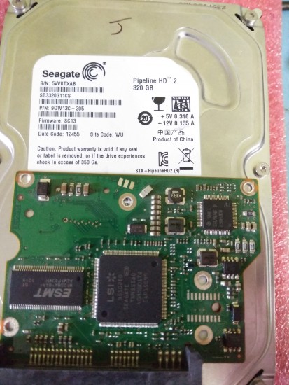

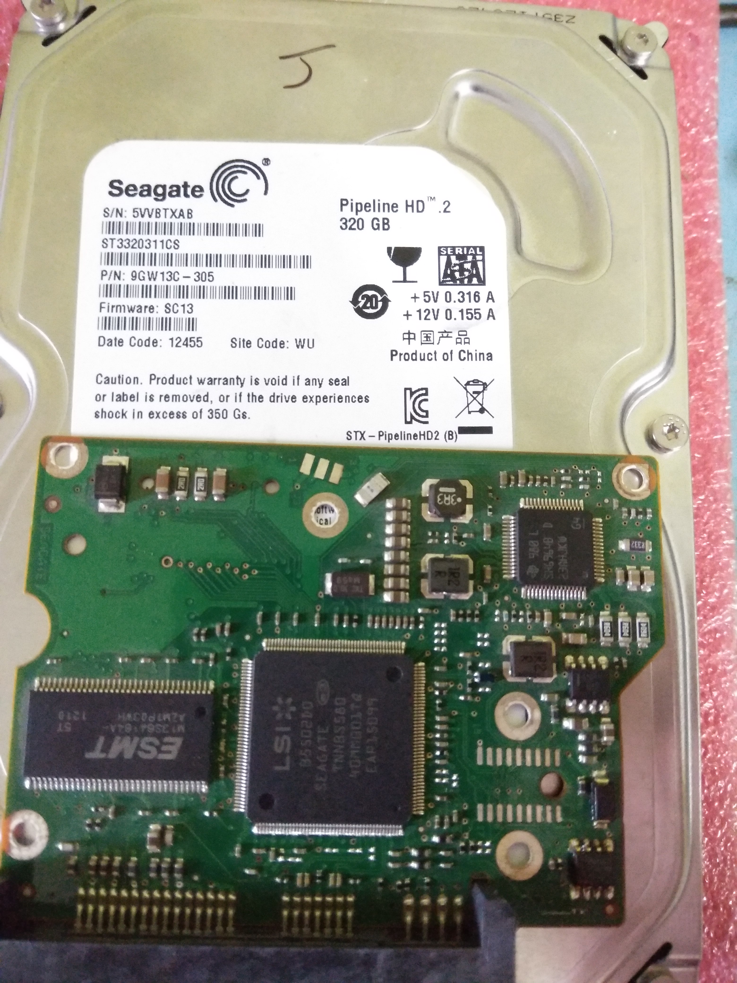

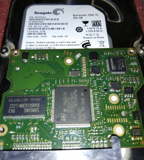

Please see attached images of the hard drive along with PCB images. The good drive is amongst the drives a customer did an exchange for a higher capacity drive (upgrade).
File comment: Good Drive
File comment: Bad Drive

pcdoc wrote:
Is this a pcb problem? Will baracuda's pcb work as the pcb number is same? I can swap ROM chip myself.
No, this won't solve anything, it's not a problem with the PCB,
The drive has surface damage and, consequently, problems with defect lists (G LIST) and/or sector relocation
