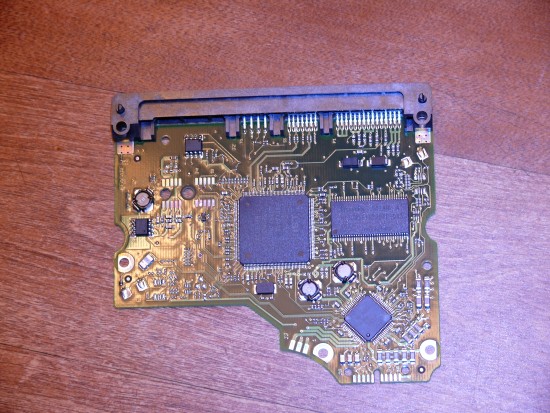

Hello everyone,
I am a newbie in HDD repair so please be indulgent :)
I have the following drive:
Seagate Barracuda LP 1TB
S/N: 9VX0E7WT
ST31000528AS
P/N: 9TN154-301
Firmware: CC32
PCB: 100536501 REV. A
This HDD was used in a Ximeta Netdisk external drive.
Whole issue started like this: as I was transfering a file to disk, left the room and got back like an hour later and file was still being transfered... I did try to cancel but it never worked so I've reboot my PC to disconnect the external drive as "clean" as possible...
Anyhow, since then it is not working anymore. I removed the HDD from the Netdisk enclosure and tried to get the data with a Universal IDE/SATA cable adapter but drive is still not being recognized by the PC. Never shows up. I see all other drives but not this one.
When I connect it, I hear it spinning, it makes 2-3 "clicks", still spins but nothing else happens... I would really like to restore the data from it...I have something like 900-950 Gb of data on this disk.... I know I should have done backups... worst thing is that I just bought myself a NAS and was about to transfer everything to the NAS to ensure such thing never happens... :x
I am really not sure if it is a logical failure or mechanical failure... any ideas how I could confirm that ??
I did remove the PCB but I do not see any damage to it. A picture is attached in case you can see something that I can't ...
Any help would be much appreciated. HELP Please !!!

 Post subject: Re: Seagate Barracuda LP 1TB unrecognized / not being read
PostPosted: April 1st, 2013, 3:58
Posts: 3551
Terminal output can help in this case.
The fact that the drive does not spin down (if I understand it right) is somehow interesting and points to f/w damage. But i'd like to see terminal on this one.
PostPosted: April 1st, 2013, 15:04
Posts: 3551
Yes it is important to understand that OP needs to just post terminal output during drive startup. And they shouldn't mess with anything else on the terminal.
Even a single one-letter command can kill the drive for ever.
PostPosted: April 4th, 2013, 12:06
Posts: 811
Location: World
Hi maximx
If your data is not important, waste the drive, because a new HDD is cheaper than recovery services.
your case is a known problem on this model and you need expensive profesional tools and experience because if not: you'll brick your HDD.
