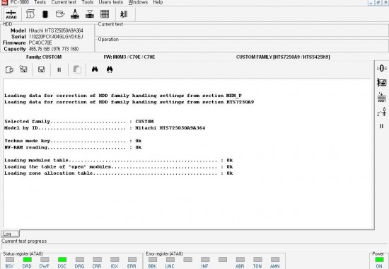

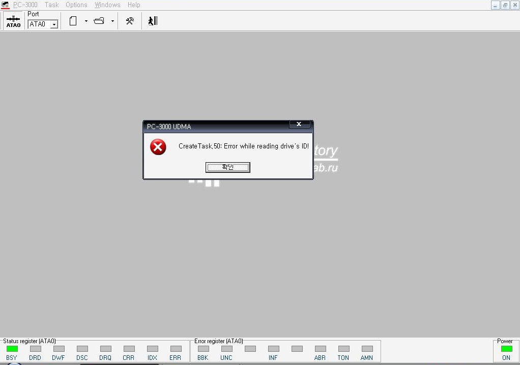

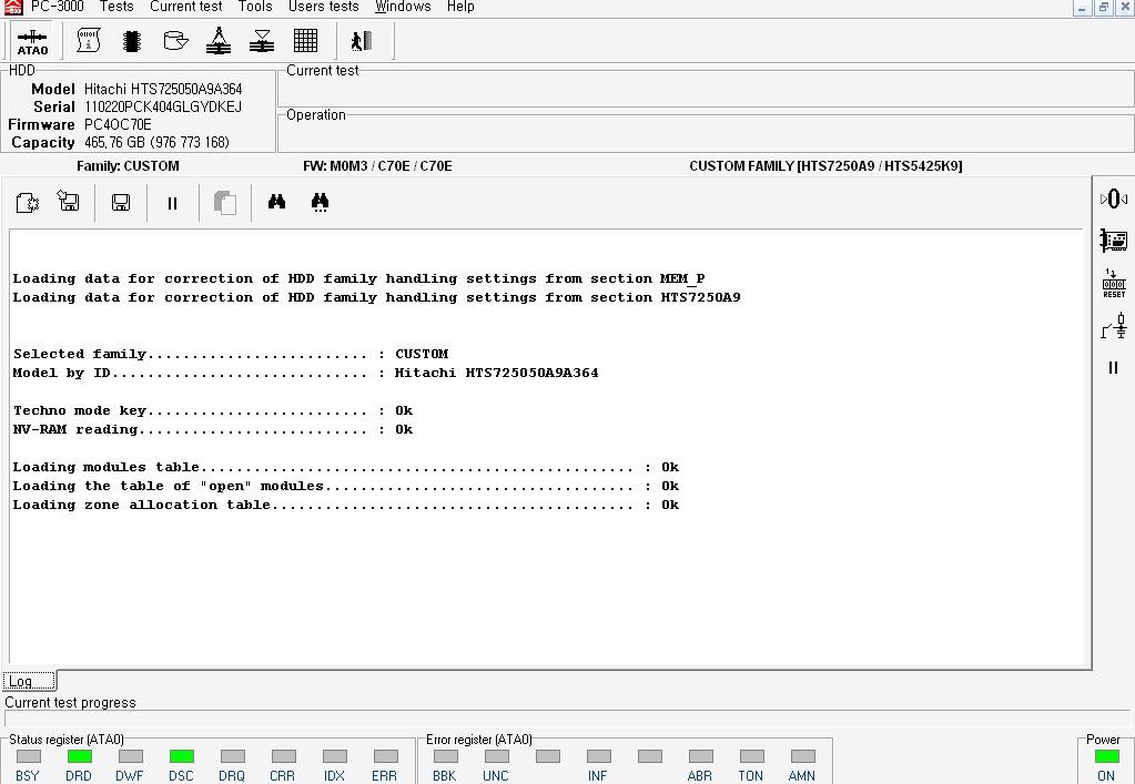

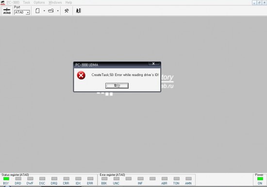

I've receive this hard drive form customer for recovery.
It's detected on PC3K very well. but Data Extracter don't read Drive ID.
Do you have any exprience in this case?
I want to know exactly what's the problem.
I've attached 2 pic for your easy understand.
please help me..
Im beginer of this PC3K.

Run SA Structure Test. Any errors?

ya..on SA Structure Test, it has some error..
but i think it's not big problem..
I've changed head stuck ...
Wow it's because of head problem.
it's detected on DE...
Thanks ...
