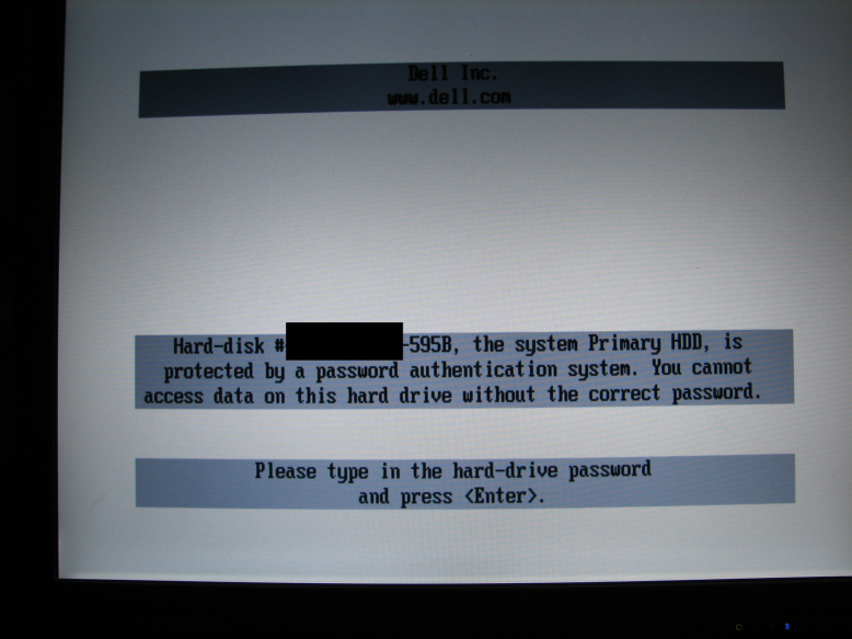

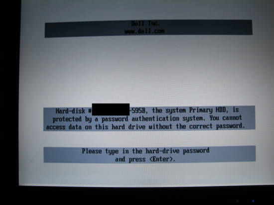

Hi. I got toshiba MK6025GAS 2.5 60gb HDD, is from defected HP nx6125 laptop, I get this disk and put in Dell Latitude D505 and then I got notice to unlock disk. I must say dell laptop has no set any bios or HDD password.
So I possible to somehow deisabled that password ?
I heard if replace firmware on HDD it will be erased password, but I got poor knowlage on this area.
Is any chance to put that HDD back in business ?
Thank you.

Some people have been successful using ZU software. Have to read around a lot and experiment.
Another thing is the "locking" state could have occurred for a number of reasons, such as:
1. the drive was purposely locked
2. the drive was never locked but a certain way of failing may cause it to show as "locked" now
etc.
All of these details are important in understanding first the problem/issue, and then and only then determining what the proper solution applies.
Sorry, there aren't any precised step by step manuals or anything like that with conventional, public available, hardware and software. There are advanced data recovery solutions that professionals specialize in and yes they are likely to easily resolve the problem for you, but it costs.
If want professional help, search for a specialized data recovery company using phone and google, get an idea of who can best serve your needs and go for it if deciding to do so.
Best wishes

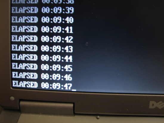

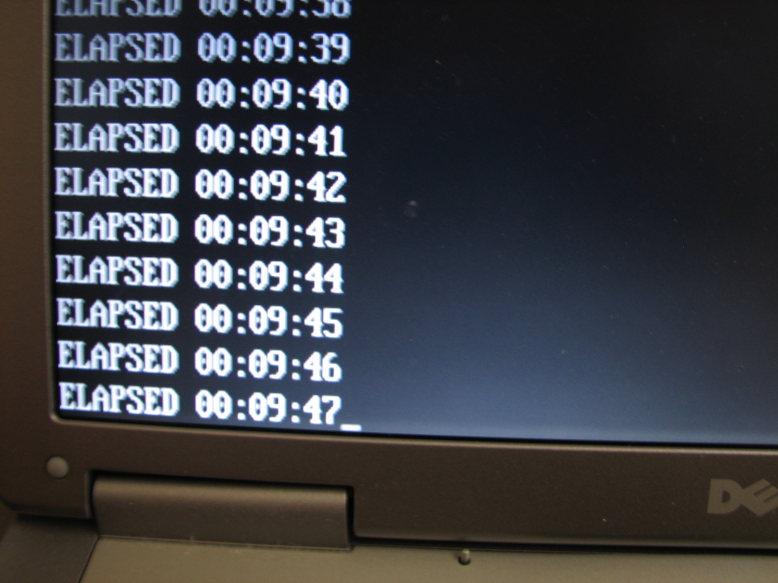

Uff final I found this zu.betta.050911 and put on USB with free dos, type cd zu, zu /P but I got feeling to can find disk or something is no OK. it just show Elapsed 00:00:01 and so on work this now about 1h
Im doing something wrong ?

there has been a more recent version
http://malthus.zapto.org/viewtopic.php? ... 6&start=20

Ou crap, I can not believe this, this HDD today not response to any thing :)
It's garbage time 100%
