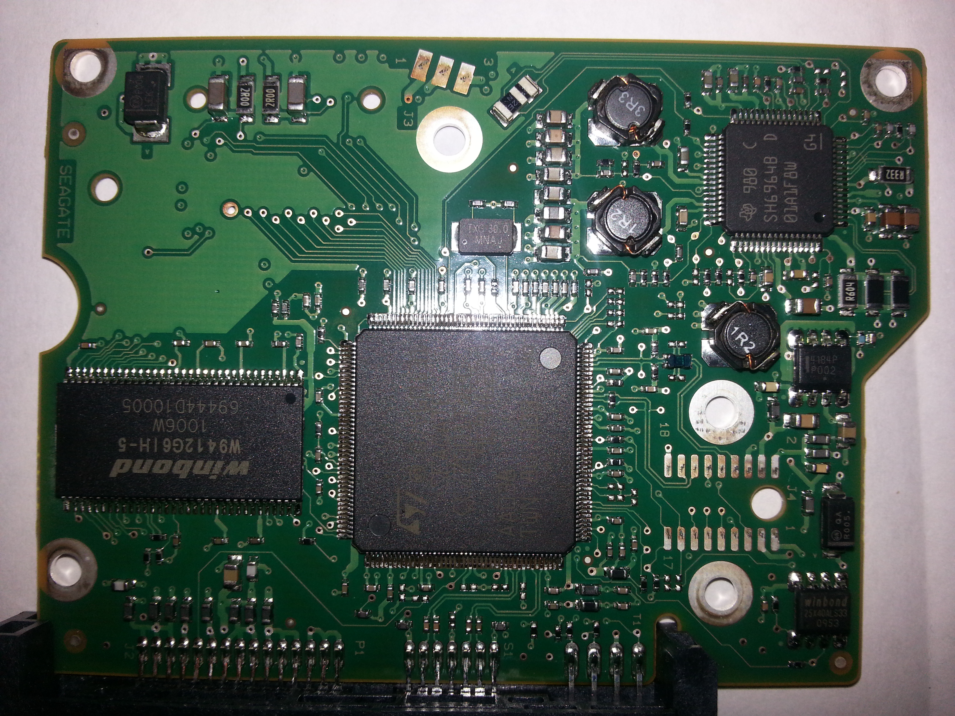

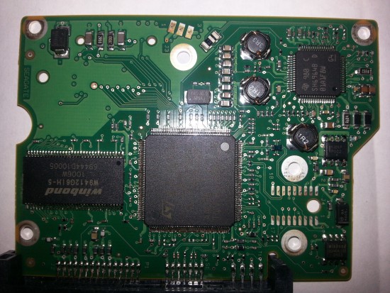

Can anyone tell me if this board should be faulty? I got it off of ebay to replace an obviously fried board ( 3 of the whatyamacallits... diodes? next to the power were fried) The two scorch looking marks on the connections to the hard drive are making me wonder if I shouldn't try and get another board because I was sold a faulty one... Or got the wrong one, I only matched model numbers. Or, perhaps the damage to the hard drive is more severe than I think... Here is a picture of the replacement I purchased.

1. They are not "scorch marks" just normal corrosion.
2. What was the problem with the original drive?
3. Why did you think that a new pcb would fix your issue?

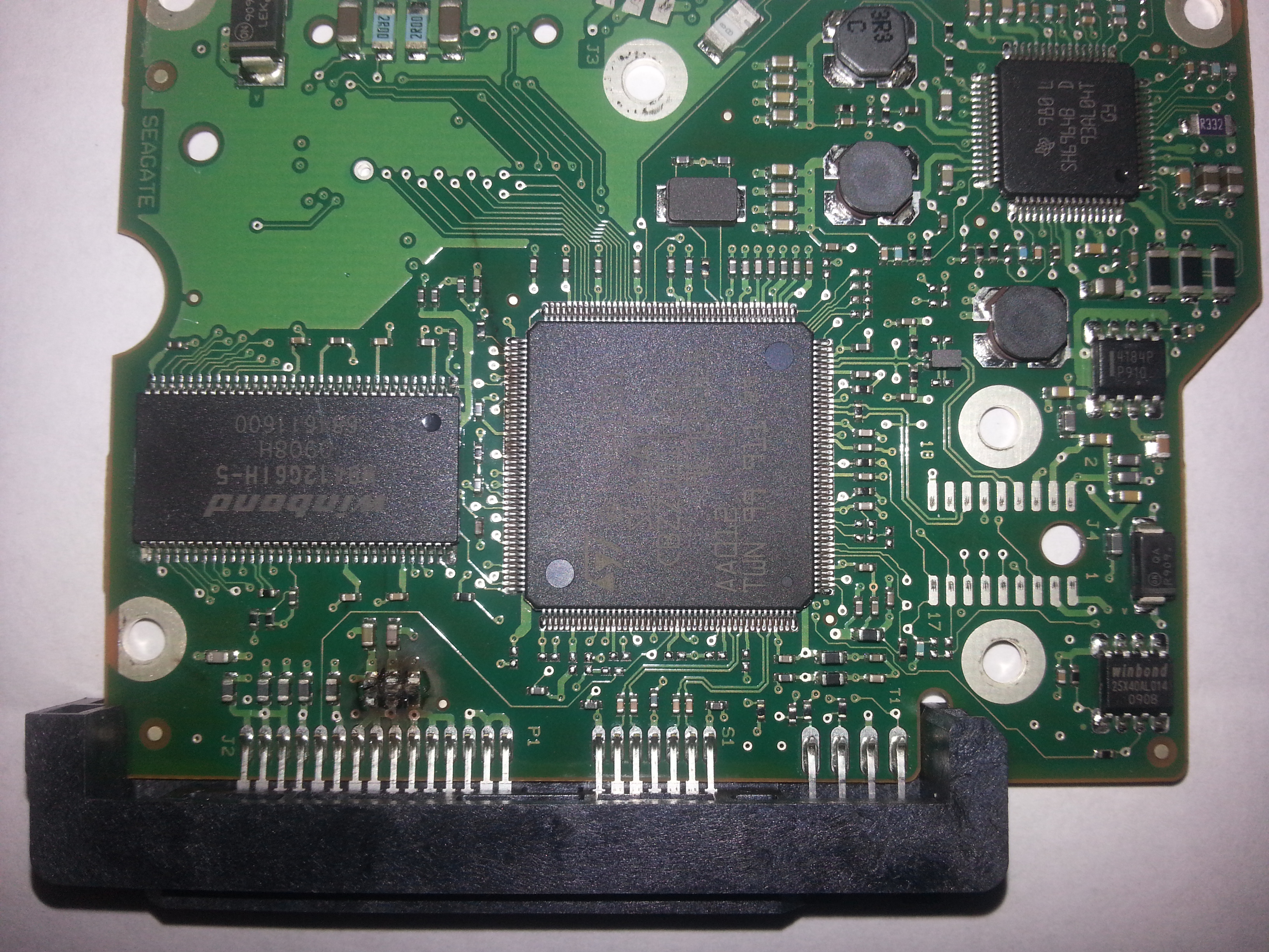

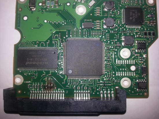

I apologize for taking so long to get back, life issues. here is a picture of the original board.

IMO the safest thing for you to do would be to replace the burnt components with wire links, and remove the 5V TVS diode with flush cutters. If you damage the EEPROM, then the costs of data recovery will skyrocket.
You can make wire links out of the ends of a resistor leg. Clean up the area with a toothbrush and isopropyl alcohol (audio/video head cleaner).
