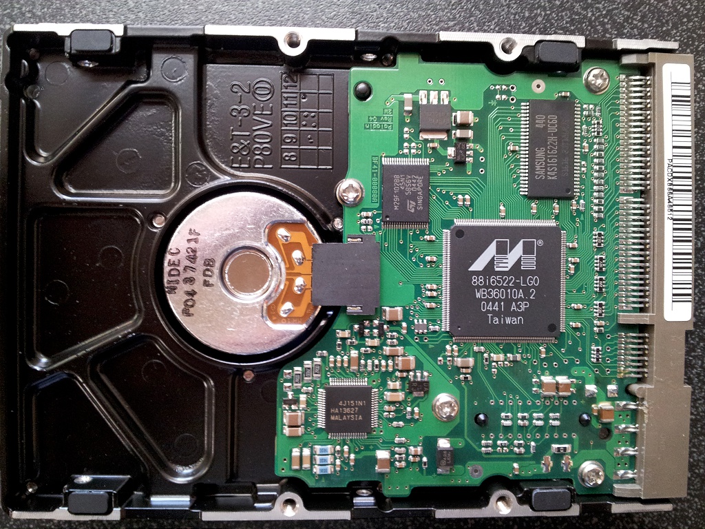

Hi everyone,

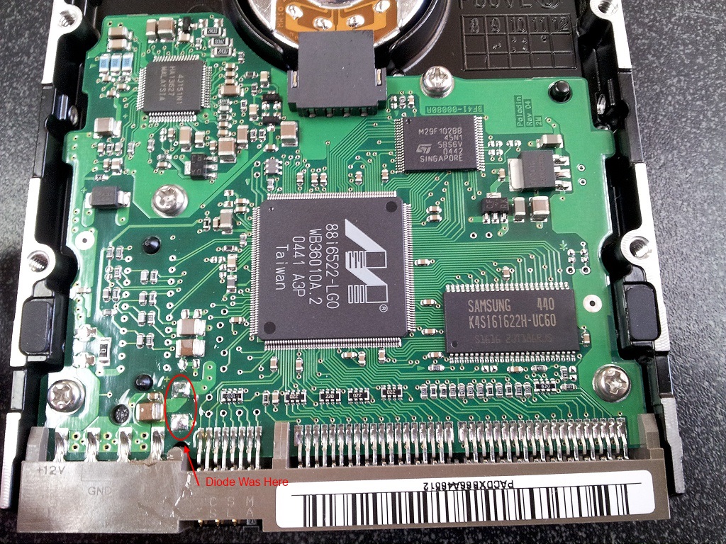

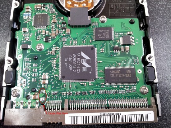

I have a Samsung SP0802N that won't spin up (no noises). When the drive was removed from the computer there was a diode (TVS diode?) right by the 5V power connector pin that was hanging off the board. It seems it was heated to the point where one end of the diode desoldered itself from the board.
Here is what I think may have happened...
Bad power supply was feeding the drive too much power so the Diode kicked in to route that power away from the HDD, that extra power heated up the diode to the point where it was so hot that it desoldered itself from the PCB board. So the overpower protection for the HDD was disabled at that point, and it fried something on the HDD.

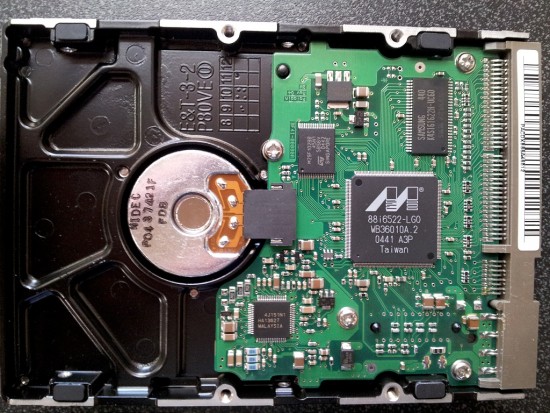

I am trying to determine if a board swap would be a way of recovering data off this drive. When I apply power to the HDD the large chip and rectangular Samsung chip on the PCB heat up (not really hot just warm). Also when I slowly spin the drive in my hand I can hear what sounds like the platter spinning (no stuck head, or seized motor?).
So what do you guys think? Is there anything else I should try, or do you think there is something wrong with the spindle possibly?
I have swapped PCB boards and ROM chips on a number of HDDs with great success, although I don't see a ROM chip on this board.
I have included some pictures for reference.
Anyways thanks for your time!
File comment: Missing diode

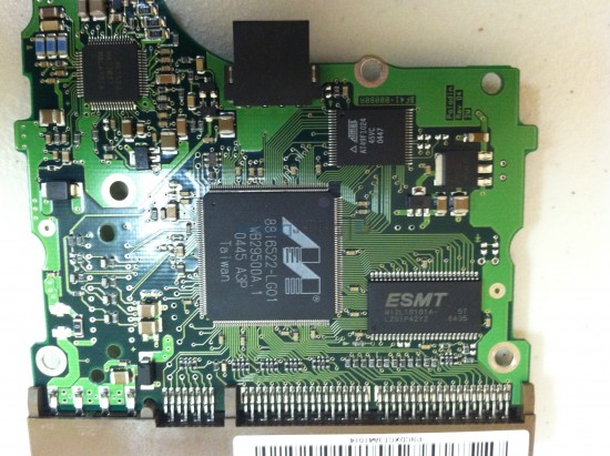

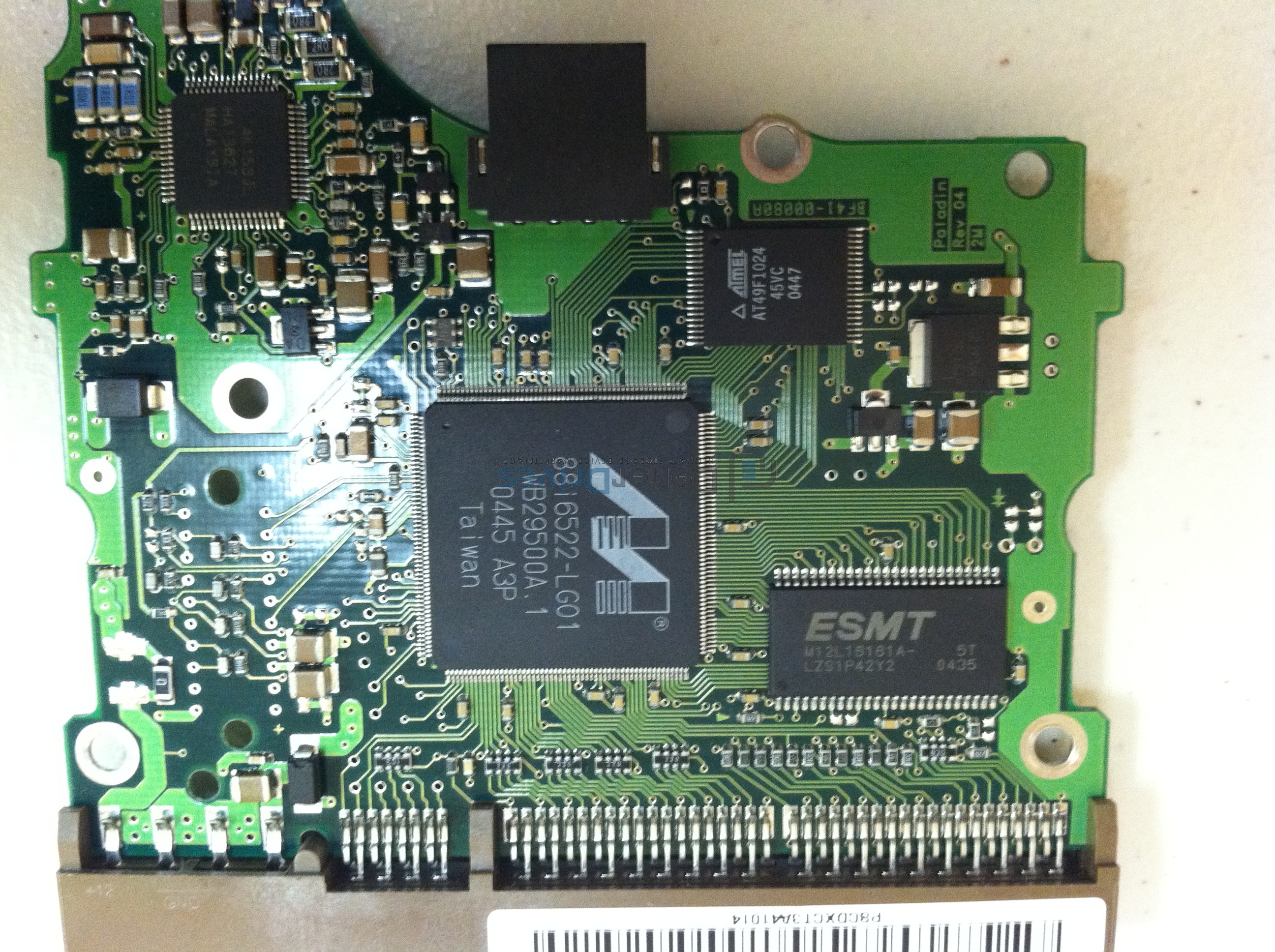

Here is a picture of a similar board with the diode still on it.
From my limited knowledge the components to the left of the diode are capacitors, but I could be wrong.
The diode removed itself essentially. :lol:

The 5V TVS diode does not have a fuse. There is a zero-ohm resistor near the screw, but that's for the 12V TVS diode ("LEM") near the other screw.
Since the 5V TVS diode desoldered itself, this would suggest that the overvoltage persisted for a significant time, in which case the preamp may have sustained damage.
I'm not a data recovery professional, but your board may be one of these where a straight swap might work.
If you would like to measure some voltages, I could help you with that, but it may just turn out to be a post mortem exercise.

The +1.2V Vcore and +2.5V Vio supplies for the MCU are OK. This would suggest that the MCU probably survived the overvoltage.
The +3.3V supply for the SDRAM is generated by a small portion of the analogue section of the HA13627 motor controller. It's OK, too.
However, the -5V supply for the preamp is missing (0V and 0.09V). This supply is generated by the motor controller IC. Some HDD models can switch off this supply, but others will switch it on, regardless of whether the board is attached to the drive. The SP0411N in my tutorial switches it on. Therefore I suspect that your board's motor controller may be dead. This chip is directly powered from the +5V rail.
I would install the board on the drive, select the 200 ohms range on your multimeter, and measure the resistance between the "0" and "0.09" test points in the second photo clip. This will test whether the preamp has a short on this rail. Also measure the same resistance on the PCB with it disconnected from the drive.
