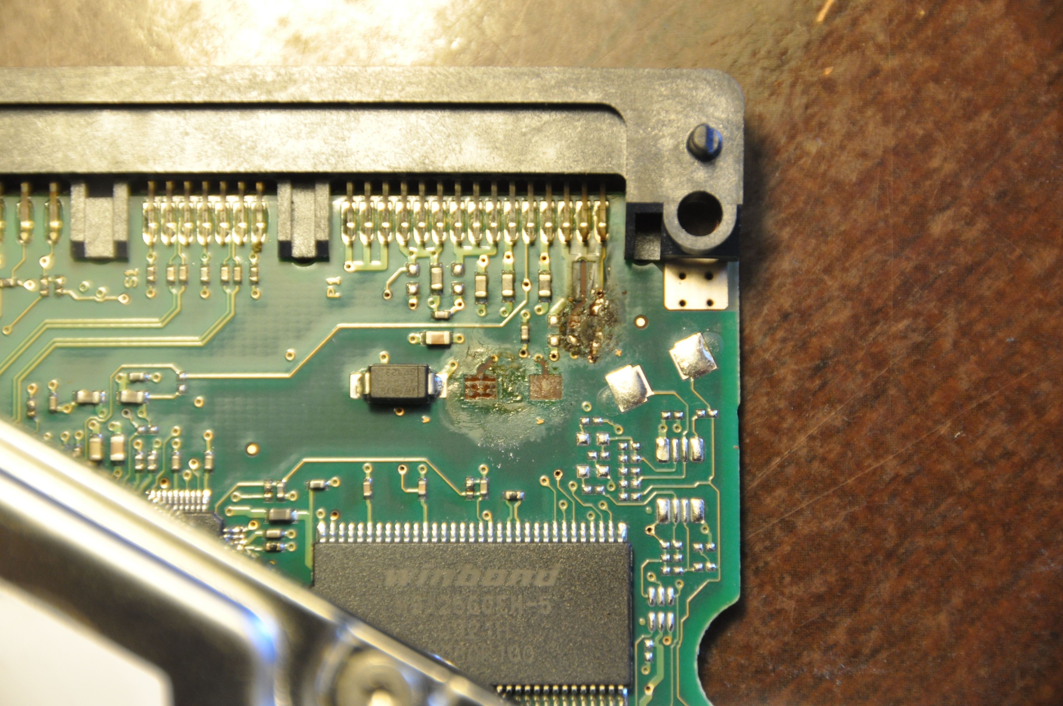

Hi There,
I have a seagate external drive 1tb and i accidentaly burnt the PCB (and removed the burnt components). I burnt it applying 19v instead of 12v, i know its stupid but i need to recover some data. If i buy one of the SATA/IDE/USB combo adapters will i be able to recover my data on HDD? or do i have to buy another PCB from the net? Thanks, guys, i appreciate it !

Can you upload a high quality photo of the component side of the PCB?
What components did you remove?

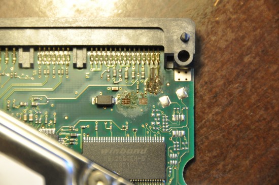

Here comes the pictures.

You'll need a replacement PCB and ROM swap.

i agree with Nick_CT, the damages seems to be very high

I agree also

Ok thank you guys ! i ll do my best to find a pcb then. Cheers
