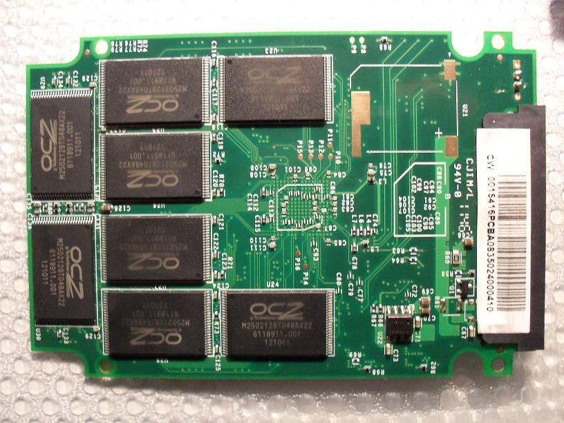

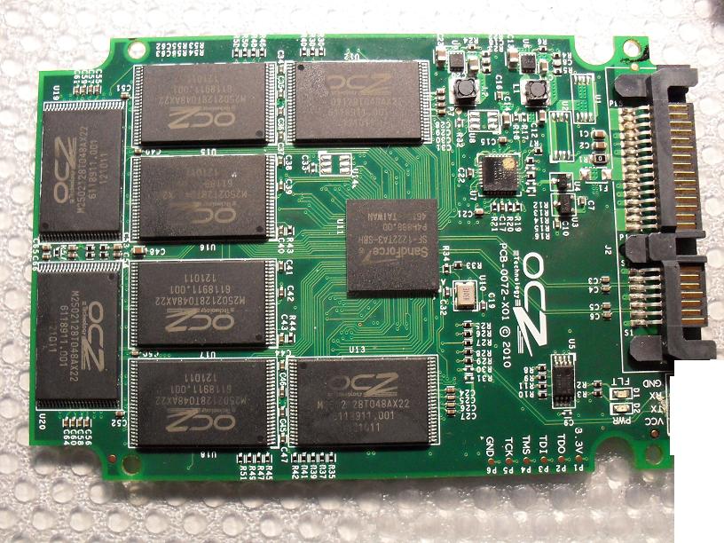

I include Pics
Any new idea?
NOte: Sorry i por another thread

There seems no evident damage (from picture) but the garbled data you get on terminal output make me think about either malfunction / FW problem.
Out of curiosity does the Sandforce chip heat abnormally ?
Hi BackSt
Thanks for your quick reply
Sandforce chip is not heating.
thanks
