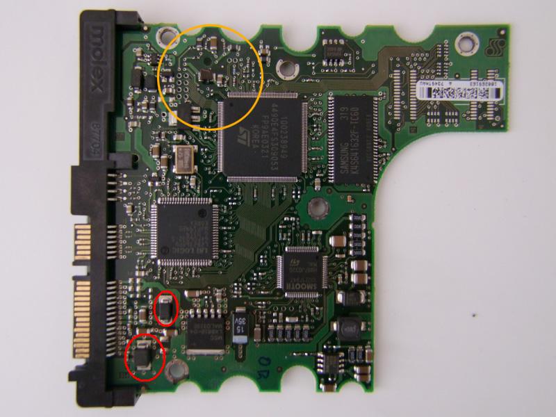

First of all, Im a new user that arrived at this forums because I have a HDD that doesn't work anymore.
The HDD that doesn't work is a Seagate ST3120023AS. I worked fine till a computer freeze and a reset. Then the computer didn't star saying that that there are no drives. I realized that using just one HDD (the one with the OS) worked and started ok. But connecting the secondary the computer doesn't boot. Finally at Bios none of the HDD are recognized when connected both and when just conected the bad one Bios doesn't recognize it too. The disks spins (not constant, with lapsus) but receives power.

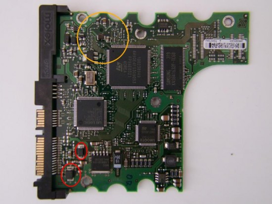

I did some research on the web and I saw that there are some troubles on the TVS for seagate models. I opeened the back of the HDD to get acces at the PCB and after looking for a bad component I realized that there was a component that seemed strangely brown ( not clearly burn), also I'm not able to read any on it. I disconected from the PCB and test it with the computer with the same result (disk spin but not recognizable). I thought that maybe another component was bad but I could recognize. I ordered a used PCB for this model, same firmware and when arrived the component on the "new- used" PCB was also brown and after test it I had the same result as before.
I'm posting some photos showing you the PCB and the bad component and I have few questions:
- Is the "brown" component a TVS?
- Should be connected again?
- 5 or 12v?
- Is there any other component bad?
- Has this HDD solution?
I would appreciate any suggestion or recomendation for next steps.
Thanks in advance
Edgar

ISTM that the boards are OK. The problem appears to be an internal one.

If drive spins, it's not a TVS problem or of any it any other component, maybe could be the SMOOTH chip (only 5% of chance).
However the TVS diodes are those i've checked with red circle:
Forget about TVS and other components, the problem is elsewhere.
If this issue is related to bad SMOOTH chip, you'll need to do a pcb swap.
