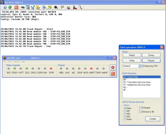

Hello, my friend has WD Caviar SE hdd WD5000AAKS-07YGA0, with totally burned pcb since 2 years.
Also Marvell chip is burned.
Pcb is 2060-701477-002 (sticker 2061-701477-900 AE) with mcu Marvell 88i6745-tfj1 but no flash rom chip
(firmware is embedded into mcu Marvell chip).
I found a good pcb replacement, motor spins but with head clicking.

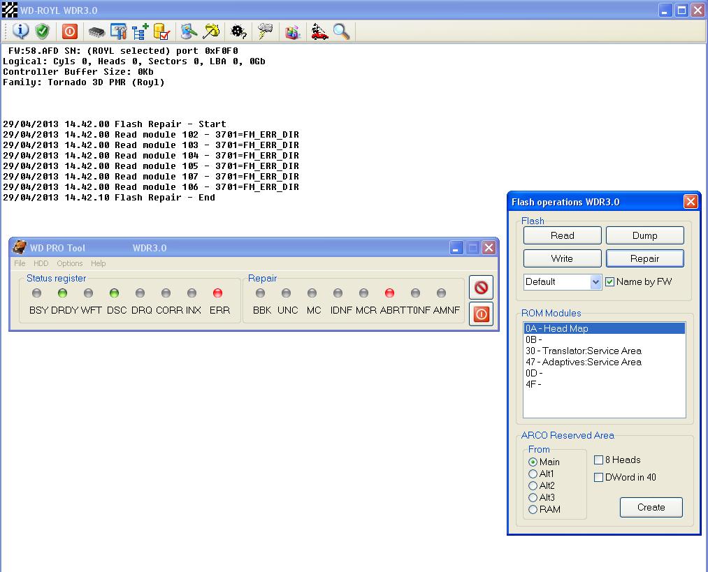

In WDR i did the "repair" flash in "Flash operations" but i get only error 3701=FM_ERR_DIR on read MODs 102-103-104-105-106-107.
I can't access to SA in module operations.
I was able to read and backup ROM, but not the SA.
ROM backup.rar [160.83 KiB]
Downloaded 377 times
Can you help me to flash the ROM with the good adptives?

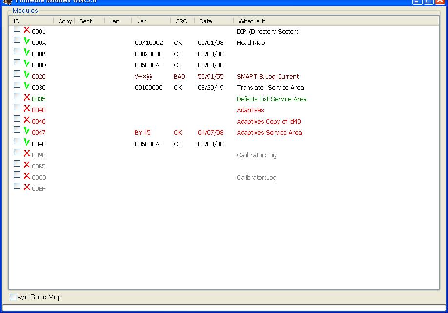

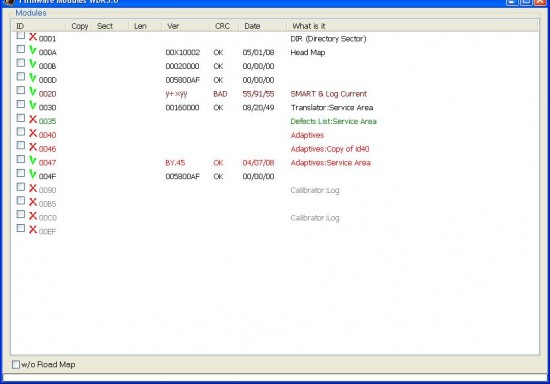

hddguy wrote:
Can you read any mods from SA? Could be better to establish SA version before messing too much with it. also would be useful to get backup of SA
I can't read SA.
I can see only few mods by "enumeration" but if i try to read them i get error.
The only enumerated mods which i'm able to read (backup) are those in the rom + mod 20 (smart) but with bad CRC
MOD 20 often has a bad checksum on good drives. Could we see it? I could extract the SMART data for you, FWIW.
Could we see the damaged PCB? That might tell us a bit about the problem. Did you check which, if any, of the TVS diodes were damaged?
As for a damaged preamp, if you can read MOD 20, wouldn't that largely discount the preamp as a culprit?
