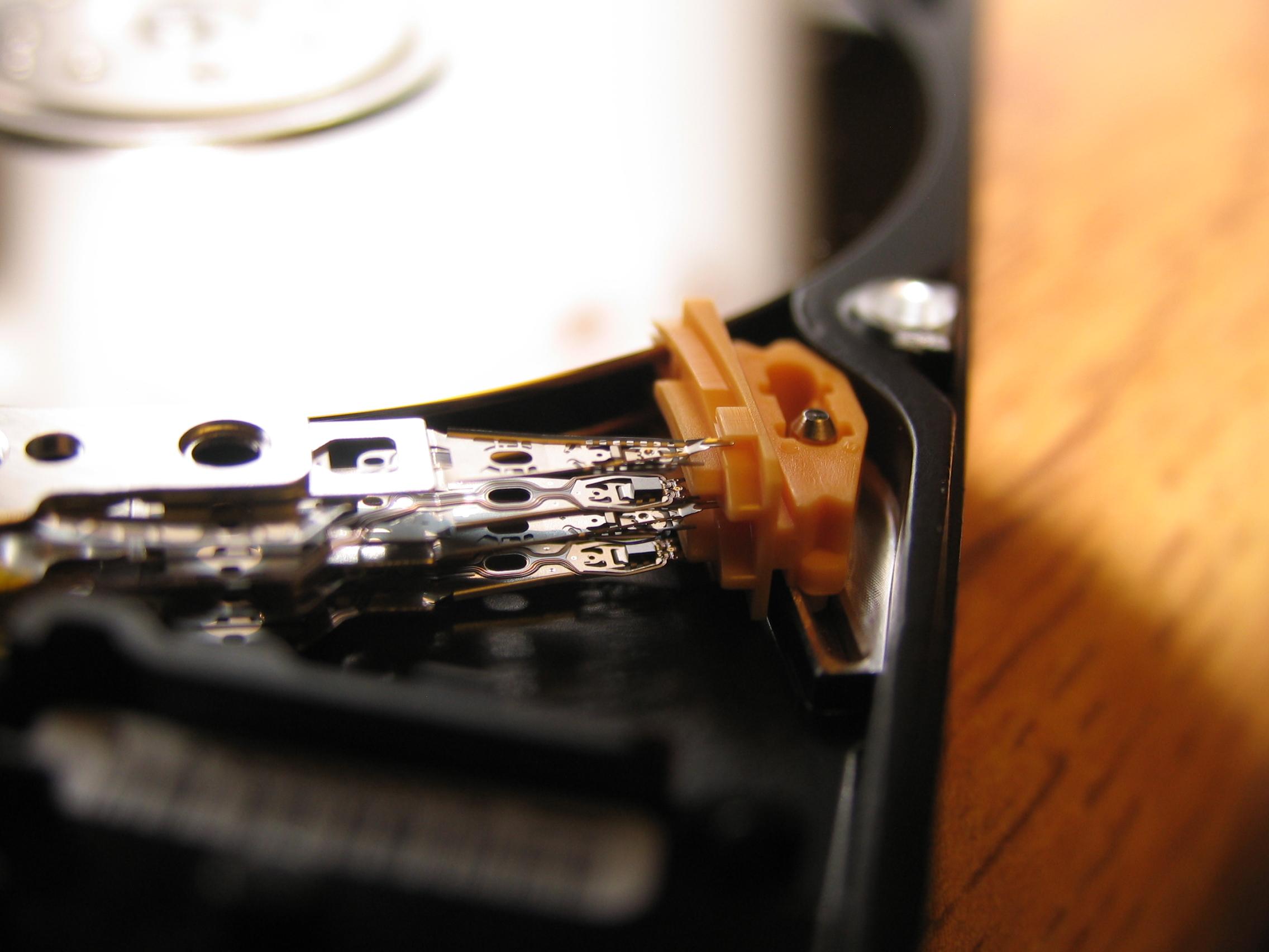

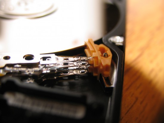

Thanks for the information. I'm looking into doing a head change and have been looking around the guts of the drive. Would I be able to see damage to the heads? The head was parked in the middle of the drive when I opened it up. I turned the drive and the head moved to the outside parking area. I don't see any damage. I've attached an image and was wondering if someone sees the damage or can tell me where to look? I would like to know the heads are damaged before trying to replace them.
 Post subject: Re: Bad hard drive BIOS on WD
PostPosted: May 21st, 2013, 8:57
Heads 0 and 2 physically look fine (which does not necessarily means they are functional). 1 and 3 can't see because of angle.

Also, the fact that the heads look ok (actually you're looking at the sliders, not the heads) doesn't mean they are ok. They need to be inspected under microscope and again you can't be sure.
I'm sorry, this is not the news you want to hear, but this is out of your league in my humble opinion. If you value your data, find someone who knows what they 're doing.
