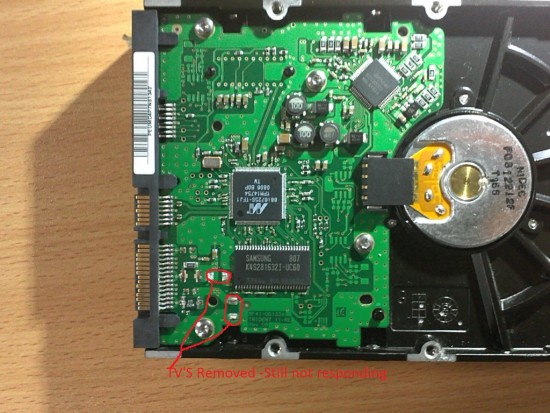

Hi Guys,

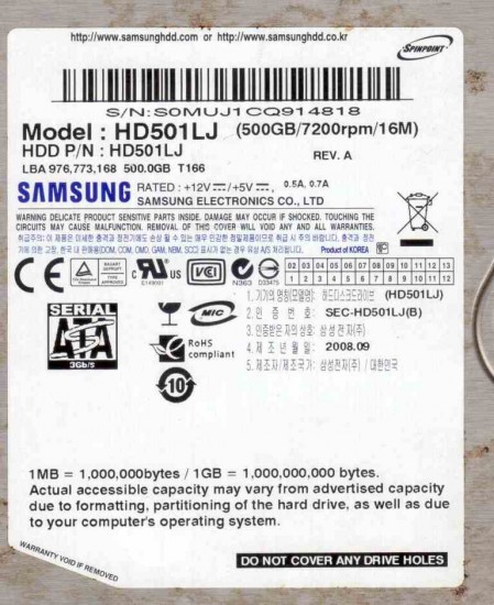

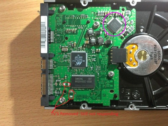

I received today this moel for the first time - Samsung HD501LJ 500GB drive and the drive doesn't start at all, which indicates a PCB Failure.
The TV'S had some green corrosion on them so i removed them and cleaned the PCB. I don't see any other obvious damage and i don't have a donor drive to compare components.
Drive still not spinning after removal of the TV'S,
I attached the pictures of the PCB and model.
If someone familiar with the drive it would be great to point me into the possible failing components to check.

Does the chips get hot after you power it on?

It's pointless to try to repair these PCBs unless you have everything like combo ICs and spare MCUs and all discrete components and want to spend some time. I do it only in two case : emergency and mass repair.
In my opinion it is a total waste of time, if the purpose is to get data (and ca$h) as soon as possible. Just do a quick test if there is activity and power at MCU / CIC / port, if everything is flatlined and you don't see any evident problem in 5 minutes, get another PCB /donor and make it work with your HDA (if it is only the PCB).

I've repaired many of these boards. Did you actually measure the TVS diodes before you removed them? If one of them were shorted, then the associated zero-ohm resistor or polyswitch would be open circuit, in which case the simple solution is to bridge it with a wire link in the vacant spot directly alongside it. It goes without saying that you should retest the board for shorts before powering it up again.

I had a look again on the picture and there is a large component opposite pins 13-15, is this the Polyswitch?
I tested it earlier for continuity and it was OK, should i wire link that with the Diode Pad?
And how do i check for other shorts than as you suggested?

As for your drive, the polyswitch is designed to reset itself after an overload. However, the resistor will go open circuit and remain that way. If you find that it is open, then flow a blob of solder over it, or place a wire link in the blue box alongside it. Then test each of the supplies for short circuits.

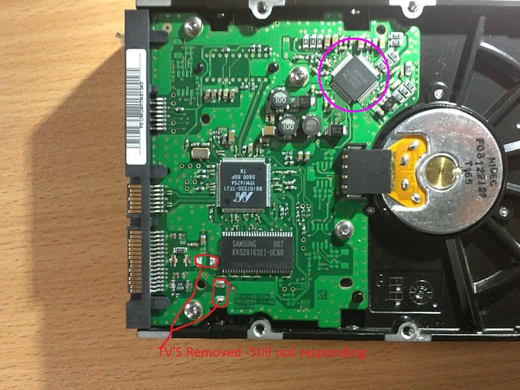

Maybe it's faulty motor chip...

Measure the voltages at each of the three coils with respect to ground. Also measure the voltages at the 3 pins of the transistor. Be careful not to short adjacent pins.
If there is no output, then the motor controller must be suspect.
Take your measurements with the PCB removed from the drive.
