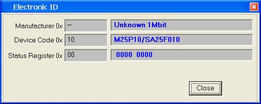

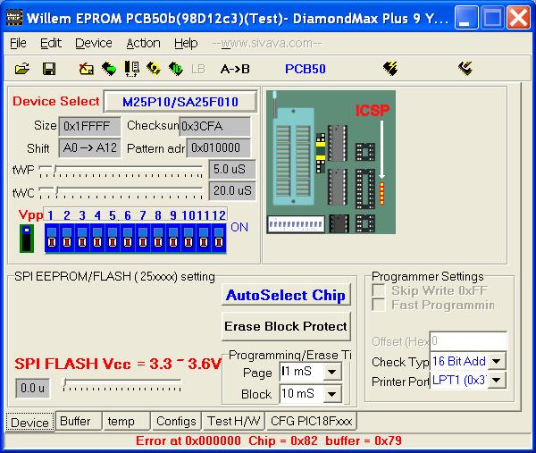

Hello, i've this Maxtor DM9 with damaged ST 25P10 ROM.
Luckily i have the ROM backup but i need to write it on the new ROM chip, i've an eeprom programmer to do that but on this chip my eeprom doesn't write correctly.
I tried on another new 25P10, all same story...
It always write ok on 25p20 and 25p40 ROM chips, but not on 25P10 (i don't know why) :o
How can i write it properly?
Drive is DM9
Code: YAR41VW0 N,M,B,D
6Y060L0420401
Date: 03 OCT 2002
PCB: Calypso 301599100
MCU: Ardent 040110200
This is the original ROM backup:
original ROM.txt [128 KiB]
Downloaded 1129 times
This is the eeprom writes it into the chip:
written ROM.txt [128 KiB]
Downloaded 1036 times

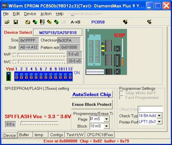

Note that the eeprom program gives error at 0x000000 Chip=0x82 Buffer=0x79

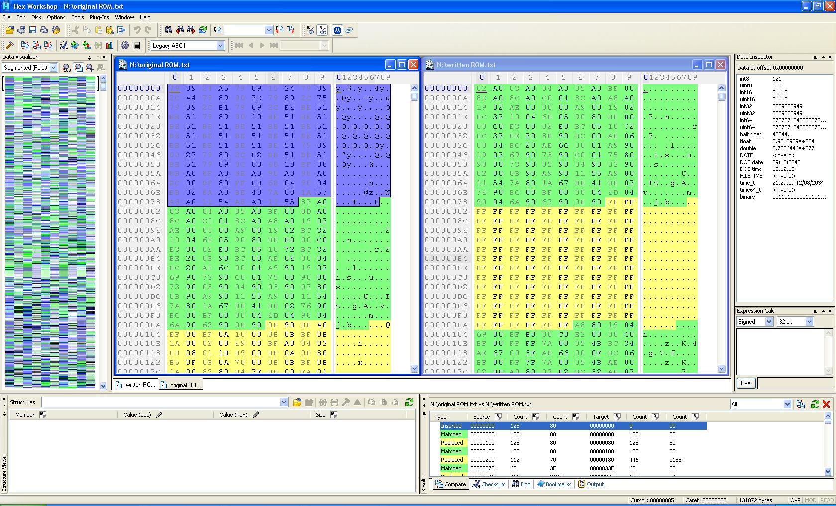

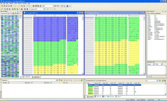

HEX Editor comparing:

FWIW, I notice that bytes 0x80 - 0xFF in the original flash have been written to bytes 0x00 - 0x7F in the target ROM, and 0x180 - 0x1FF have been written to 0x100 - 0x017F, 0x280 -> 0x200, etc.
Bytes 0x00 - 0x7F and 0x100 - 0x17F don't appear in the target.
That sounds like an addressing problem of some kind.

Thanks to Nebojsa_28, the answer to your enigma may be in this tech note:
http://www.datasheetcatalog.org/datashe ... Xytxry.pdf
There is a difference between the 25P10AV chip used in the DiamondMax Plus 9 boards and the earlier 25P10V6 chip.
The "A" has a page size of 256 bytes whereas the "V" has 128 bytes.
The "A" IDs as an 05h whereas the "V" IDs as 10h.
The "V" also has a higher Vcc rating.
 Post subject: Re: Maxtor DiamondMax Plus 9 ROM programming
PostPosted: May 10th, 2013, 4:48
Posts: 1744
Location: Verona, Italy
My chip is exactly 25P10V6
My firmware database:
PostPosted: May 10th, 2013, 5:44
Posts: 17101
ISTM that the Willem software may be treating your device as if it had a page size of 256 bytes. That's why the errors occur in the same way and at the same location in every page.
PostPosted: May 10th, 2013, 5:51
Posts: 1744
I don't know if i can change software option from 256 to 128 byte page :?
I don't think so...
