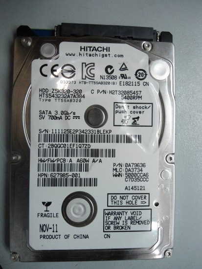

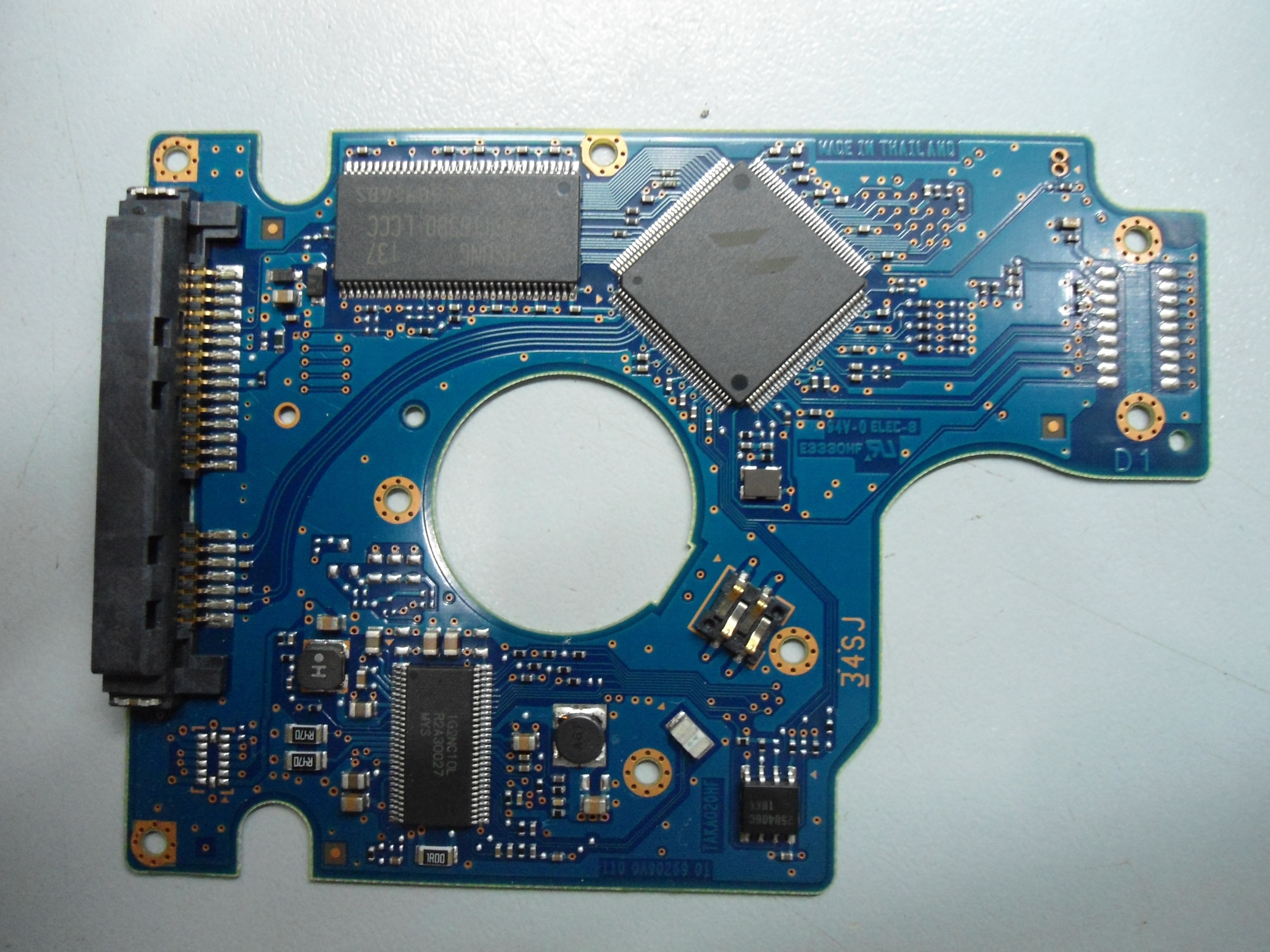

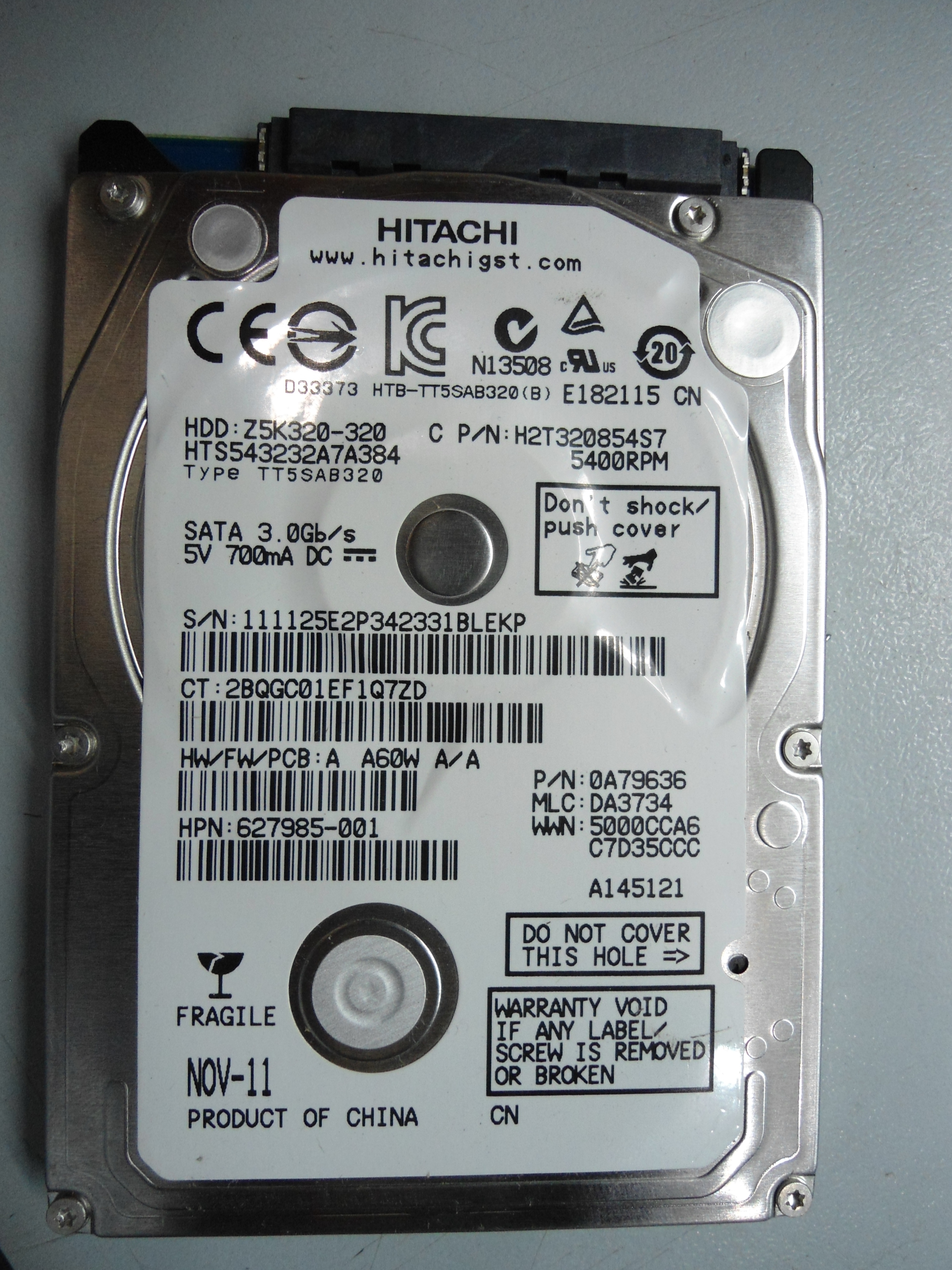

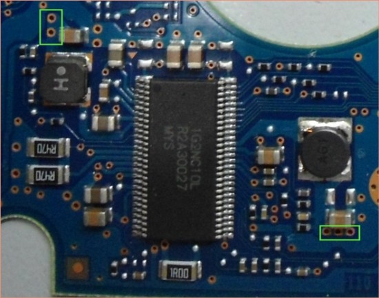

dear friend & seniors
please advise me how i repair this dead pcb
HITACHI
HDD :ZK320-320
HTS543232A7A384
TYPE :TT5SAB320

Get a donor and move ROM at bottom right of photo?

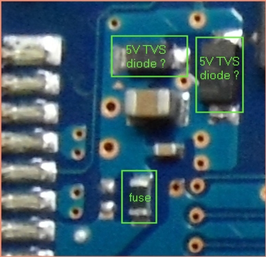

Check the fuse and the TVS diode.

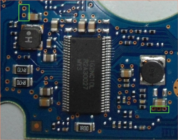

If they are OK, then measure the Vcore and Vio voltages.

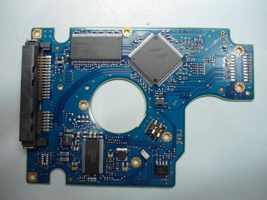

If you need to replace the PCB, then the flash IC is identified in the attachment.

MY DEAR FRIEND fzabkar
I Recently see your post abdout pcb reparing.
i am working on this matter.i am succeed i am thank ful to you.
