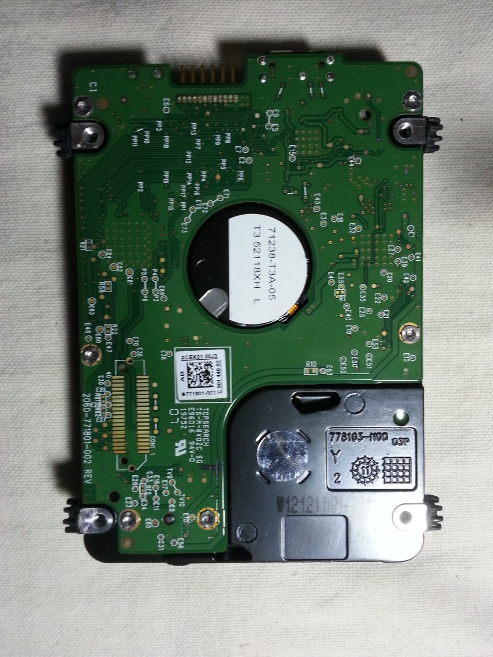

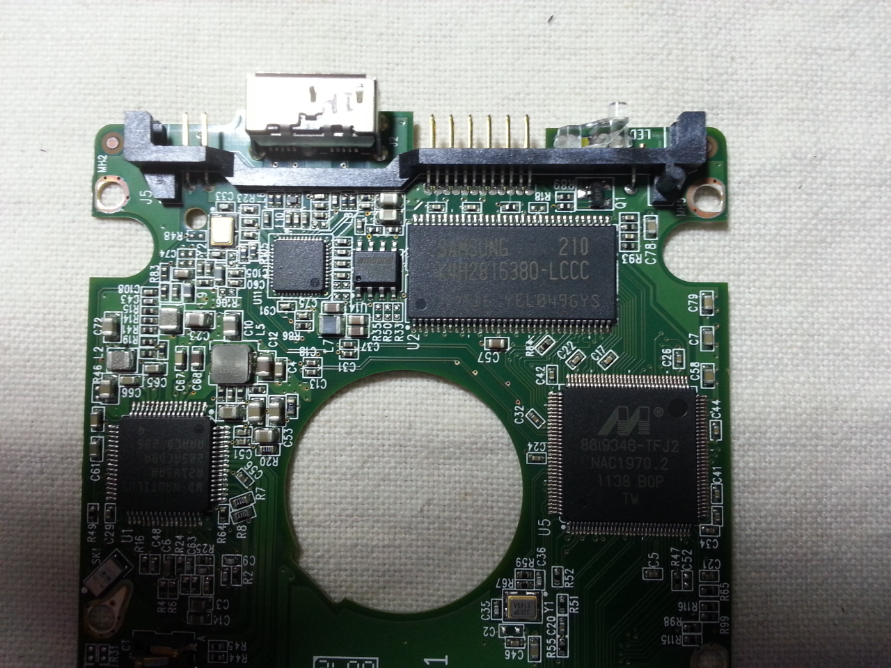

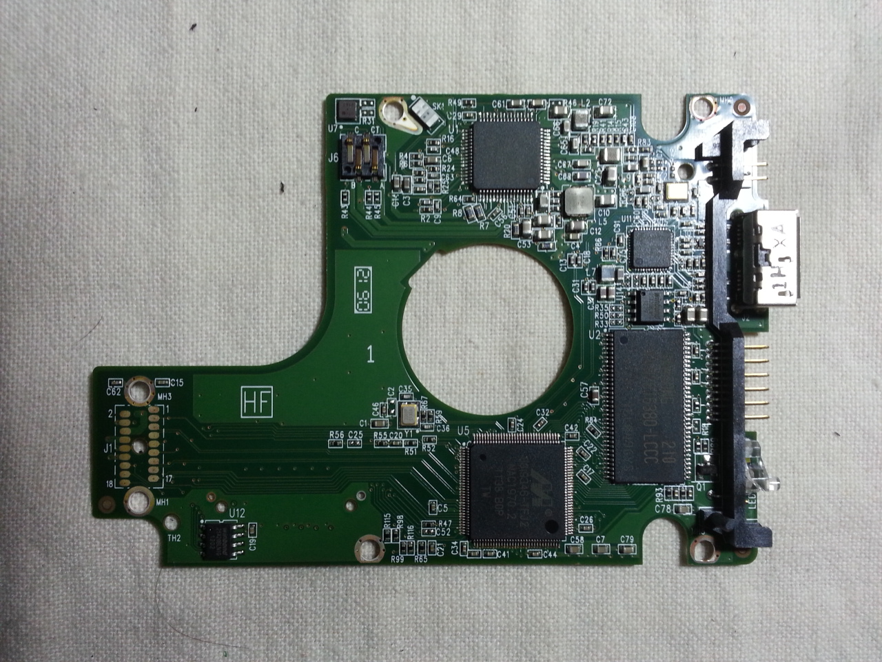

I am attaching a few pics of the PCB board to locate TVSDiode

Thank you so much. I see a small chip called U12. Is U12 BIOS IC? Which one is BIOS-IC? I was reading that for this PCB (WD 2061-771801-002) the BIOS IC swap is a MUST. Could you please clarify? How do I find TVSDiode in this board if you know that?

Yes U12 is the chip you need to move to the donorboard

Oh cool thank you so much. This U14 chip is also 8pin. Do i need to replace that one too? Whats that for?

U14 contains the bridge firmware. If the drive works but the data are encrypted, then swapping U14 may fix it. Hopefully it survived the overvoltage.
An "identical" PCB clicks because its "adaptives" are different. No damage should result, as long as the preamp voltages are the same.
I would measure the resistances between the supply (pin #8) and ground (pin #4) pins of U12 and U14. This is to confirm that neither is shorted.
BTW, I notice that the square bridge IC (behind the USB connector) has what looks like a blister. This IC appears to contain the PWM circuitry that generates its own 3.3V supply. This supply may have been damaged, in which case U14 might be suspect.
