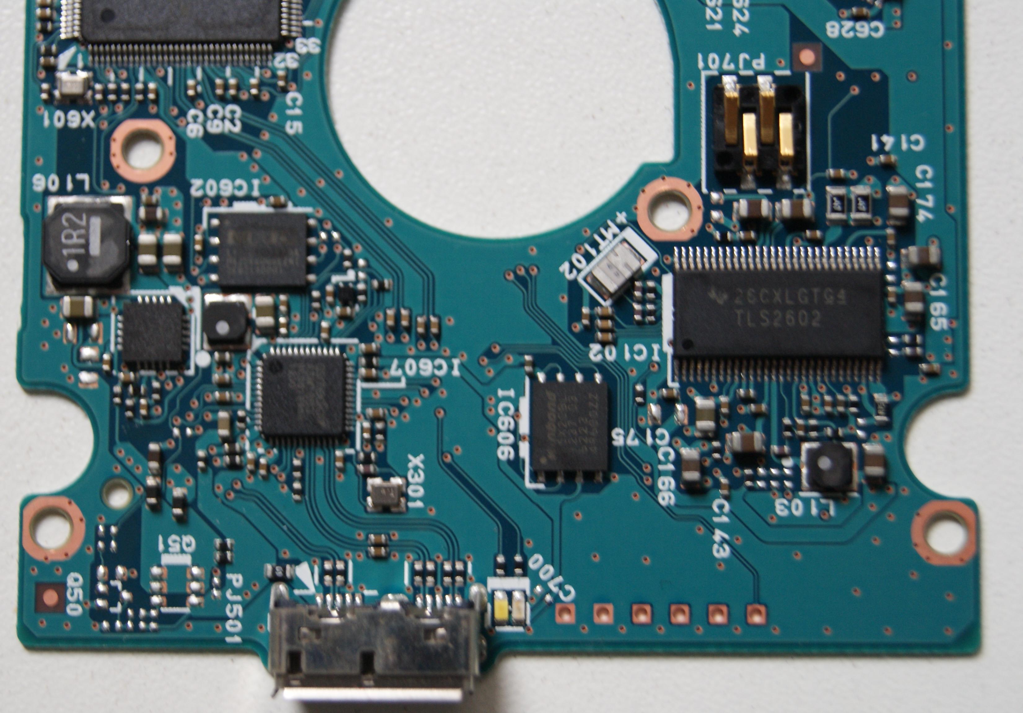

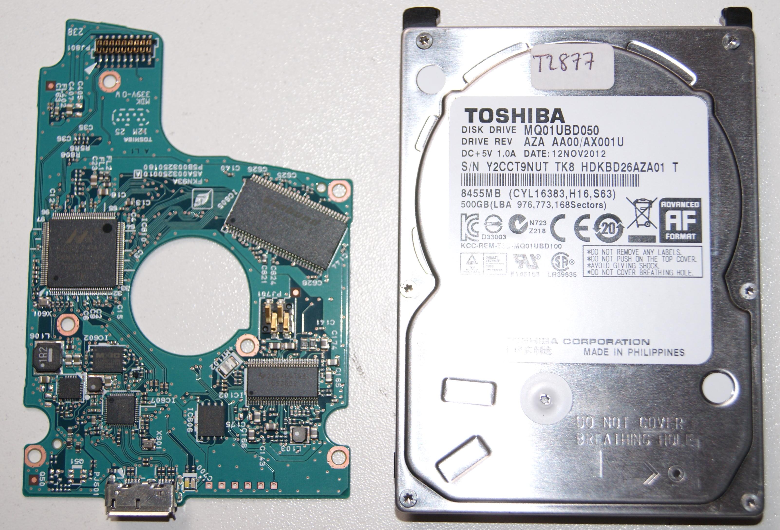

Hi Gurus;
Any Guru knows this new toshiba USB?
Maker: Toshiba
Model: MQ01UBD050
Rev: AZA AA00/AX001U
Date: 12nov2012
s/n: y2cct9nuttk8
Spec: 500 GB 2,5" USB
any guru has info about how to convert this USB HDD TO SATA HDD?
any guru knows how to get Serial interface port?
I send Pic
Thanks for your clever responses

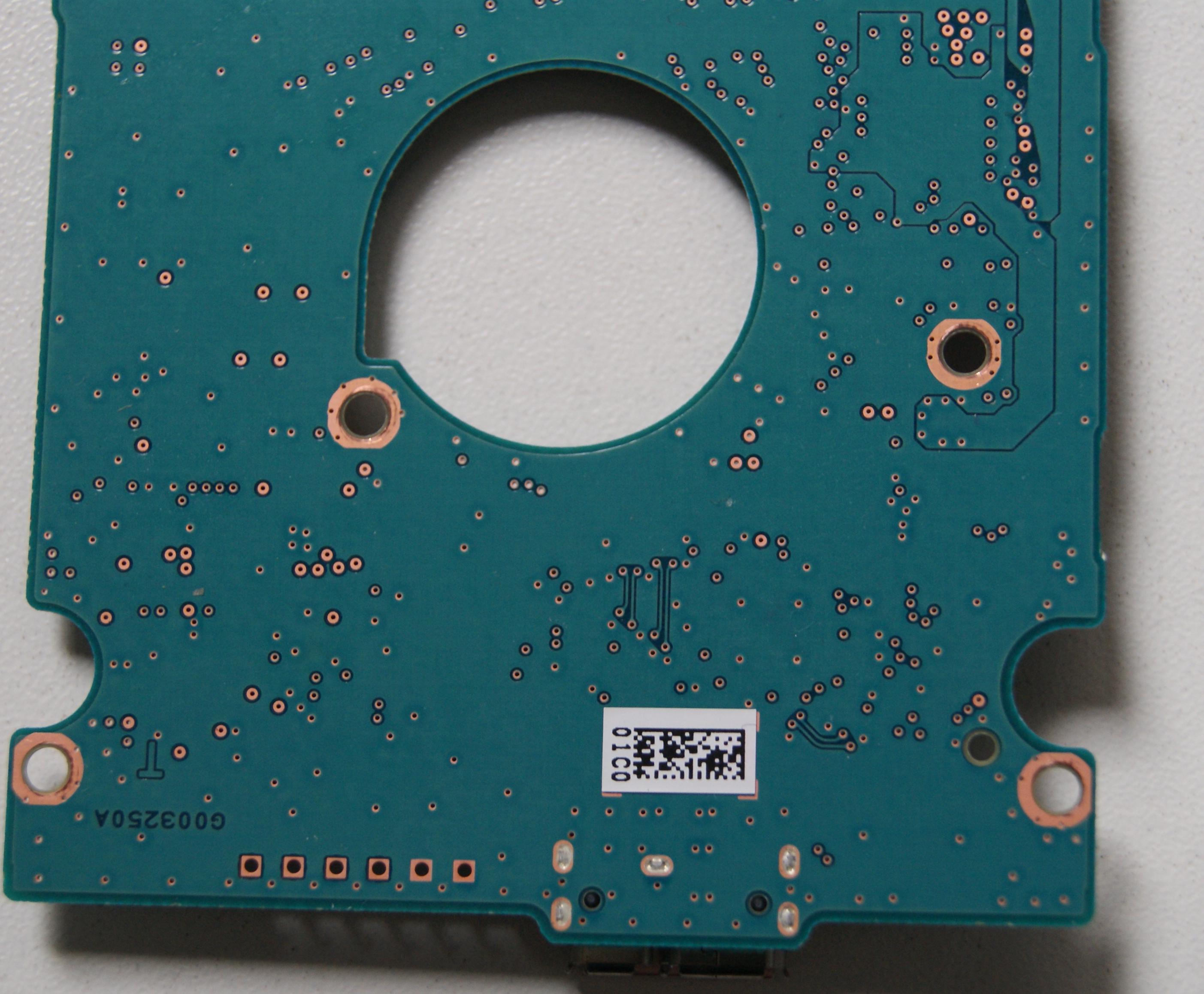

another pic about SATA controler

MQ01ABD100
 Post subject: Re: toshiba USB to SATA adaptation
PostPosted: June 6th, 2013, 13:35
Posts: 811
Location: World
labtech wrote:
MQ01ABD100
What happens with this drive?
PostPosted: June 6th, 2013, 16:22
It's SATA interface

There are 4 capacitors and 2 parallel Tx/Rx traces at about 2 o'clock to the bridge IC, above the "IC607" circuit reference (DSC03837.JPG). If you would like to convert your PCB to SATA mode, then remove these capacitors and wire your SATA cable to the MCU side.
PostPosted: June 7th, 2013, 7:20
Posts: 811
Location: World
Thanks another time, you are the best.
i'll do it

The fact of removing capacitors 10uF, not influence the data transfer?
Thanks.
PostPosted: June 14th, 2013, 2:37
Posts: 17326
They wouldn't be 10 microfarad.
In any case you need to disconnect the bridge IC, otherwise it would interfere with the data transfer. The purpose of the hack is to bypass the bridge IC and connect the MCU directly to a SATA controller.
