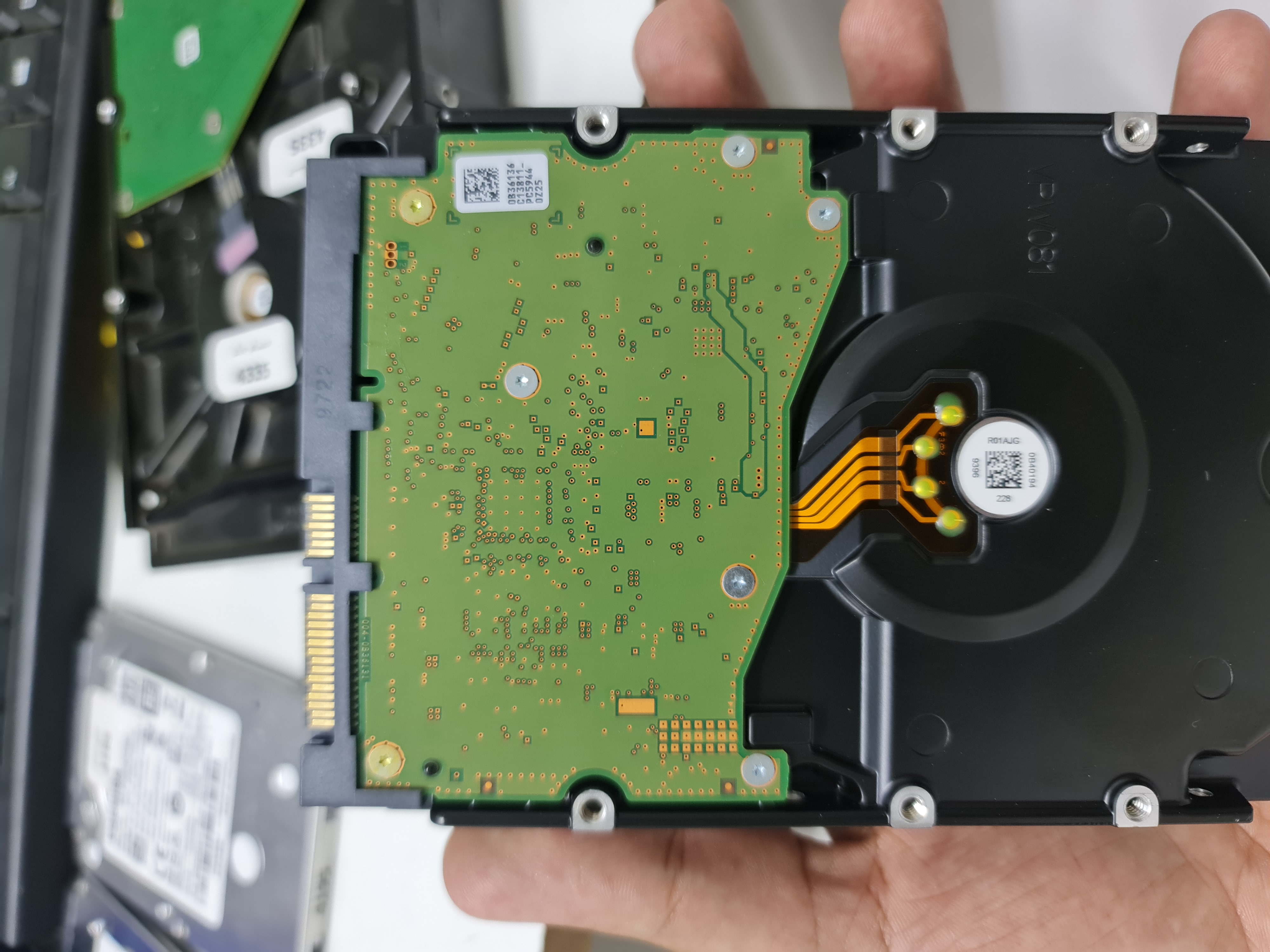

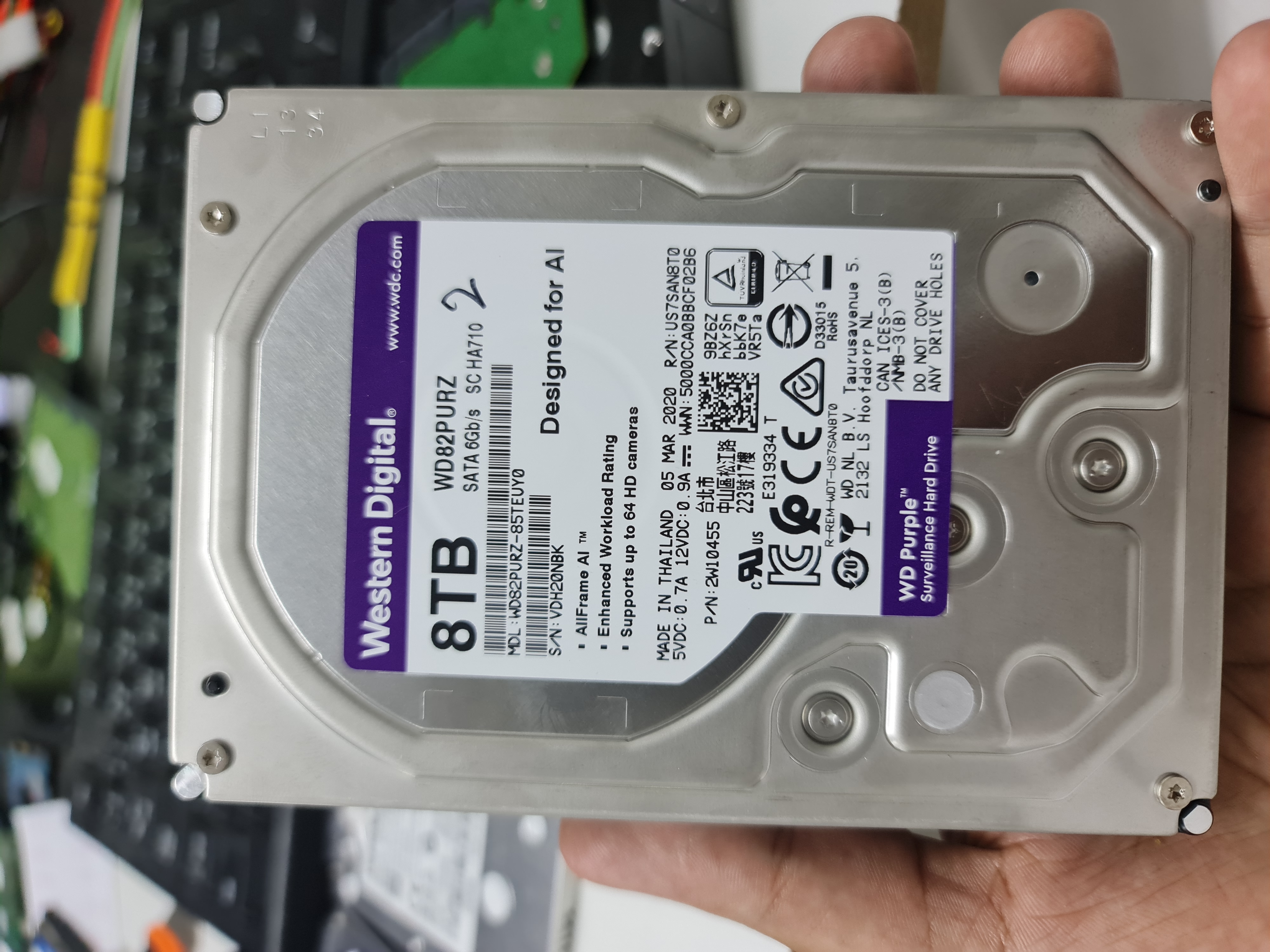

Hi
What is this drive family?

From https://support-en.wd.com/app/warrantystatus ...
    VDH20NBK
    OUT OF REGION
    WD82PURZ-85TEUY0
    WDVL8
    7200
    256M
    SATA3
    6GB/S
    8.0 TB
    10HD
    SURVEILLANCE
    NON-CHINA DISTRIBUTION
    HGST
    15-Apr-2023
The PCB number, 0B36131, is a HGST PCB number.
"US7SAN8T0" is a HUS728T8TALx6xx HGST model.
https://documents.westerndigital.com/content/dam/doc-library/en_us/assets/public/western-digital/collateral/cert/cert-agency-approval-ultrastar-dc-hc320.pdf
https://documents.westerndigital.com/content/dam/doc-library/en_us/assets/public/western-digital/product/data-center-drives/ultrastar-dc-hc300-series/product-manual-ultrastar-dc-hc320-sata-oem-spec.pdf

I think WDVL8 is Vela-AP.

Absolutely correct
WD82PURZ-85TEUY0 is Vela-AP HGST model.
