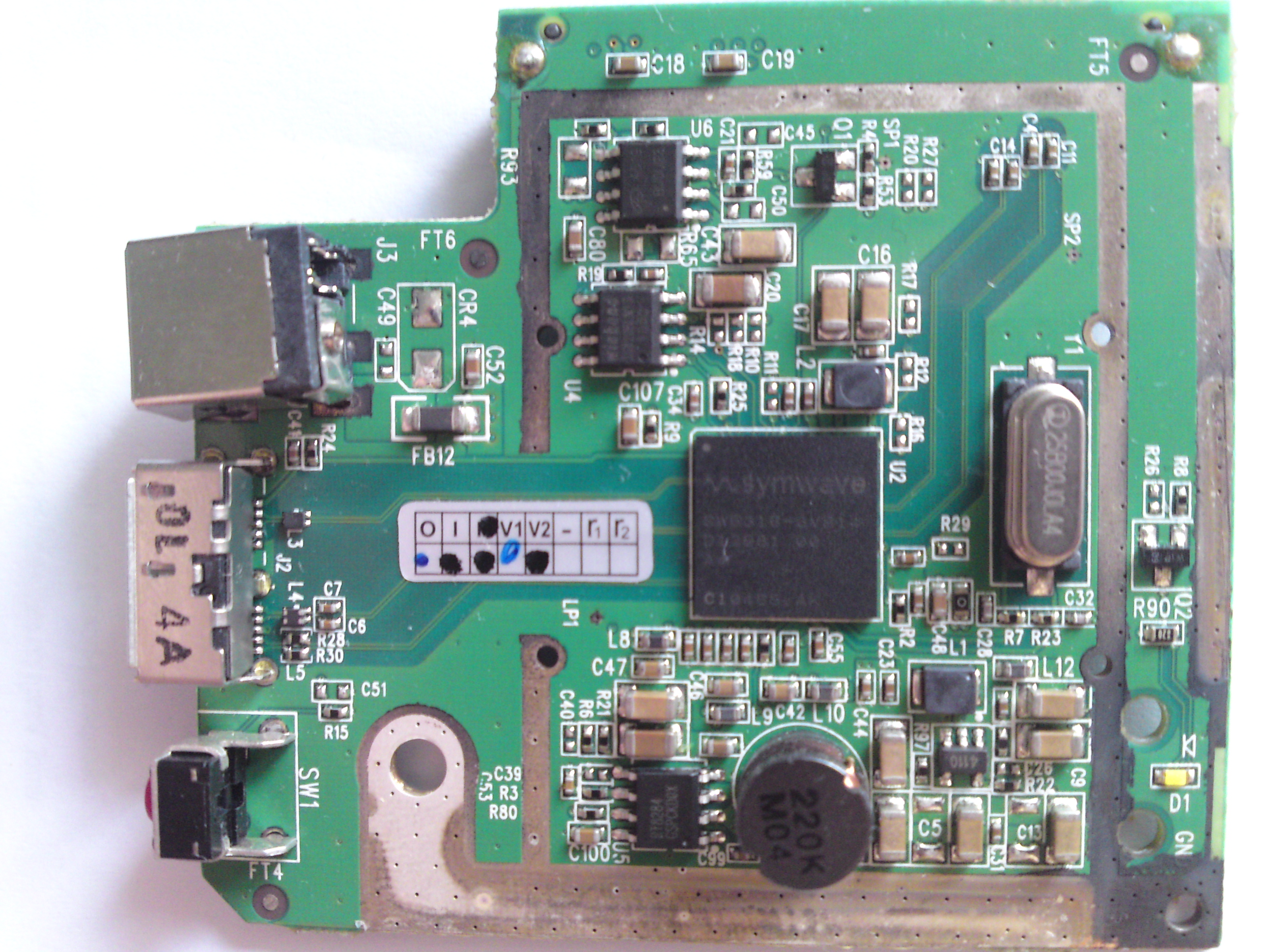

PCB PHOTO ATTACHED TO THE POST resolution: 3264x2448
Dear gurus, I seek your help to determine what's wrong with the board (if anything). Here's my problem:
HDD: MY BOOK ESSENTIAL 1TB with USB 3.0
HDD doesn't do anything at all when connected to PC. It does not spin up, nothing. Not visible in BIOS either. I looked up several other posts by people with the same issue and done some digging prior to this post. The relevant information was too scarce to be of much help, so I decided to post here.
I removed the pcb and connected the disk to motherboard directly via SATA - it DID show up and seemed to work flawlessly. Due to the encryption, however, it showed up as unallocated space.
PCB: 4060-705089-001 REV. P1 (board)
4061-705089-001 REV. AG (sticker on the board)
Recent behavior: nothing unusual, HDD did not fall, there were no blackouts and AFAIK no power surges, no strange noises.
Over the course of more than 2 years, the HDD has fallen several times - not higher than knee height and always on carpet. BUT more than half a year back the usb cable end part got a little bent - no more than a millimeter. The disk worked fine regardless, although sticking the cable in the disk met with stronger-than-usual resistance. I have no means to determine if the cable is the faulty component here - I have no other USB3 micro device to use with the cable or another cable to use with the disk. I intend to go to a not-so-local computer service store to ask them to try different cable with the disk, but that is not going to happen right on Monday (today is Saturday for future reference) so I figured I could look into it with someone's help.

File comment: 4060-705089-001 REV. P1 (board) 4061-705089-001 REV. AG (sticker)

The power socket looks like it has come adrift. Can you see any cracked solder joints, either on the component side or bottom side of the PCB?
Measure the voltage at the pins of the SATA power connector. Connect the black probe to ground and the red probe to the +5V and +12V pins. You should do this without the HDD attached.
If you can't measure any voltage at the SATA connector, then measure the voltage between FB12 and ground.
If you don't know how to perform these measurements, then it may be best to have someone do it for you.

You were right, one of the joints was cracked. It was a very tiny crack. I wouldn't have found it myself - I just assumed that the power socket was crooked from factory since it's very firmly attached and doesn't move at all. I joined the broken leg and the problem is solved. Thanks for your insight.
