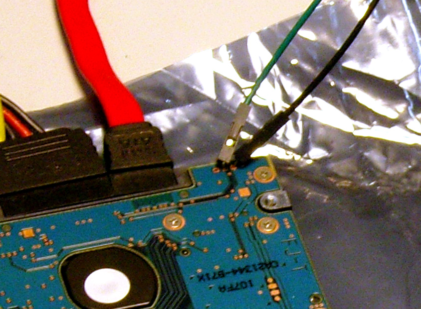

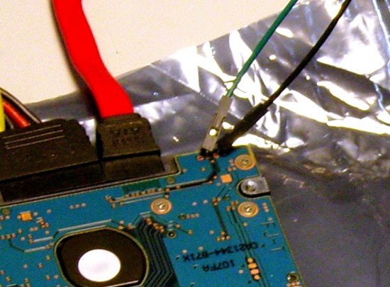

if you want to connect to the terminal of the pcb of that disk, you have to solder two pins directly on the pcb in the 2 middle holes of the 4 holes in the top right corner of the pcb (see the attacched photo).
than you may use the terminal connection created to talk with the seagates drive.
I found this solution study the pcb of a case in our laboratory and i share it with all of you as a thank you for the solutions that I found in this forum.
bye!
File comment: How I connect the terminal

AFAIK, there is no echo with Fujitsu SIO, and the command set is proprietary. And not shared.
So . . . now that you have established a serial port connection, what do you do with it? How does it help you with the recovery process?
bye!
PC3K asks for terminal connection when it comes to unlocking fujitsu hdds. Maybe not for all the models , I don't know but for mine it was necessary.
It was a password protected hdd. Fujitsu MHY2250BH. There wasn't compatible terminal adapter for this drive that time. Then I tried to use seagate terminal adapter as you said.
SO this method worked very well for me!
Thank You! :D
