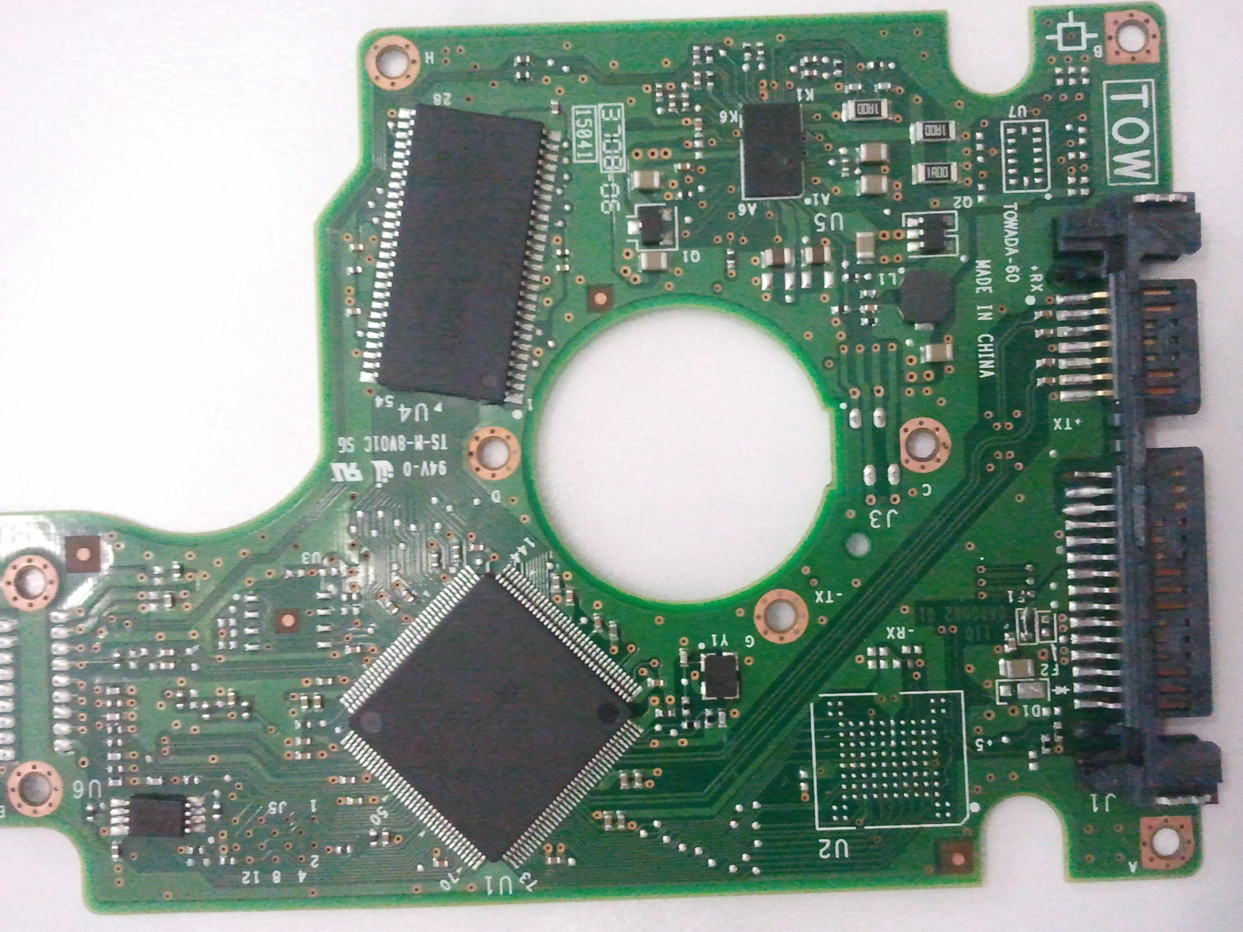

good evening ;
i have hitachi hts543216l9a300 with burnt PCB
pcb sticker #
0A57128
DA2358_
X5K843
3544
the pcb is toasted and no chance to revive it ..
i am trying to use a donor pcb
pcb sticker #
0A57128
DA2358_
M5P907
KAPZ
the donor PCb does make the patient media spins ok , witout any clicks or abnormal sounds , but doesn't detect neither in BIOS nor in DDI
U6 may has some unique data to the patient drive , but previous recoveries "which were performed o nthe drive before reaching me" and transfereing the U6 several times i think , has just damaged the patient U6 "a leg is messing and hand work is obvious on the chip"
any thoughts ?
thank you
 Post subject: Re: hitachi hts543216l9a300 PCB replacement
PostPosted: June 29th, 2013, 4:09
Posts: 17393
Your photo isn't clear enough for me to see the damage at U6, but have you tried reading the chip with an SOIC clip? Is there a short circuit between pins 4 and 8?
PostPosted: June 29th, 2013, 6:21
Joined: August 16th, 2012, 4:57
Posts: 324
thank you for your answers ..
no pin 4 and 8 are not shorted ... but pin 2 is lost :?
the photo is for the donor PCB , in the patient the U5 is toasted , and U6 missing leg 2 :roll:
PIN 2 is assigned to "Serial Data Clock"
