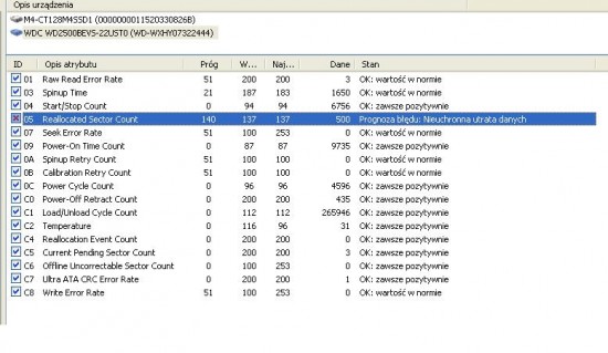

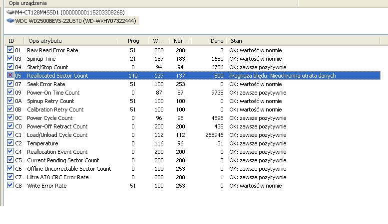

 Post subject: Re: What is best to do with a failing HD to recover data?
PostPosted: June 13th, 2013, 12:35
Joined: June 13th, 2013, 3:27
Posts: 10
Location: poland
Thanks for making things clearer.
Well I managed to copy actually everything, starting from most important stuff down to some least important movie rips, no writes, no chkdsk (that one I knew I shouldn't do after screwing recovery options on a usb stick once ;) Only the folder that it previously hanged on makes problems and it's making some noises mostly then.
Files there were created when I was recovering pictures from seemingly faulty SD card using Recuva then the freeze and smart failure happened.
So I started wondering - maybe the bad sectors are logical and can be fixed ? and the sounds are when the HD moves head often by simply retrying to read those and thus it is normal operation?
Could it be that I replicated bad sectors from SD card to the hard drive ?
SMART from everest attached - reports warning only on 500 bad sectors (hdtune wouldn't read smart from the usb case)
PostPosted: June 13th, 2013, 12:53
Joined: May 6th, 2008, 22:53
Posts: 2138
That depends what you mean by "normal". In the event of read errors, then there will be retries - but there should not be (any significant number of) read errors in the first place!
For any normal user software (e.g. OS copying of files), the answer is no.
[Edited for minor grammar error.]
PostPosted: June 13th, 2013, 13:02
Posts: 10
Location: poland
By the way I become interested: which are the most important values of HD usage indicating it's lifespan that can be seen in the SMART ?
I guess this relates to values like: power cycle, power-on time or start/stop count?
is there any range for these to be be high/low ? I also don't get the spin-up values - which column is proper her - 1650 ?
PostPosted: June 13th, 2013, 13:25
Posts: 2138
Re: SMART - There are lots of opinions and interpretations. Some details are not publicly documented and can vary between drive makes & families. Personally I have not found the attributes which you list, to be useful in predicting future lifespan.
I suggest you start by reading the Wikipedia article on S.M.A.R.T. - personally I don't agree with all of the opinions in that article, but it is a reasonable start for beginners and shows some of the complexity which is involved with trying to interpret the various attributes. It also explains why you have to be cautious about using the "raw values" like 1650, in your example.
There is also a good research paper by Google on how some SMART attributes have a correlation with increased chance of disk failure in the near future - but even that paper is just a guide. If you can't find that research paper by searching, perhaps someone will be kind enough to give you a link.
przemke wrote:
yeah but is Recuva a normal user software ?
Yes.
przemke wrote:
maybe it has bugs when writing files and could cause all the commotion ?
No, based on my knowledge of the (S)ATA protocol, disk drive behaviour and Windows programming, it could not cause the exact symptoms which you describe. However if you want to stay with this hypothesis, I will turn the question around: How do you suggest to prove that your hypothesis is correct?
PostPosted: June 14th, 2013, 1:50
Posts: 10
Location: poland
Great insight for me, thank you.
I think only way I can prove my hypothesis ;) is when the bad sectors turn out to be logical and disk works fine from then.
I'll have to use mhdd I assume and zero the whole disk? I got a replacement drive already for system and this will be bonus external storage if it indeed lives
But can the reallocated sectors reported in SMART be logical ? There's also 0 "reallocation event count" and 3 for both "raw read error" and "current pending sector" - could those 3 be the actual physical bad blocks ?
Do you know how those values/factors relate to each other ?

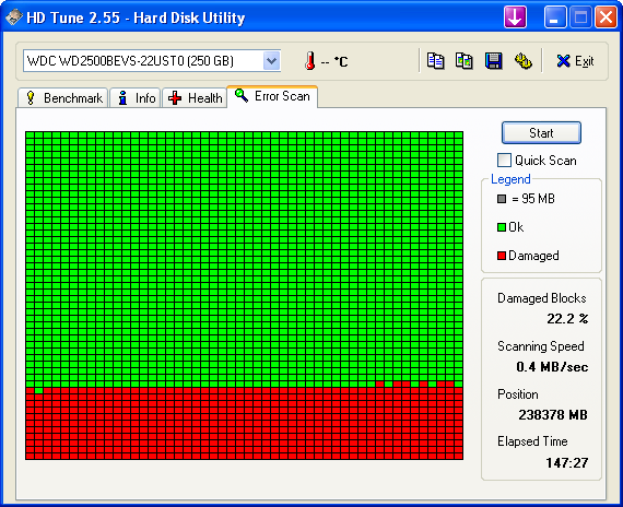

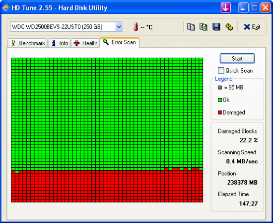

PostPosted: June 14th, 2013, 5:11
Posts: 10
Location: poland
Reeeeed zone! looks like the outer part of the platters ?
I think it was mostly free space. guess my "hypothesis" is much less likely haha ;)
PostPosted: June 14th, 2013, 8:05
Posts: 283
Location: Gdansk - Poland
It doesn't mean it's bad where its red.
Probably bad sector triggered this and windows 'disabled' the hdd.
data recovery Poland
PostPosted: June 14th, 2013, 8:24
Posts: 10
Location: poland
Whooops it sound likely, what you say as before it was like disabled as soon as bad sectors were attempted to be read
anyone can confirm this ?
If it is like that then pity HDtune doesn't stop and report it can't access the disk instead of marking all as bad block
PostPosted: June 14th, 2013, 16:26
Posts: 388
Location: Chicago, USA
red = inner tracks
PostPosted: June 14th, 2013, 16:57
Joined: July 2nd, 2011, 14:16
Posts: 463
if its a laptop hard drive, more likely little movements and vibrations might have damaged one of the heads, so once it hits a section of the disk it makes a noise. Since you got most of the data off, I would cut your losses and get a new hdd, if you try and fix the old drive, you might cover the fault and it looks okay, but sooner or later, it will crap out completely.
