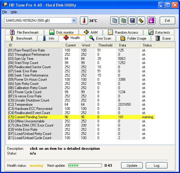

Hello everyone,
i have a Samsung hdd which MHDD detects with a lot of bad and week sectors.
In smart there are a lot of pending sectors which i can't reallocate, no reallocated sectors are marked in the smart status.
PCB head contact were very durty, i'm pretty sure that is the cause of the damage, so i cleaned it.
I wanna try to fix the drive now, no data recovery is needed.
Drive is HD502HJ, i already tried to remap sectors with MHDD but didn't work.
I tried also low level format, didn't work.
I used also HDD regenerator and Spinrite, sectors are still week or bad.
What can i do?
It's possible to fix with pc3000 pci or SRT or terminal?
Example, will be useful to do a self scan on this drive?
This is what i get in terminal:

1. Do SMART reset.
2. Re-check sectors under MHDD. And update info here.
3. Never try to re-allocate SAMSUNG HDD by MHDD. Even don't use HDD Regenerator.

Before to reset smart status i want to backup it.
Someone can tell me which MOD is the smart on Samsung drive, please?

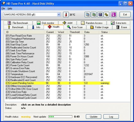

SMART resetted
As u can see smart still shows 122 pending sectors

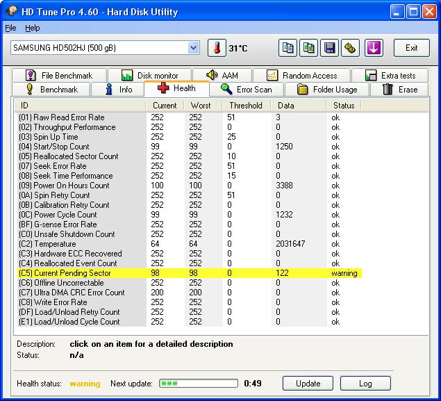

This is the smart status after i have scanned sectors in MHDD for 1 minute.
P.S.
I get error and delay from LBA 0 to around LBA 80.000.000 (i jumped with bottom arrow due to a lot of bas sectors), after LBA 80.000.000 are all good and scan is smooth
