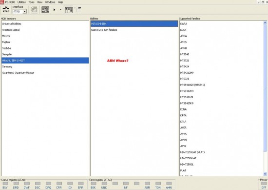

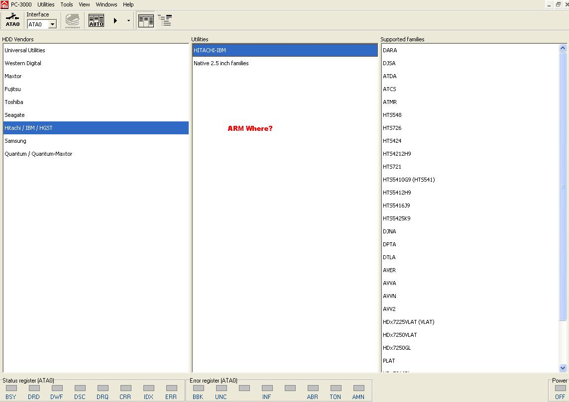

i send you a pic from PC3K
maybe my PC3K is wrong?
Re: Howto Read FW in HITACHI HTS727550A9E364 Via Pc2k
June 25th, 2013, 6:21
hhddrec wrote:Thanks dmarques and mr_spokk;
dmarques wrote:Yep, I also think that's ARM (if I remember well).
With that menu you don't have UDMA..only Pc3000....then you can forget to work with ARM drives.

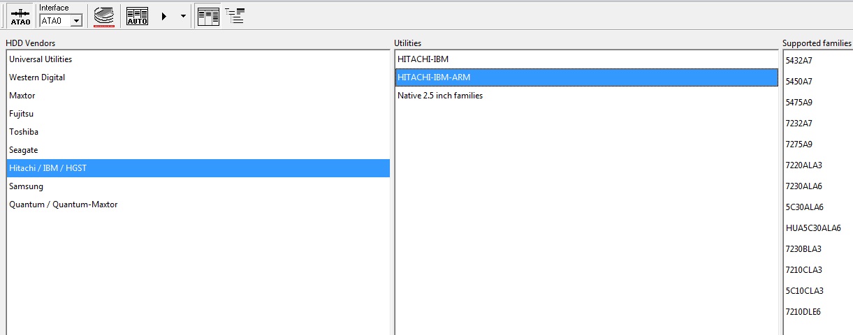

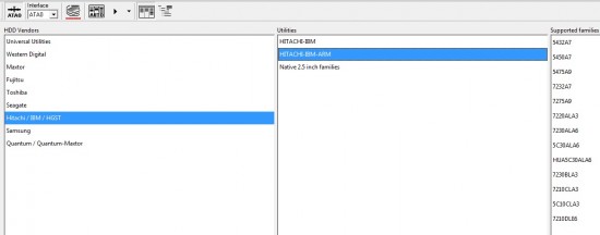

Should look like this:

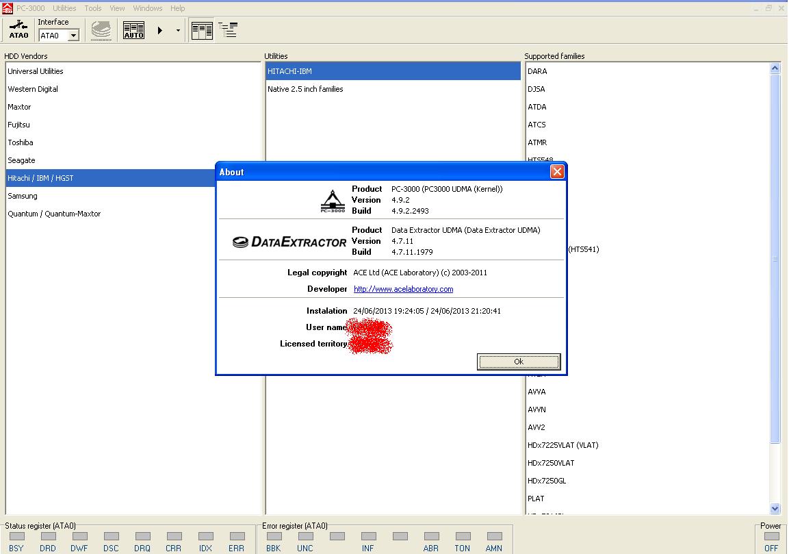

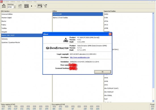

Can you post here the version of PC3K.
June 25th, 2013, 6:55
dmarques wrote:Can you post here the version of PC3K.
Here is:
June 25th, 2013, 7:33
Most possibly this is an outdated UDMA version. When did you update it last? If more than a year ago, then you have old version and you need to update it.
June 25th, 2013, 7:58
5.2.6 is that latest as I know...go to your updatebox and upgrade.
