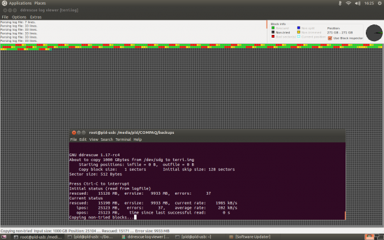

Just performing a data recovery on a WD 1TB 2.5" (WD10JPVT) that came from an enclosure. No noises, no errors (yet!), using GNU ddrescue on Linux to recover [ as per many dozens of drives before this one ], but the thing that struck me as odd is that I'm getting a miserable 10KB/sec, yes, that's incredibly slow and I'm worried the drive will die from read attempts before it gets anywhere.
I've plugged it in to a separate USB3 docking station that I use for most of my recovery processes ( normally see 40~120MB/sec ).
Any ideas what can be the culprit in these situations on the drive causing the tremendous slow down?
The data appears to be legitimate, running photorec on the partial image already pulls out a few valid EXE files that are found on these portable drives by default.

Update: some more data...
I noticed that all communications with the drive are quite slow, even hdparm settings such as trying to adjust the look-ahead feature and power-down timeout.

The drive is dying fast... Needs a new set of you know what.
 Post subject: Re: 10K/sec recovery rate off WD 1TB 2.5", possible cause?
PostPosted: June 18th, 2013, 7:41
Posts: 3550
Might be some head is dirty/weak slowing down the entire process, or Mod32 could need to be fixed, or...

I pulled up the SMART data, also the drive runs quite cool, and it doesn't *sound* like it's doing a lot of repeating seeks. All interactions with the drive are exceedingly slow, even when you're not reading from it (ie, just querying the controller), that's the confusing bit. That said, the SMART seek error rate is absurdly high I suppose :(
As you say Northwind, could be a weak head :(

UPDATE: While I'm waiting to hear back from Eric as per Northwind's suggestion, I was going over the logging data I got from the ddrescue process, and there was a bit of a quirk that I noticed;
The initially start at about 10KB/sec, then after two or three reads, then the next 2~4MB of data would transfer at about ~500K/sec, before falling back to the 10~15KB/sec rate. I can repeat this by cycling ddrescue (terminating the process and restarting). It's not drive sector dependent, it is influenced by the drive read-ahead settings. Initially I thought it was just a buffering / timing miscalculation, but the trouble is that the 4MB of data transferred would occur in a time period quicker than that average overall. It could still just be an artifact of the multiple levels of buffering between the read heads and the ddrescue app, though it does make me ponder.

While I've been discussing matters with Eric, I had the hard-drive on some testing, and it certainly does come up looking very much like a head-failure.
Just thought I'd show what it looks like in ddrescue;

bad head, adaptives, translator etc.
