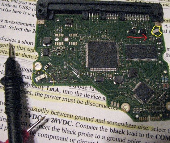

Now, after finding tons of stuff on the net, I am trying to test
the tvs diodes.
I am uploading a picture of my board. It has two shock sensors.
Can you test those?
Here are my results from testing the tvs diodes, the ones with the
red arrow under them. I used two digital voltmeters and one analog
volt meter. I looked on the board but could not tell which side
was the anode or cathode. I will list the results as R(red) lead
to the left side and B(black) lead to the right side of the diode.
B R would be when I switch the leads.
Digital Meter (both digital meters had similar results)
TVS 1 (diode setting) TVS 2
R-B 448 R-B 709
B-R pops up to 1400 then B-R 1 (a few times
goes straight to 1. it would pop to
1800 then go to 1)
Annalog Meter (this is where I get confused bec it's backwards and
I don't know the scale. I did zero the meter.
I have pics drawn but can't duplicate them so I will just give the
numbers and describe the position. If I get this right 0 on this
meter is to the right and the numbers get bigger as it moves to the
left.
TVS 1 @ x10 TVS 2
R-B needle moved up a R-B nada, didn't move
little around 500
B-R moved to four B-R moved to 9
TVS 1 @ x1k TVS 2
R-B shoots up to 10 R-B goes to 10 then drops to
then goes to 20 100
B-R moves to 3 stays B-R goes to 6 and stays
Digial Meter @ 200ohms
TVS 1 TVS 2
R-B 462 pops up then 1 R-B 960 pops up then goes to 1
B-R Stays at 1 B-R moves to 6 and stays
Can someone tell me if either of these are bad? If not what else
can I check. Thanks in advance for your assistance.

I notice that in the lower picture you have circled 2 components in Yellow..... Can I ask you what you think these are?.....

g sensors maybe
At the beginning of my message I state that they are shock sensors and ask if there is a way to test them. Before you go knocking people at least read their message.

Does your PC/PSU power up ok when you have the drive connected to the PC PSU ? If so then TVS are not shorted, as it will prevent the PC PSU from powering anything.
Can you try to insulate the head stack contact (but leave the spindle contact connecting the PCB) using some paper or plastic ? If Pre-Amp is shorted this might also prevent the drive from spinning .....
Initially the drive would not show up in the bios but it would spin up. I listed the commands i tried unfortunately, they are not in any order because i copied them from my 14 pages of notes i pasted from different messages and sites.
Thanks for that, yes the PC/PSU does power up. What is weird is that before i started this it would stop the pc at the bios but it would still have power.
Using a PS with just some fans hooked up and the drive resulted in no failure to get the fans spinning but the drive still did not spin. So is it safe to assume the TVS diodes are okay?
Just tried hooking up a board from another seagate and the drive does spin up but does a continuous clicking whereas with the orginal PCB it does not even spin up.
